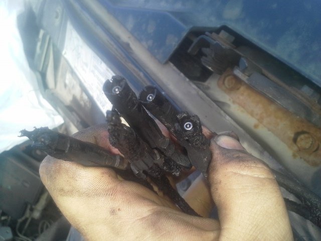

My vehicle has 320,000 km on it and I just replaced the spider injector and upper manifold.
I went to start it after putting everything back and no go, not even a fire. I later decided to try to start it with putting some fuel right into the throttle and it fired right up and ran like a dream after the air intake pipe was put back on. Lots of power and a steady consistent run from the engine. After letting it sit and run for about twenty to thirty minutes I snugged it down to try and fire it up again and no fire again. Does not even give a little bit of a fire just turns over. Any ideas would be appreciated.

I was really hoping it would not be the brand new part I bought that was faulty. I even went with the original design instead of the newer design.
