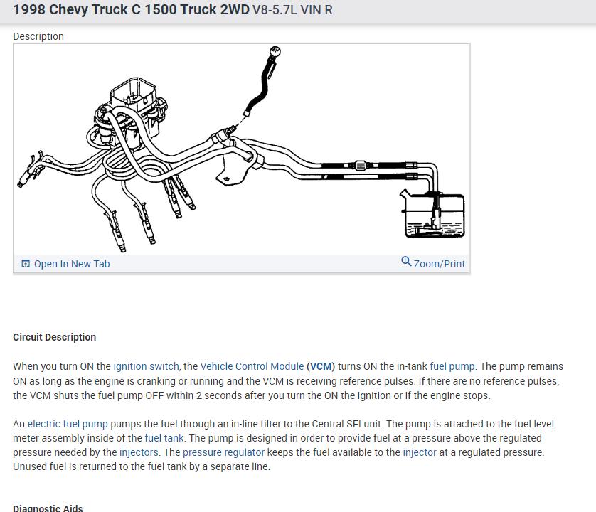

You can follow the fuel line to the injection system. meanwhile I"ll be looking

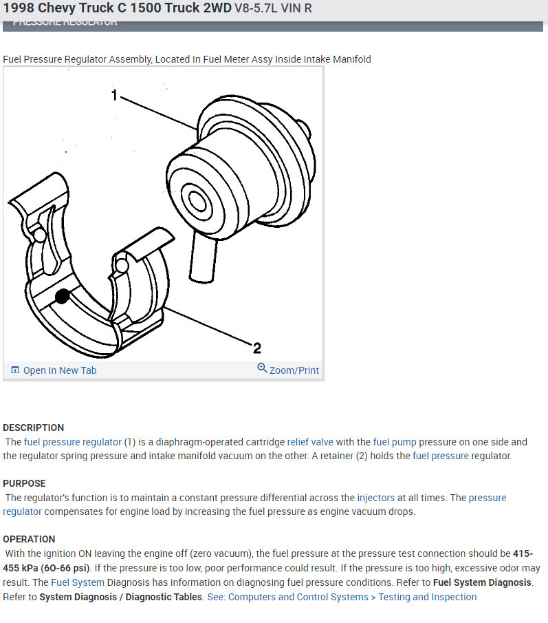

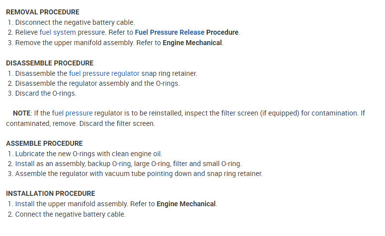

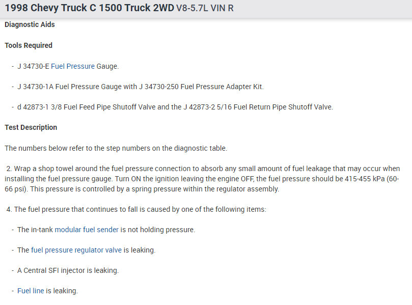

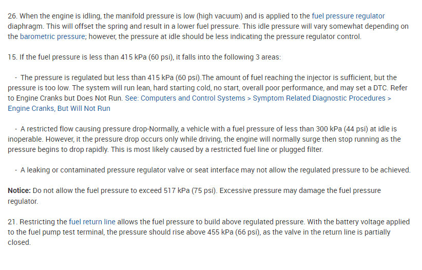

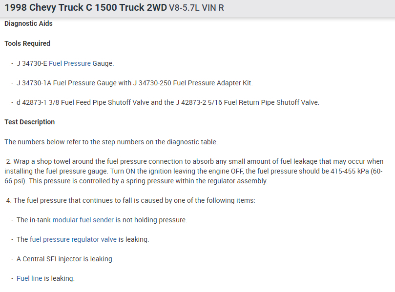

The fuel pressure regulator is located inside the intake manifold for this 1998 Silverado 5.7L.
As mentioned above, this vehicle should have 60-66 PSI of fuel pressure with the key on and engine off.
Here is a helpful video of how to check fuel pressure:
https://youtu.be/aITQclp7zIE
I have included the fuel pressure test port location as well as the pressure testing procedure for your reference.
Oct 4, 2021 at 1:54 PM
Suggested Repair
Confirm the fuel pump runs with the key on and while cranking. On this 1998 Silverado 5.7L SFI, the fuel pressure regulator is inside the intake manifold. Follow the fuel line to the injection system to locate the Schrader/test port, then check pressure with the key on and engine off; it should be 60-66 psi.
