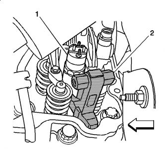

BRIAN 1
  • 1,030 POSTS
Remove the lower valve coverRemove the fuel injector return line from fuel injectors.
Remove the bolt from the fuel injector bracket.
Remove the fuel injector(s).
Remove the copper compression washer from the injector hole if the washer was not removed with the injector,you also need a special tool to remove the injector(s).it may sound easy but there not.without the special tool to remove the inj you will break the inj.doing these injectors are NO FUN!alot of work remving the lower v/c.

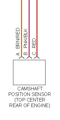

JDL
  • 16,098 POSTS
When you try to start, is the security lite on? If so, leave the key in the on position, it will return to on from crank. Watch the security lite, it should go off in about 10 minutes. If the lite does go out, turn the key to off for 5 seconds, then try to start.
At the moment, I don't think your cam sensor is the problem? It should be located at rear center of engine. The wire colors at the connector are in the diagram.

RECOSERVICE
how to replace injectors
Aug 21, 2020 at 9:39 AM (Merged)
BRIAN 1
  • 1,030 POSTS
these suck to do,you have to remove both valve covers and the fuel rails.the injectors are down in the head,you need a special tool to remove the injectors or you cant remove them. and you have to clean the injector bore and each fuel line,they get deposits of rust that has to be cleaned.this is the tool you will need,
https://images.2carpros.com/forum/automotive_pictures/147643_injector_1.jpg
post back with any other questions.

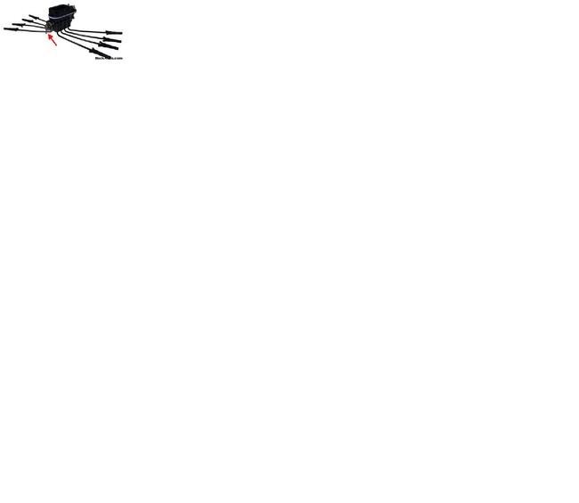

COREYLEO
  • 9 POSTS
I replaced the junkie stock spider injectors and now it won't start.. It's filling cylinder 7 with to much gas it hydro locks.. Also had a lot of gas in the oil what is causing it.. Can it be fixed of is it finally time to replace the engine?
Aug 21, 2020 at 9:41 AM (Merged)
CARADIODOC
  • 34,321 POSTS
Pull the vacuum hose off the fuel pressure regulator and check if it's wet inside. If it is, the regulator is leaking fuel into the intake manifold and needs to be replaced.
COREYLEO
  • 9 POSTS
One problem the fuel pressure regulator is attached to the spider injector unit under the upper intake manifold and when it was replaced there was no hose connected to it!
CARADIODOC
  • 34,321 POSTS
Here's a photo from Rock Auto. The red arrow is pointing to the hose connection on the regulator.
