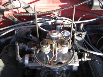

TOPFUEL
  • 5 POSTS
Electrical problem V8 Two Wheel Drive Automatic 216k miles
Hi, yesterday my truck would not start. I am getting spark, but no fuel is spraying from the injectors. I removed the fuel line feeding the TBI to check and see if fuel was reaching it, and it is. Not a lot of pressure but it is getting fuel. The TBI is a brand new Holley 670cfm that was working flawlessly up until the no start. The engine has been rebuilt but no problems to speak of until this. Fuel pump is the original so maybe its time to be replaced? Checked the fuses I could find in my diagram and they are all good, wiring looks sound going to the TBI and injectors. Just don't know why the injectors aren't spraying any fuel after trying to start multiple times.
Thanks in advance!
Aug 21, 2020 at 2:47 AM (Merged)

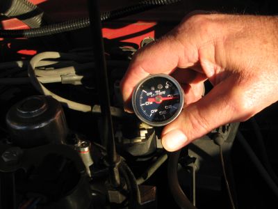

TOPFUEL
  • 5 POSTS
Checked fuel pressure to TBI, its sitting at 13 There is power going to the injectors, what else would cause this problem?
https://images.2carpros.com/forum/automotive_pictures/278243_IMG_0920_1.jpg
https://images.2carpros.com/forum/automotive_pictures/278243_IMG_0919_1.jpg
psi.

  • 75,988 POSTS
If it has to do w/the security system it won't last a week. Hook up a noid light to the injector and see what happens-if its not blinking its not pulsing could be the computer ground drivers -or the computer is missing an ignition reference signal from the cam/crankshaft sensors therefore not synchronizing the injectors.

TOPFUEL
  • 5 POSTS
Hi again, tested injectors with a light and its not blinking at all on either injector. Checked for codes and its showing code 12 (No Problems detected). So I replaced the ECM and the truck started it was bad. Thanks for your help
