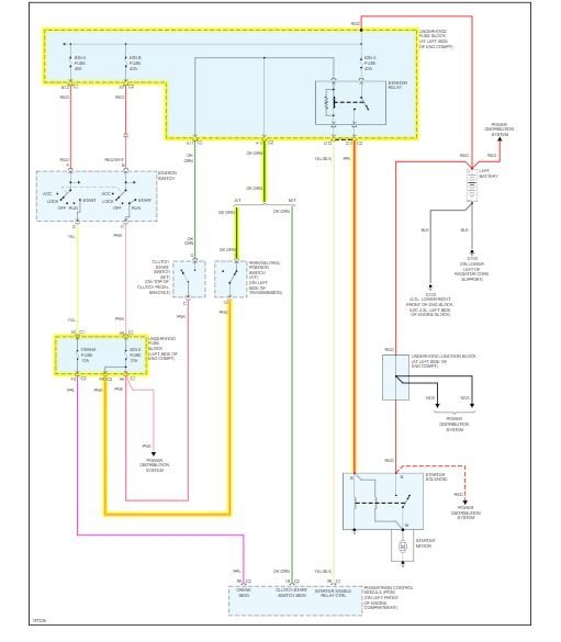

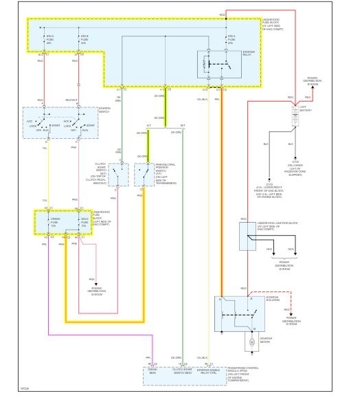

BRYTANNYMICHELE
  • 2004 CHEVROLET SILVERADO
  • 6.0L
  • V8
  • 4WD
  • 200,000 MILES
Replaced battery and had starter checked and it's good. Have power to starter but not to solenoid. Any ideas?
Tuesday, July 21st, 2020 AT 2:44 PM (Merged)
  • 52,797 POSTS
Good afternoon,
I attached the wiring diagram for the starting for the truck.
Does the security light go out with the light on after about 10 seconds?
Did you try it in neutral?

JIS001
  • 3,411 POSTS
Hello and welcome to 2CarPros. Just wanted to jump in and state there is a bulletin for a faulty ignition switch. Here is the bulletin:
Collision
 49
2004 Chevy Truck Silverado 2500 4WD
Â
V8-6.0L VIN U
Â
Â
Ignition Switch - Intermittent No Crank/Dead Battery
Vehicle Starting and Charging Technical Service Bulletins Ignition Switch - Intermittent No Crank/Dead Battery
IGNITION SWITCH - INTERMITTENT NO CRANK/DEAD BATTERY
Bulletin No: 04-06-03-002
Date: February 05, 2004
INFORMATION
Subject:
Diagnostic Information for Intermittent Vehicle No Crank/Dead Battery
Models:
2004 Buick Rainier
2000-2004 Cadillac Escalade
2002-2004 Cadillac Escalade EXT
2003-2004 Cadillac Escalade ESV
1998-2004 Chevrolet Blazer, S-10 Pickup
1999-2004 Chevrolet Silverado
2000-2004 Chevrolet Suburban, Tahoe
2002-2004 Chevrolet Avalanche, TrailBlazer, TrailBlazer EXT
2003-2004 Chevrolet Express
1998-2004 GMC Jimmy/Envoy, Sonoma
1999-2004 GMC Sierra
2000-2004 GMC Yukon, Yukon XL
2002-2004 GMC Envoy, Envoy XL
2003-2004 GMC Savana
2004 GMC Envoy XUV
1998-2004 Oldsmobile Bravada
2003-2004 HUMMER H2
When diagnosing a concern regarding an intermittent vehicle no crank or dead battery, technicians should remove and reinstall the ignition switch using the Ignition Switch Replacement procedure in the Steering Wheel and Column section of SI. The ignition switch may have been misindexed in the steering column during a previous replacement.
If the ignition switch is misindexed in one direction, the ignition switch circuits will not be completely open when the ignition switch is in the OFF position with the key removed. This may result in lights remaining on or instrument panel lights illuminating, which will drain the battery. If the ignition switch is misindexed in the opposite direction, the ignition circuits will open correctly but the ignition switch may not close the crank circuit properly when the ignition key is turned to the crank position. This will result in a no crank concern.
Since you have no power to the solenoid then the ignition switch is not properly indexed to have power to the solenoid. Replace the switch first or call GM for a goodwill and let us know if this was the issue.
