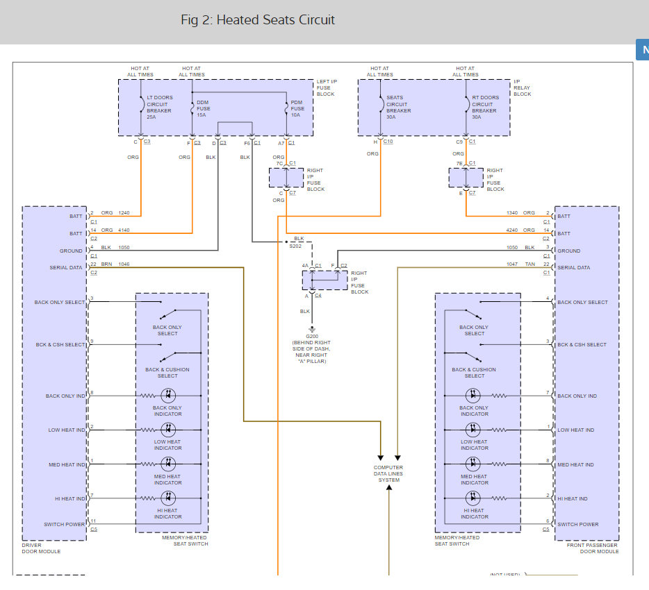

I left my truck outside at the airport all last week and when I came back, nothing electrical in the driver's door worked. I had to unlock it with the key although two clicks on the remote unlocked the other doors. The power mirrors, windows, locks, seat heaters and dome light were inoperative from the driver's door. About 10 minutes into the drive home, I noticed it all started working again (door switch illumination came on). I stopped for dinner and came out 45 minutes later to find nothing worked again. Three days later, still nothing works. I don't have a wiring schematic to see where the ground is located, or if these accessories run through a multiplexer, or know where to begin. Any help would be appreciated.

Welcome to the forum. There should be a left door circuit breaker in the lt i/p fuse box, use testlite, one of those legs should be hot all the time.

Orange wire from that circuit breaker carries voltage to the driver door module, inside the door. On some makes and models, I have accessed the wiring at the front side of door, where the wiring harness goes in. Maybe you can access the circuits on the backside of window switch?

Makes sense. Is there a multiplexer or control module for everything in the door? I have power to the switch, but nothing works - mirror, seat heat, switch illumination, windows, power locks, door light or dome light when door is open. The other windows open from their respective doors, power locks work on other 3 doors from the fob and dome lights work from the other 3 doors too.

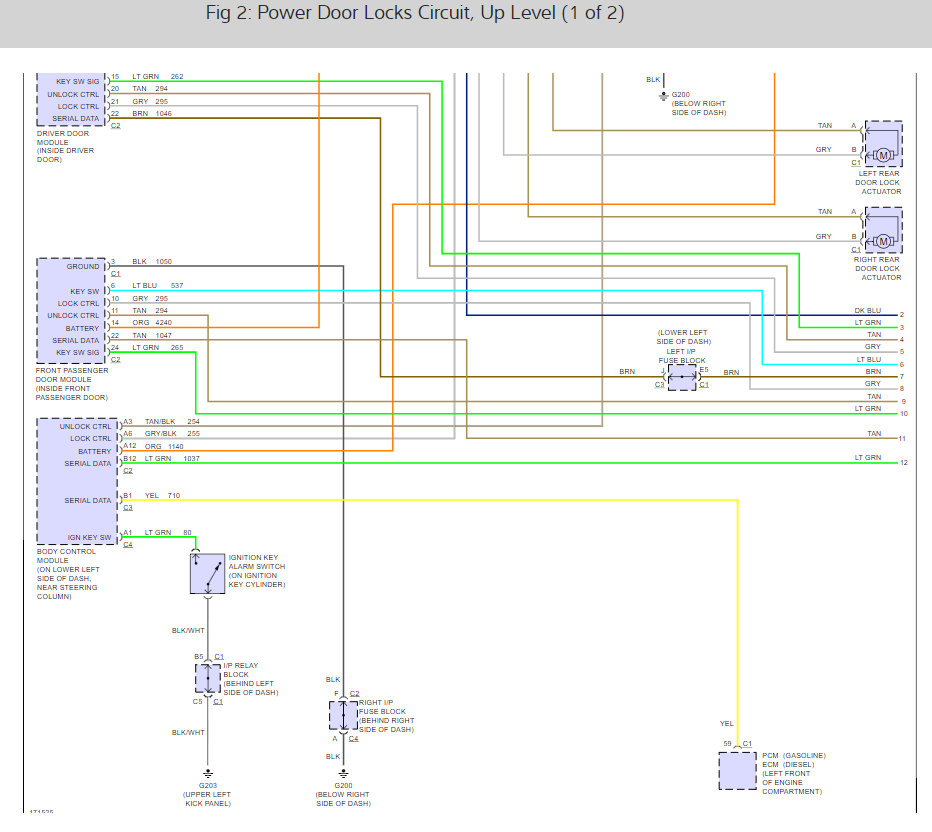

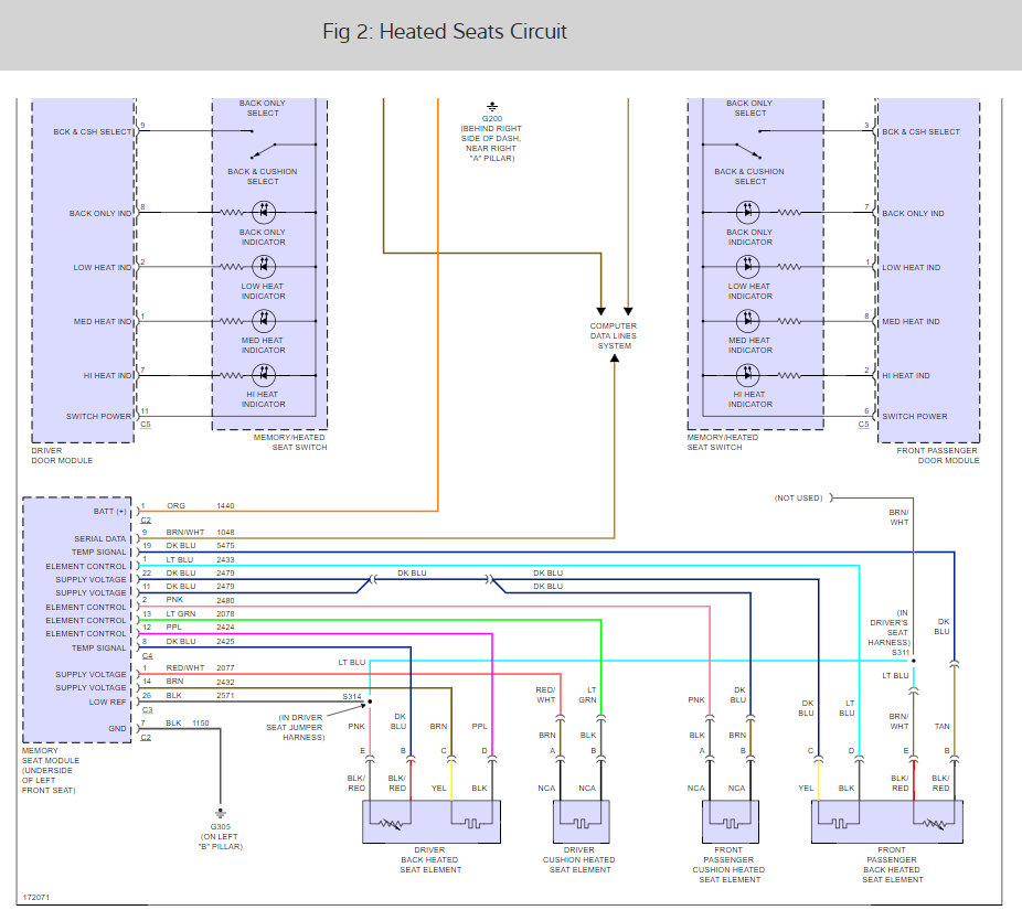

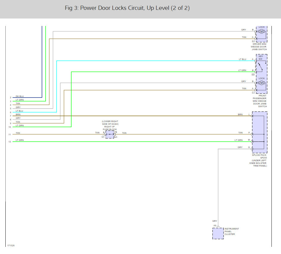

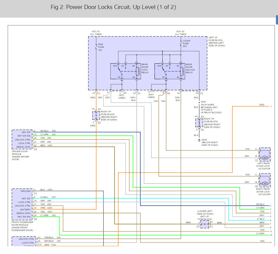

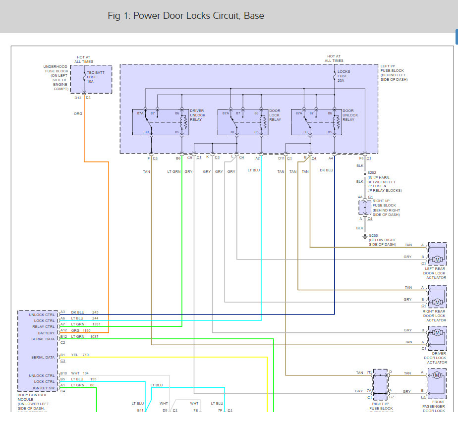

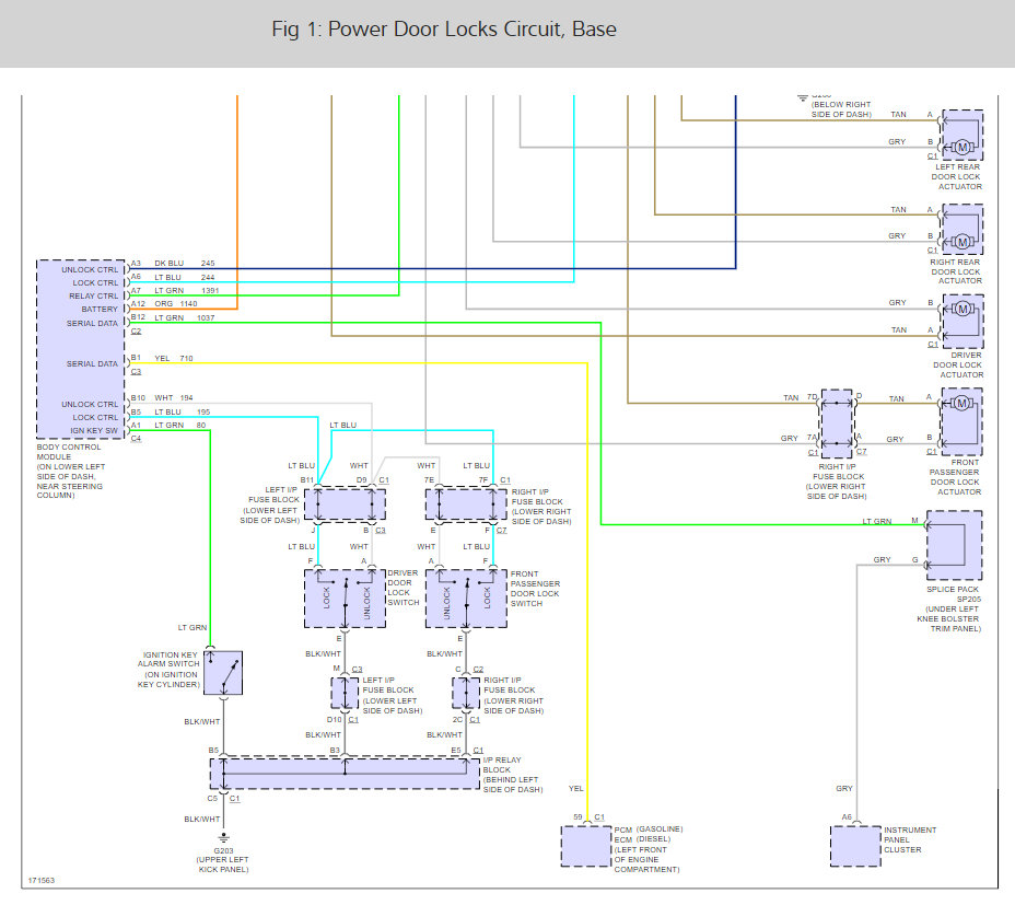

There is the driver door module that goes out in these cars, here is a full wiring diagrams for the door module and locks.
Cheers
Sep 29, 2009 at 4:57 AM
SAMBAL BADJAK
  • 20 POSTS
Yep I replaced the drivers door module and it fixed the problem you guys are great!

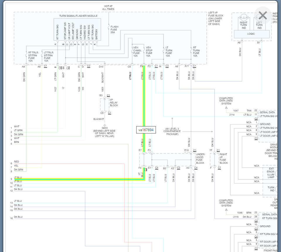

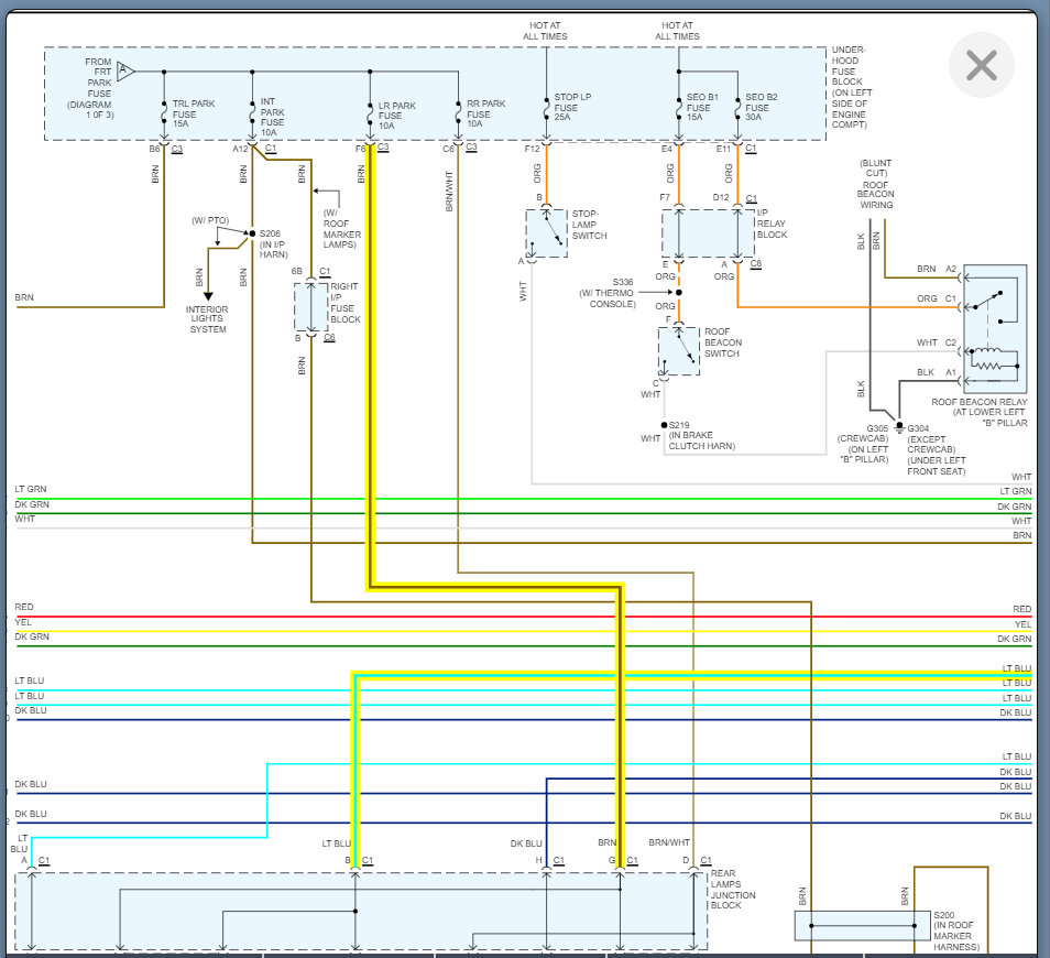

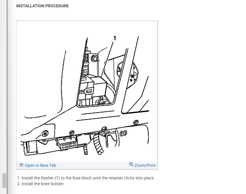

I have a 2003 Chevy Silverado and I hooked up one of the LED light strips under the tailgate blinker, brake and reverse in one. I went to turn on everything and my blinker was on like the flashers then hit the brakes the right brake light doesn't come on that's on auto. Turn the light on manually right blinker doesn't work same with no right brake light turn everything off but turn your ignition to on I have no brake lights, but I have blinkers. Now getting to my driver's door has no power, but I can operate the passenger door from the driver's. Now the PDM fuse is in the same fuse block as the brake, and the blinkers and it keeps blowing the fuses put in instantly. Did I fry that whole fuse block under the dash?
Dec 28, 2021 at 4:31 PM
MCOLA77
I took that LED light strip out and didn't change a thing either.
Dec 28, 2021 at 10:39 PM

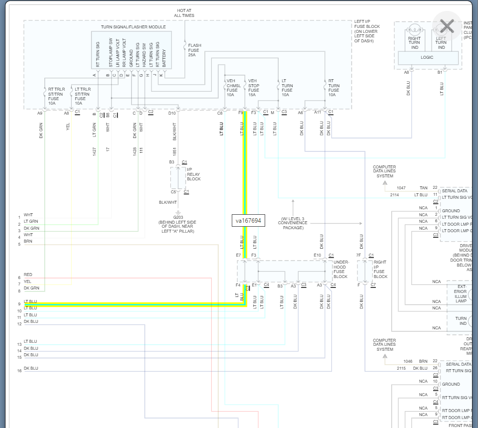

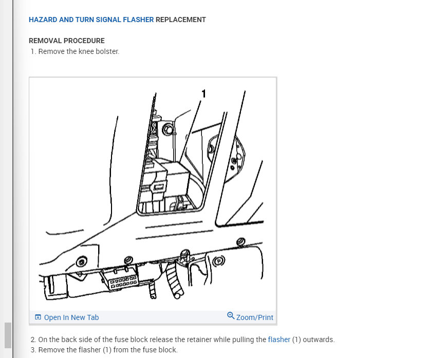

You definitely have a short and based on the fact that all you did was install this LED strip then I suspect that is the case.
In fact, you have a flasher module within the left IP fuse box that is most likely the issue.
Basically, we need to remove the fuse and test for a short.
I am attaching the wiring diagram that will show this the detail needed.
Let's run through this and confirm where the short is and we can go from there.
Another way to eliminate everything but the fuse block is to just disconnect the connectors and check for the short to ground.
Let me know if you have questions on this.
Thanks
Dec 29, 2021 at 5:14 AM
MCOLA77

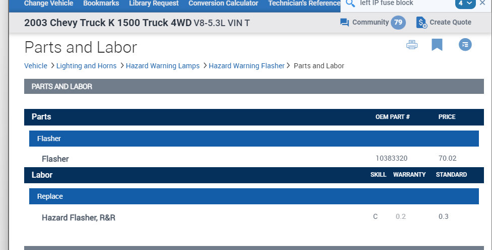

I opened up that whole wiring harness following both light blue and both dark blue wires for the brake lights and blinkers. The problem is between both fuse blocks. Are you talking about that big lo g flasher relay that's $75.00, lol. I bought one of them already too l ever took apart the fuse block under the dash to see if anything was burnt it looked good.
Dec 29, 2021 at 4:48 PM
Just to be sure we are on the same page, but it sounds like we are, I am attaching the info below on this flasher module.
However even if you replaced that and traced the wires, we are still dealing with a short. Anytime a fuse blows as soon as you put it in, we have a short to ground prior to the load in the circuit. Basically, we need the load (light bulb, module, actuator, or whatever is getting powered) to use the voltage so that the current is used as well. If we don't then the current racing through the wire creates heat and that will melt the wiring or blow the fuse.
So, I understand you inspected the wiring but let's check it for a short to ground with a meter or test light and that will tell us for sure. Or you can just run a new jumper wire and see if the fuse stops blowing. Sometimes you cannot see the pinched wire, so it is missed.
