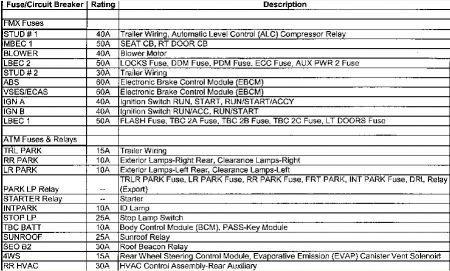

The passenger door locks and window controls in my Silverado have stopped operating. At the same time, my keyless entry stopped working. I would have thought this coincidental, but have found similar complaints online. I have tried checking for a blown fuse, but cannot determine which fuse/ relay might be at fault. I cannot decipher the acronyms on the diagrams.
Jan 15, 2009 at 3:56 AM
BLUELIGHTNIN6
  • 16,542 POSTS

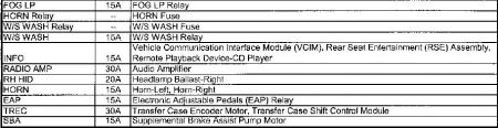

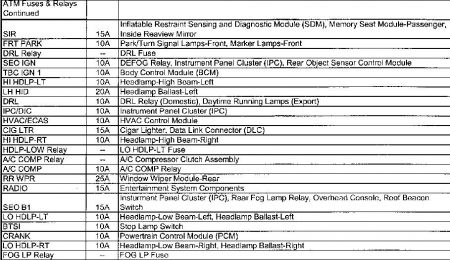

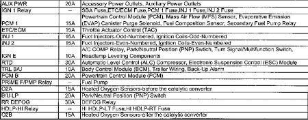

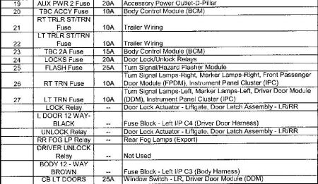

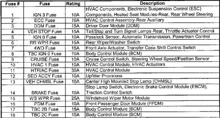

Hello Thanks for the donation. I have the fuse acronyms listed below for you. Post the results of the fuse/relay inspection and I will follow up. Below is the legend for your fuses in interior fuse panel.
https://images.2carpros.com/forum/automotive_pictures/261618_Noname_139.jpg
https://images.2carpros.com/forum/automotive_pictures/261618_Noname2_46.jpg
Below is the legend for under hood power distribution center.
https://images.2carpros.com/forum/automotive_pictures/261618_Noname_140.jpg
https://images.2carpros.com/forum/automotive_pictures/261618_Noname2_47.jpg
https://images.2carpros.com/forum/automotive_pictures/261618_Noname_141.jpg
https://images.2carpros.com/forum/automotive_pictures/261618_Noname2_48.jpg
