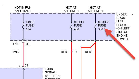

I cannot get power to the constant hot wire to my 7 way in the rear plug. Is the stud #1 supposed to have the 40 amp fuse. I have all of the turn and stop lights working at the plug and all of the other fuses seem to be good. I have a separate trailer brake control unit wired and plugged in under the dash and have used trailer with electric brake with no problems. I just wonder why I don't have the constant power to the rear plug.
Monday, May 22nd, 2017 AT 12:30 PM (Merged)
HMAC300
  • 48,601 POSTS
Yes stud one is the hot wire for the trailer connector it should have a 40 amp fuse and go to position E in the connector at back

I have an appropriate seven blade trailer plug. All functions work except the auxiliary power feed. But I cannot find where the auxiliary power feed wire gets its power from.
HMAC300
  • 48,601 POSTS
It gets it from stud #2 on fuse block under hood see picture. It is a red wire on plug in.
