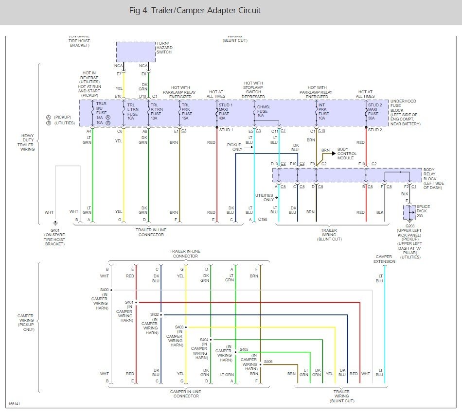

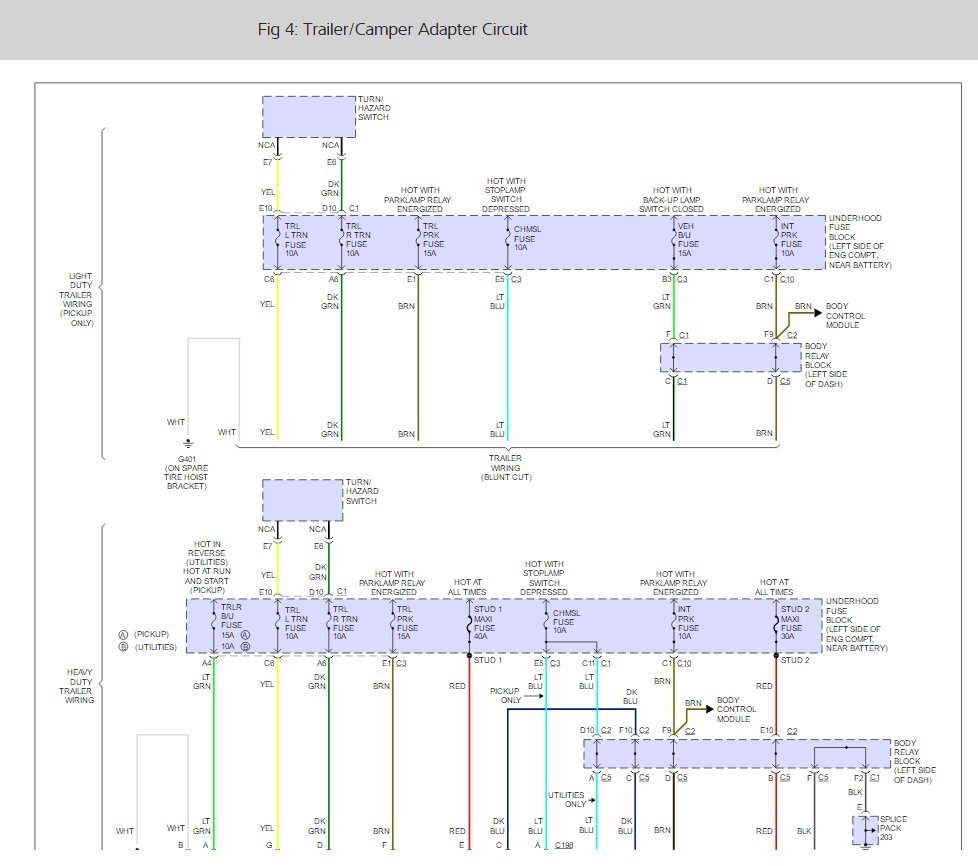

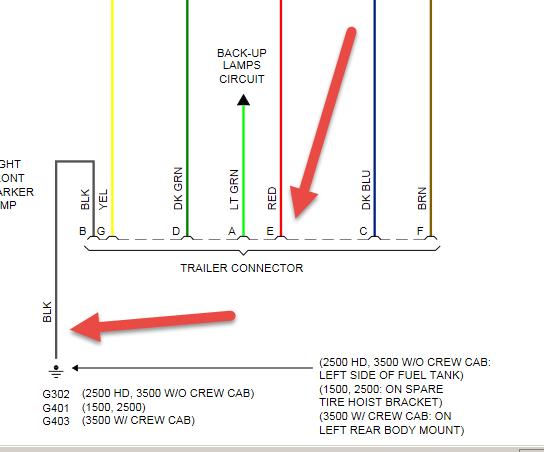

I have a friend with a chevy truck and his trailer light plug has quit working. It was working then when they went on a trip last week it start to have intermittent problems now does not work at all. When I checked it out there was no power to any of the 3 fuses for the trailer plug. None of the schematics I've found have offered anything new. Wiring schematics and will help eliminate checking areas that are effected from whats causing the problem but I guess I wasn't quite clear, none of the fuses for the trailer plug in the fuse block have any power to them. This is the fuse block under the hood, there is no power to the fuses.
Aug 3, 2010 at 1:50 PM
  • 55,433 POSTS
I have found the wiring diagrams (BELOW) for the trailer. Here is a guide to help you troubleshoot the problem.
If the fuse does not have power to it then it has to be a wiring issue because power comes from the battery to the fuse box. If surrounding fuses have power than the box itself is probably not at fault, although this does not eliminate that possibility completely. You will need to inspect the wiring going to the box and right under the box where they all connect. If the wiring is good then a swap of the fuse box with known good one will need to be made.
Please let us know if you need anything else to get the problem fixed. (BELOW)

RHALL77
  • 3,361 POSTS
here is the wiring diagram for the trailer lights, there is a better diagram above in Kens post!!!!

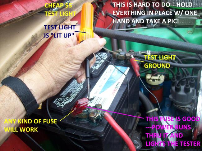

CJ MEDEVAC II
  • 222 POSTS
SOUNDS LIKE A PROBLEM WITH THE CHEVY
USE A 12 VOLT TEST LIGHT--GROUND IT REAL WELL NEAR THE PIG TAIL
HERE'S WHAT YOU SHOULD GET
BROWN WIRE PIN---STEADY TEST LIGHT
GREEN WIRE PIN--RIGHT TURN --BLINKING TEST LIGHT (IF YOU TURN OFF THE TURN SIGNAL, APPLY BRAKES AND GET A STEADY TEST LIGHT)
YELLOW WIRE PIN--LEFT TURN--BLINKING TEST LIGHT (IF YOU TURN OFF THE TURN SIGNAL, APPLY BRAKES AND GET A STEADY TEST LIGHT)
WHITE WIRE--IS THE GROUND--IT NEEDS TO BE GROUNDED ON THE VEHICLE AND NOT DEPEND ON THE TOW BALL AS A GROUND FOR THE TRAILER
THINGS TO REMEMBER---THE TRAILER HAS 2 FILAMENTS IN THE BULBS, ONE WILL "BURN" (RUNNING LIGHTS) THE OTHER WILL BE REALLY BRIGHT (THIS WOULD BE THE TURN SIGNALS/ BRAKE LIGHT FILAMENT)
SO MANY PEOPLE WILL HOOK UP THEIR LIGHTS SO THAT THE RUNNING LIGHTS AND TURN/ BRAKES ARE REVERSED
THE TURN AND BRAKES ARE NOW DIM, AND THE RUNNING LIGHTS ARE BRIGHT - EVEN ONE SIDE OF THE TRAILER IS CORRECT AND THE OTHER SIDE IS WRONG
MUCH OF THE TIME YOU HAVE A GROUNDING PROBLEM, THIS MAKES CORRECTLY HOOKED UP LIGHTS "SEEK GROUND" WHEREVER IT CAN (THRU THE OTHER WIRE) LIGHTS MAY BLINK DIM, EVEN BOTH FILAMENTS WILL BLINK)
I HAVE MADE SEVERAL REALLY LONG ALLIGATOR CLIP JUMPER WIRES
WHEN I TEST,I GROUND TO THE BATTERY NEGATIVE POST (A GROUND DON'T GET NO BETTER'N THAT!
I REMOVE THE LENSES AND CONNECT (OR TOUCH) MY JUMPER TO THE PLATE INSIDE THE LIGHT FIXTURE. IF THIS WORKS WELL, EITHER MY LIGHT'S GROUND IS RUSTY, OR THE GROUND FROM THE TOW VEHICLE IS BAD
REMOVE THE BULBS, LOOK INTO THE BOTTOM OF THE SOCKETS, IS THE CONNECTION THERE? IS IT MELTED? HAS ONE OF THE PINS SUCKED BACK UP INSIDE THE SPRING LOADED BOTTOM?
HAS SOMEONE INSTALLED INCORRECT BULBS? LAST ONE I DEALT WITH, SOMEONE INSTALLED, RATHER "CRAMMED" "1156" (SINGLE FILAMENT) BULBS IN INSTEAD OF "1157" DUAL FILAMENT BULBS

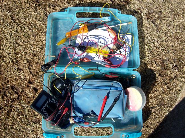

SENDING A PIC OF MY TEST LIGHT IN ACTION (ANOTHER KINDA USE FOR IT) A VOLT METER WILL WORK IF YOU HAVE ONE
KEEP US POSTED ON PROGRESS
THE MEDIC

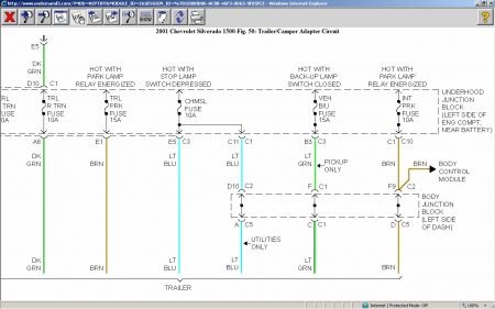

VIC GAIGALS
Electrical problem
2001 Chevy Silverado V8 Four Wheel Drive Automatic 64233 miles

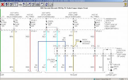

the trailer connector on the truck came from the factory. i tested the continuity on plug ok.the brown wire that says on outside cover says running light the shop manual ligthing system 8-321 shows it going to a trailer park inline fuse.all the fuses in the fuse box are ok. the brown wire has always been dead. is there a inline fuse and where or how can i fix it without giving GM a blank check to fix it
May 22, 2017 at 5:29 AM (Merged)
MERLIN2021
  • 17,250 POSTS
That brown wire is only "hot" with the park lamp relay enegized. Top picture is light duty hitch, bottom is heavy duty.
https://images.2carpros.com/forum/automotive_pictures/62217_trailera_1.jpg
https://images.2carpros.com/forum/automotive_pictures/62217_trailerb_1.jpg
VIC GAIGALS
thank you well done.... it looked like there was a in line fuse looking under truck....thank you again

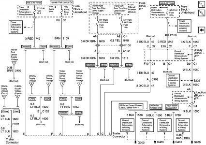

I had a brake connector wired into the bed for a 5th wheel. When I bought the truck the factory 7-pin on the bumper was corroded so I bought a new one. When the shop wired the connectors now when I press on the brakes my left marker lights come on but the brake controller isn't sending power to my trailer brakes. I'm not sure which wire is ran wrong?
May 22, 2017 at 5:30 AM (Merged)
HMAC300
  • 48,601 POSTS
see pic red is hot wire and make sure you have a good ground. yellow is lh t/s and dk green rh t/s brown is tailights
DAVIDSLUSHERMCGMAILCOM
The diagram says W/O crew cab. Mine is a crew cab. Does it make a difference? Thanks
HMAC300
  • 48,601 POSTS
is it a 2500 or 3500 you didn't say. besides that is only the ground that they are talking about not the connector
