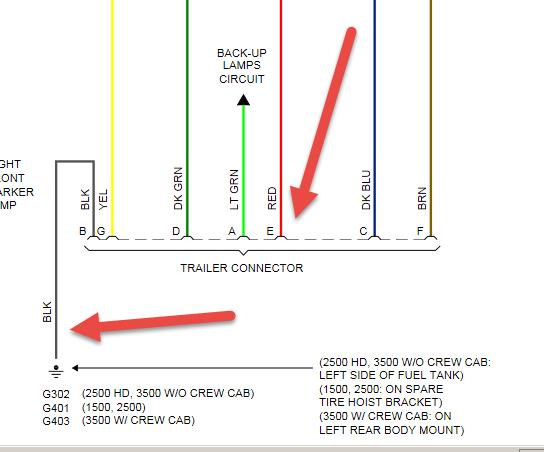

I cannot get power to the constant hot wire to my 7 way in the rear plug. Is the stud #1 supposed to have the 40 amp fuse. I have all of the turn and stop lights working at the plug and all of the other fuses seem to be good. I have a separate trailer brake control unit wired and plugged in under the dash and have used trailer with electric brake with no problems. I just wonder why i don't have the constant power to the rear plug.
May 22, 2017 at 5:30 AM
(Merged)

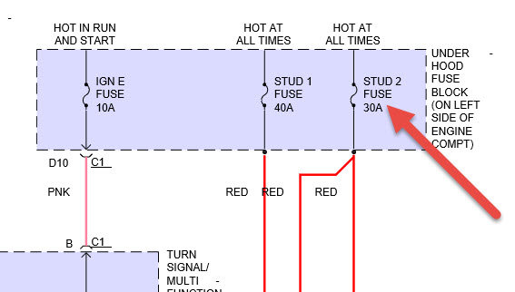

yes stud one is the hot wire for the trailer connector it should have a 40 amp fuse and go to position E in the connector at back

I have an appropriate seven blade trailer plug . all functions work except the auxiliary power feed. but I cannot find where the auxiliary power feed wire gets its power from.

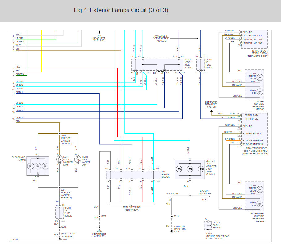

This wiring is at the rear of the vehicle? I have some tables of circuit description, It would be advised to verify with a test lamp before assuming the circuits are what is listed.
Service Information
2000 Chevrolet Chevy C Silverado - 2WD | Sierra, Silverado, Suburban, Tahoe, Yukon (VIN C/K) Service Manual | Body and Accessories | Body Rear End | Schematic and Routing Diagrams | Document ID: 521639
Trailer/Brake Controller Wiring Information
Table 1: Individual Conductors
Table 2: Individual Conductors
Trailer Wiring
Important: The trailer harness and fuses must be connected to the engine wiring harness junction block. The trailer harness circuits are identified in the following table. Please take note of the maximum current ratings of the circuits.
Stop lamps and turn signal lamps are similar to the description in Exterior Lights Circuit Description, with the exception of the following conditions:
• From the stoplamp switch, voltage is supplied to the turn/hazard switch on CKT 17 (WHT).
• From the turn/hazard switch, voltage is supplied to the TRL L Turn or the TRL R Turn fuse on CKT 18 (YEL) or CKT 19 (DK GRN).
• From the fuse, voltage is supplied to the trailer connector

The brake controller pigtail and 40A B+ trailering MaxiFuse has been provided with the HD trailering option.
Plug in the 6 Way connector into the body wiring harness junction block which is located on the upper left of the drivers footwell.
Plug-in the 40Amp B+ trailering MaxiFuse in stud #1 location of engine wiring harness junction block.

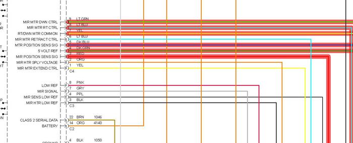

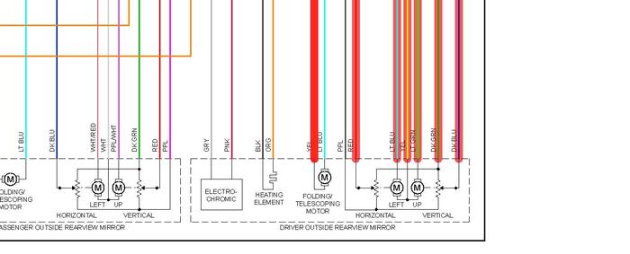

What do the five colored wires do in a electrical mirror. Trying to figure out what five wires do so I can wire 2003 extended trailer mirrors in there place m

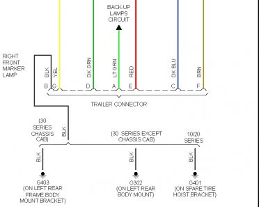

Electrical problem
2003 Chevy Silverado V8 Two Wheel Drive Automatic 84000 miles
What is the wiring schematic for the rear 7 pin factory plug?
Jun 5, 2017 at 10:08 AM
(Merged)
My info shows this.

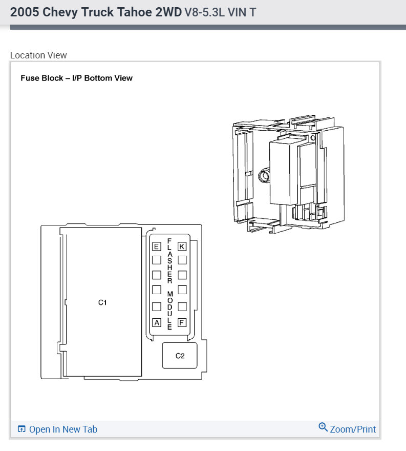

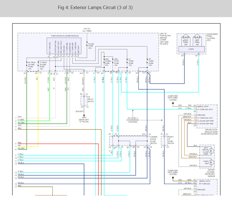

Hey all, I know this thread is old but I am having the same problem multiple of you have mentioned here. When I turn on the right turn signal, both turn signals on the trailer blink. When I step on the brakes only the right brake works. The left blinker works with no issues. Running lights all good. Anyone ever fix this problem? I replaced the female connector on the truck and it still does the same thing. I have tried multiple trailers and it does the same.
Any help? Thanks
Any help? Thanks
Jul 7, 2019 at 11:04 AM
I should add this is on a 2005 Tahoe
Jul 7, 2019 at 11:41 AM
The lights on the truck always work normally with or without the trailer plugged in. The trailer works normal on all other vehicles but mine. When I took part the 7 prong female plug on the truck side, it is sending a signal for the left and right blinker (or hazard lights?) when I turn on the right blinker. The left blinker operates normally on the trailer when I signal left on the truck.
Jul 8, 2019 at 3:09 PM
It sounds like the trailer wiring or the truck plug wiring is the issue. Here is the trailer wiring so you can check the power output:
Check out the diagrams (below). Please let us know what you find.
