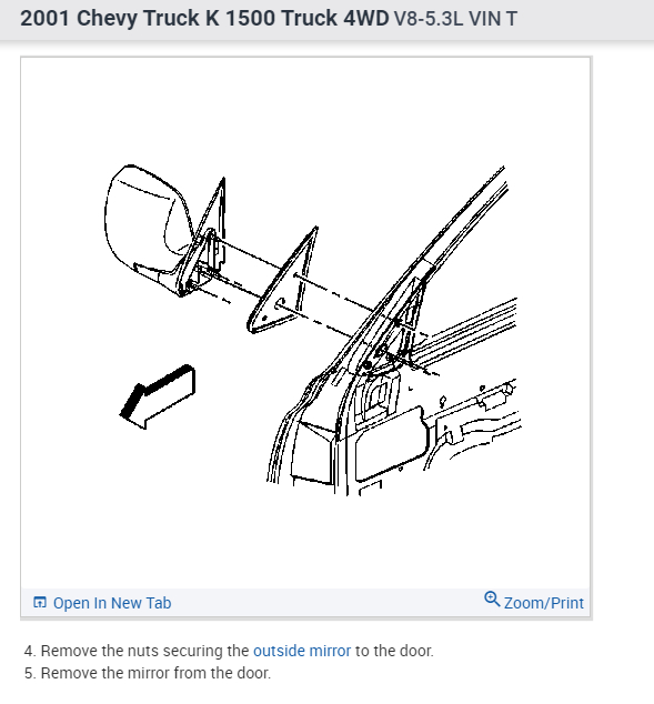

How do I upgrade my non-power mirrors to power mirrors?
DAVISSHOOTER
  • 2001 CHEVROLET SILVERADO
  • V8
  • 4WD
  • 57,000 MILES
Wednesday, October 27th, 2010 AT 12:26 PM
SQM
  • 6,383 POSTS
This will require first getting the power mirrors, switches, wiring and fuse/relay setup to accomplish.
There are few aftermarket companies that offer power mirror conversion kits. Which will include all the basics.
Keep in mind that those conversions are universal setup, and the switches and other components will not be same as factory and may require some modifications to work.
Summit Racing does offer some of these conversion kits.
https://www.summitracing.com/search/product-line/street-scene-street-smart-electric-mirror-conversion-kits/part-type/side-view-mirrors/year/2001/make/chevrolet/model/silverado-1500?fr=part-type
