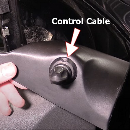

There will be electrical wires or a control cable which adjusts the mirror position inside the mirror's housing, here is what it looks like in this case.
mirror control cable knob

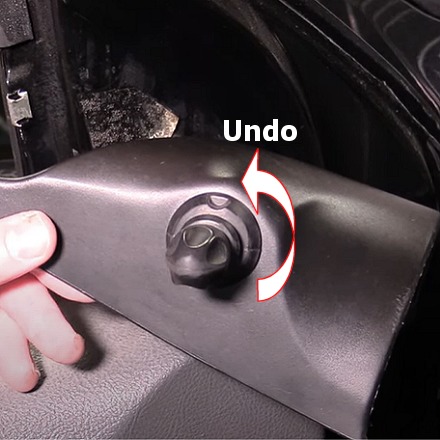

Remove the cable by twisting the retainer counterclockwise, this can be done by hand or you might need a pair of pliers to help.
mirror control cable knob undo
