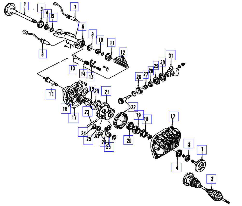

Transfer case shifts and front drive shaft will turn. Replaced actuator it is working when lever on floor is moved to 4 high. Jacked up right front wheel removed actuator pushed lever with wooden dowel turned wheel front drive shaft never turned and unit did not lock in.
Wednesday, September 2nd, 2020 AT 10:53 AM (Merged)
KEN L
  • MASTER CERTIFIED MECHANIC
  • 48,363 POSTS

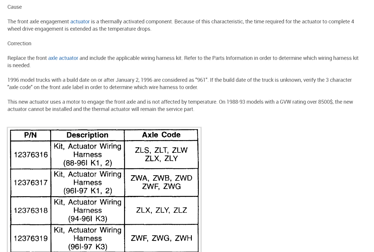

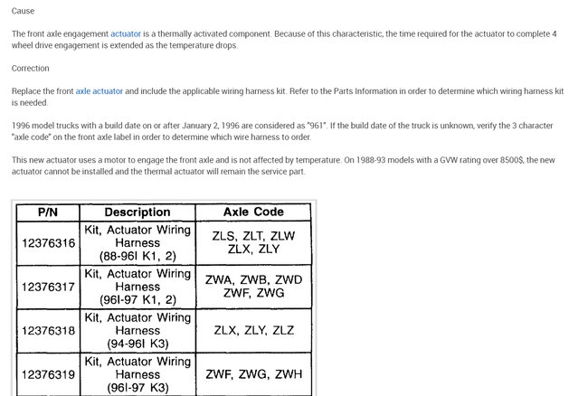

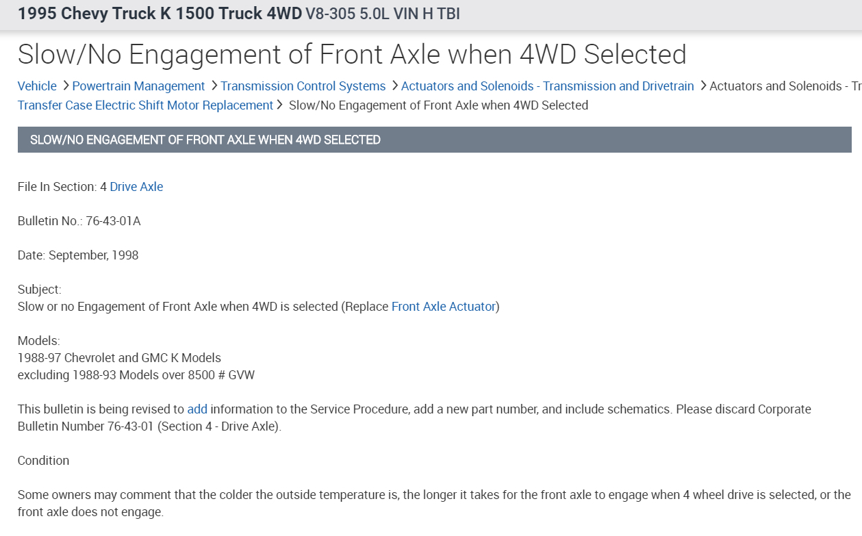

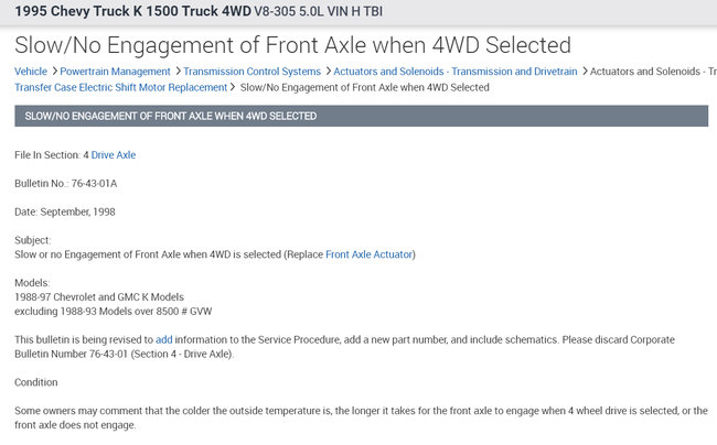

It sounds like the fork inside the front differential is having an issue or the actuator is not working fully. Here is a bulletin this problem with an exploded diagrams of the front differential so you can see how it works. Check out the diagrams (below). Please let us know what you find. We are interested to see what it is.
