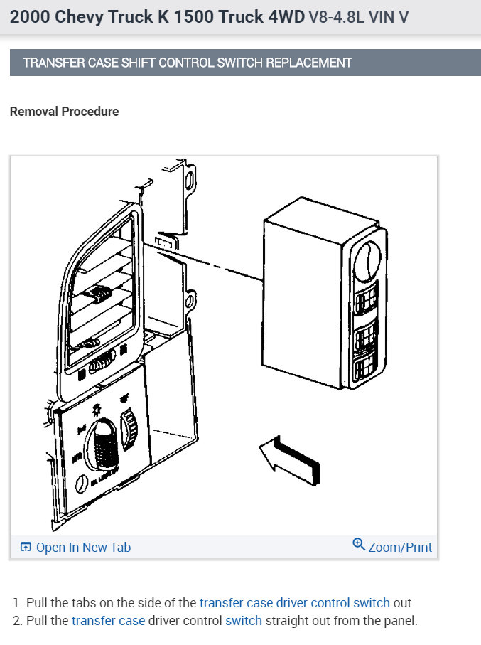

I bought the truck in the spring and just tried out the 4x4 for the first time. I put it in 4lo and it went in. Then when I tried to take it out the dash lights ( on the 4x4 switch panel ) went out. Found blown atc fuse. Replaced actuator and encoder motor and no luck. Traced wires and found no breaks in them. My mechanic says I need a transfer case and 2 other garages that I know say I don't it's something else. Any info would be great help thank you
Sep 2, 2020 at 3:38 AM
(Merged)
CARADIODOC
✓Experienced Mechanic
34,413 POSTS
I had this problem with my truck same year and model the switch was bad which I replaced it started working it might work for you as well. The instructions to change the switch are in the diagram below. Check out the diagrams (Below). Please let us know what you find.
Image (Click to enlarge)
(Merged)
LOSTASUSUAL
MEMBER
1 POST
I got a switch for $84.00 it took care of the problem
