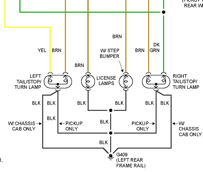

I have a 1194 Chevy Silverado 1500. I am having trouble getting the brake lights to function. All of the running lights work, blinkers and back up lights also. I have replaced the fuse, the lights themselves, and the switch behind the brake pedal. What do I need to work at next?

OK The common wire to both runs thru the multifunction switch, a test of that is needed. Also check the relay for the high mount, it's under the hood, on right side cowl(under the windshield). Check the ground for the lights. Check diagram for the location.

FRUSTRATION
Got it. While looking for the problem, I found a ground issue from an old set of backup lights that had been installed and then taken out. Found and fixed! Thanks tremendously for the help!

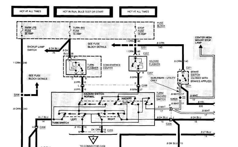

I press the brake pedal and it blows out fuse. I replaced switch, relay and ground wire.

  • 52,797 POSTS
Good morning.
Does the turn signals work normally?
From the switch, the circuit goes to the turn signal switch and the third light relay.
The diagram below for you to view.

NICK AGUILAR
Added a new brake switch as soon as you press panel it blows out stop fuse.
Friday, February 26th, 2021 AT 10:40 AM (Merged)
  • 52,797 POSTS
I read that in your original post.
Unplug the turn signal switch and replace the fuse and see if it still blows the fuse.

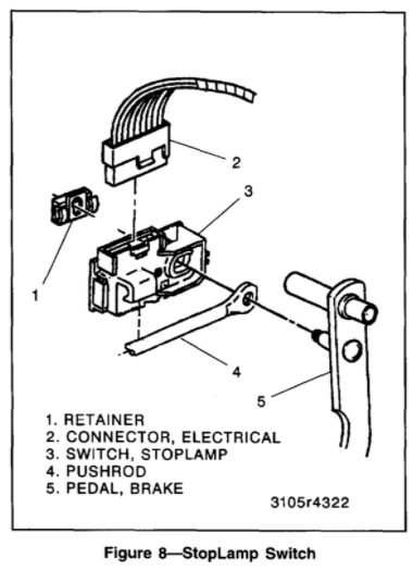

TFRANKLAND
This truck is my daily and I need brake lights to drive it.
Every light but brake lights work, even running lights in the rear when the headlight switch is on. I replace the circuit boards and bulbs when I had this problem when I bought it and it fixed it for a while, until today. My brake lights stopped working and my CEL came on showing P0172 and P0175 which i've also had before but neglected to fix because the CEL went off after 50-100 miles of driving. I don't think the 2 are related but I could be wrong, please tell me if I am.
I have checked fuses, relays, grounds, and connections to the circuit boards, I even tested continuity to the brand new circuit boards as well. Does anyone have an idea of what this could be? I'm not worried about the codes right now if they don't relate to the brake light issue. I just need them to work so I can work, lol. Edit: if it matters my temperature gauge doesn't "work" either. It moves but not to where it's supposed to.

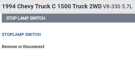

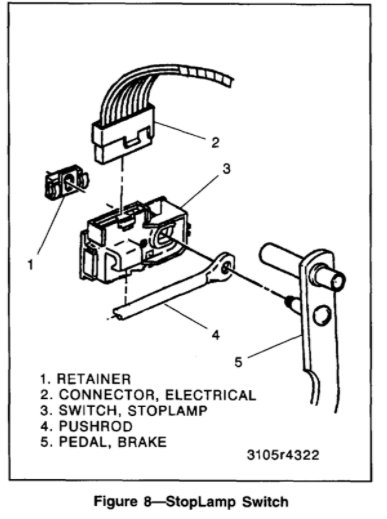

DANNY L
  • 5,648 POSTS
Hello, I'm Danny.
The most common issue for not having brake lights is having a defective brake light switch which is mounted against the brake pedal. Since you've attached your question to a prior one we will need you to start a new question regarding the check engine light codes as that is a different subject which is not related. I can give you the information on how to change the brake light switch and I've attached the picture steps below for your truck. Here is the link to start a new question for the check engine light codes:
Be sure to include all your vehicles information as well as symptoms and we can help diagnose. We look forward to hearing back from you. Hope this helps and thanks for using 2CarPros.
