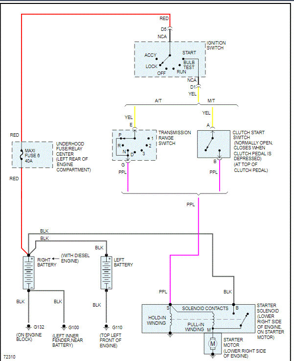

Starter is good. Having trouble finding where the purple wire goes to from the solenoid. I can't see a relay in the fuse box is there one?
Friday, February 5th, 2021 AT 8:42 AM (Merged)
  • 109,959 POSTS
The purple wire in this truck will run to the park/neutral safety switch. I attached a pic below which shows the entire wiring schematic for the starter. Let me know if it helps or if you have other questions.
By the way, there isn't a starter relay on this vehicle.

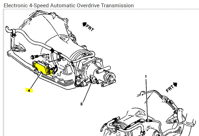

The switch I'm referring to will be on the left side of the transmission approximately in the middle of the transmission. See pic 2.
