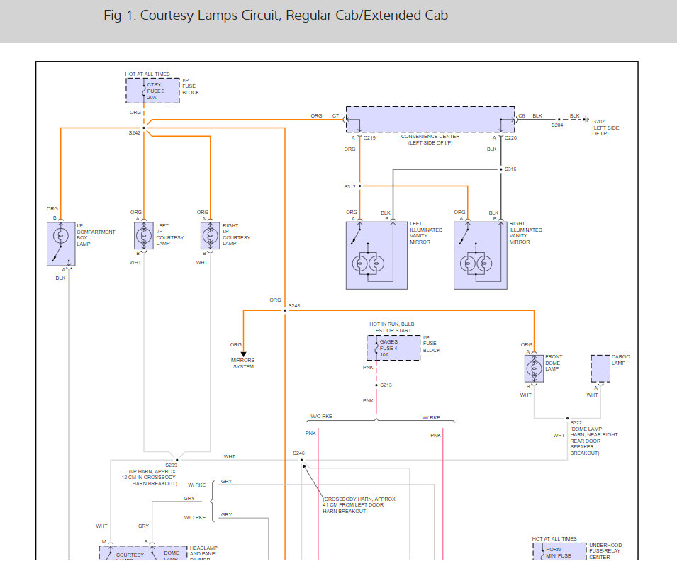

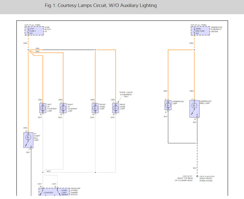

Dome light does not always turn off when door is closed or engine is started. I do not know if this truck has delay on the interior lighting. I am considering re-wiring the whole interior lighting circuitry with a relay and my own wiring to fix this. Is this a problem with the "convenience center" found in the manual or something else? Thanks!
Jun 27, 2010 at 8:49 AM
BLUELIGHTNIN6
  • 16,542 POSTS
It sounds like the pin switch on the drivers side is bad. Can you remove it to see if the problem continues? Here is the wiring diagrams so you can see how the system works.

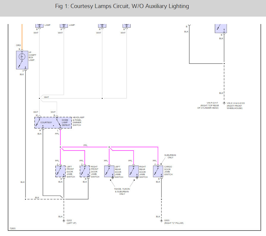

if door ajar switches tested good then the dome switch itself on instrument panel may be bad, or it could possibly be the wiring but that is the hardest to check out and replace so its best to test the switch first

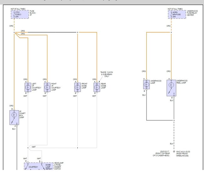

It sounds like the headlight dimmer switch is bad, here is a wiring diagrams so you can see how the system works. Check out the diagrams (Below). Please let us know what you find. We are interested to see what it is.

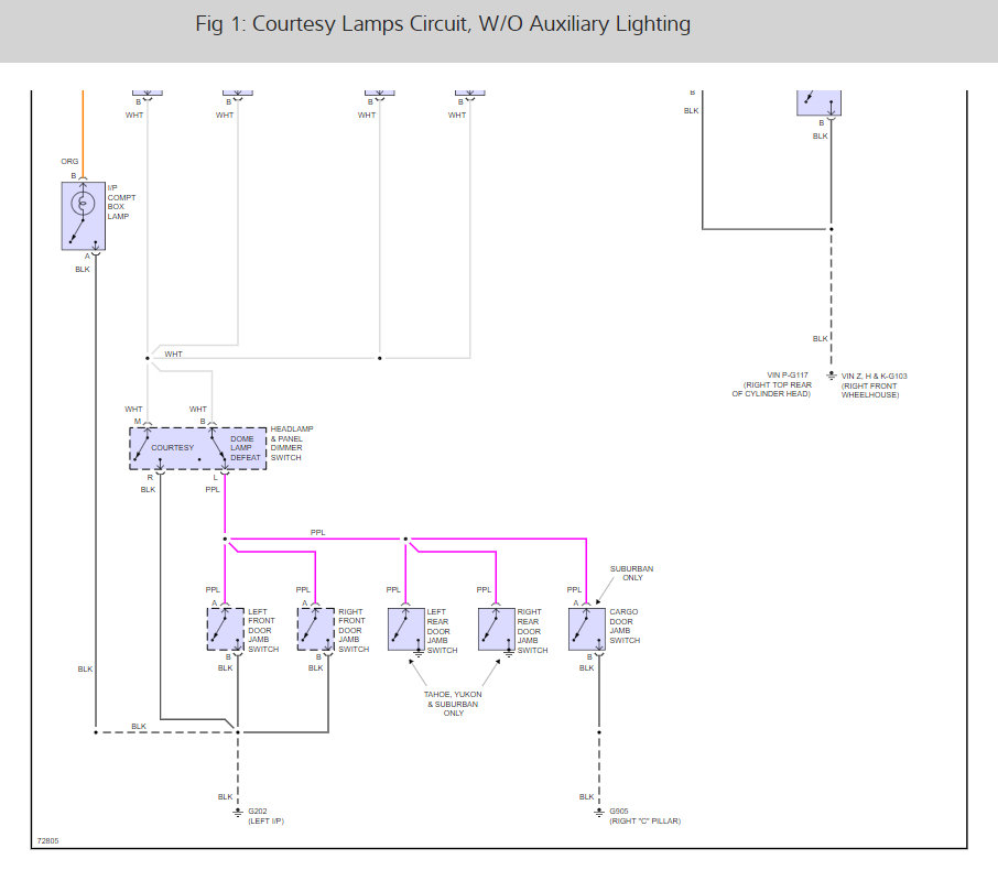

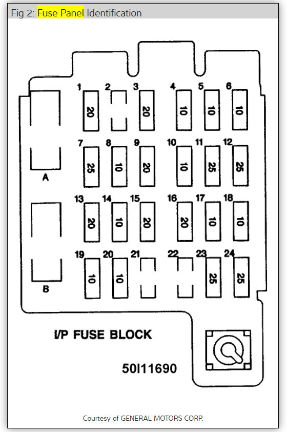

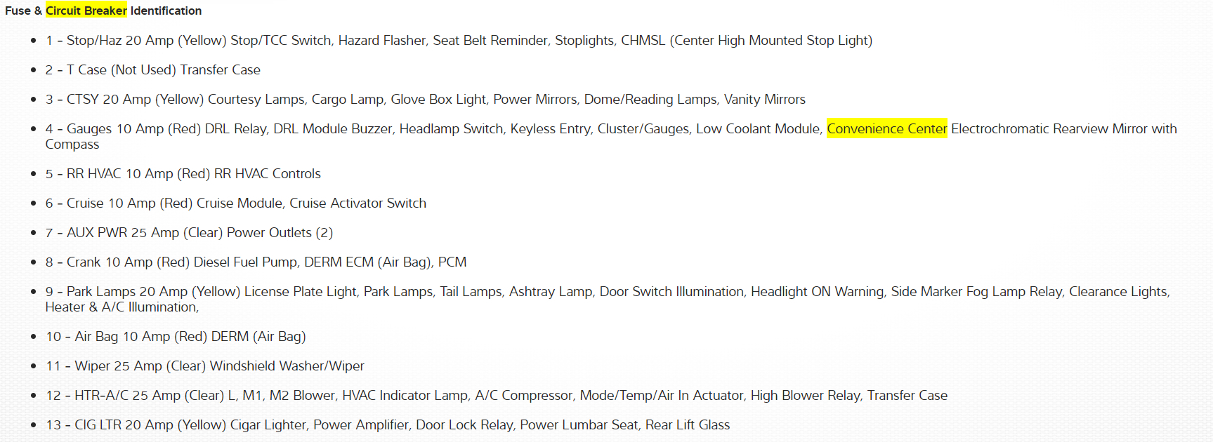

There is a courtesy light fuse #3 that needs to be checked. Here is a guide to help you test the fuse and the fuse location with the dome light wiring diagrams so you can see how the system works:
Check out the diagrams (below). Please let us know what you find.

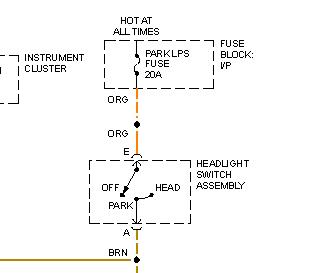

my interior lights and parking do not work.
head lights and turn signals and brake lights do work, and all the guages work. the cig lighter works as does the heater and after market radio. i removed the factory amp and radio and used a wire adapter kit to install a am/fm/cd player. i do not remember if the lights worked before the radio swap or not. i replaced the switches 3 times and the fuses are all good

Did you use a testlite on the park lamps fuse. You shouldn't need to pull the fuse. There should be a bare spot over each leg. If voltage on each leg, the fuse is good and there is voltage. Even if the fuse is good, no voltage and the circuit is dead. Did you check for voltage and ground at tail lamp socket? The brown wire from headlamp switch is voltage for tail lamps.
https://images.2carpros.com/forum/automotive_pictures/170934_park_lamp_fuse_1.jpg

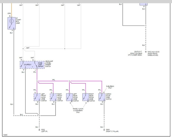

FERNANDO228
I have a 1992 1500 series 4x4 v8 Chev Silverado with approx. 150000 miles on it.
The problem is, just recently the interior(dome& two floor) lights came on by themselves while I was driving. Since then, they wont shut off. The only way I can shut them off is by removing the courtsey fuse from the fuse box.
I've replaced the two door jam switches but, still have the same problem.
The interior lights will flicker from time to time and sometimes shut off briefly while driving but, stay on for the most part. My aftermarket radio/cd player runs off the same fuse as the lights but works fine even though the lights flicker or shut off briefly. I've had the radio/cd player in the truck for 5 years so, I don't think that's the problem.
The interior light dimmer switch seems to be working correctly. It allows me to either turn off the dash lights completely or put them to their brightest.
All other electrical works fine and I haven't had any electrical problems up until this time.
Any tips on how to possibly solve this problem would be appreciated.

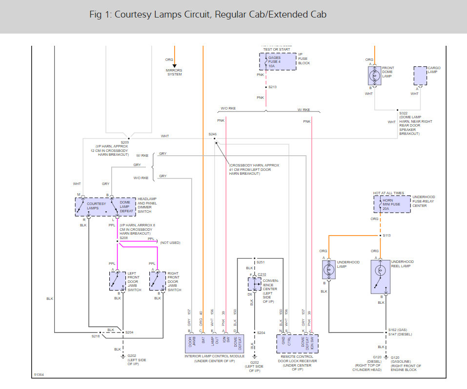

Solving this could get a little messy, but we can start with some easy stuff. Your observation about the radio being on the same circuit is valid, but that is the 12 volt supply for both circuits and it feeds the interior lights all the time. The lights are switched on the ground side of the circuit. That way only one wire has to run to each switch, and the other switches' wires are just tabs that are part of their mounting hardware. The exception is when the switch is mounted to a plastic part such as when GM puts them on the side of the dash pad, or when there's multiple circuits being switch by that switch.
The first thing to do is remove and unplug every door switch. There may be one on the side of the dash and another one on the "B" pillar near the door latch's striker. You'll also have to unplug the head light switch. The rheostat for the dash lights and the dome light switch are two totally different parts of the switch. Also, if there is anything that causes a delay in turning off the lights, you'll have to find that too and unplug it.
At this point, if you measure the voltage on any wire that was connected to a door switch, you SHOULD find 12 volts and the lights should be off. If the lights are still on, you're going to find 0 volts indicating that circuit has a short to ground somewhere. This is where it can get messy by taking a lot of interior panels apart to find the short. Before we get to that point, since the intermittent flickering tells us this isn't a solid grounded connection, consider running around the truck with a rubber hammer. Watch for flickering as you pound in various places.

Next, remove the dome light assemblies. Some designs have socket terminals that can touch the body if they aren't positioned correctly, particularly those that use the tube light bulbs that have a round cap on each end. These assemblies often get their ground circuit through the mounting screws.
This is where it gets messy. An orange wire feeds the 12 volts to most of the lights. They have white wires that get grounded by any of the switches to turn all of them on. Those white wires run to every light socket and to every switch. If any of those wires has rubbed through the insulation and is touching the body, all the lights on that circuit will turn on. If you can't find a clue as to the location of the short by wiggling and tugging on the wires, you have to start cutting them apart. Later you'll have to splice all those cuts back together.
Think of having a leak in an underground lawn sprinkler system. There's no way to tell where the leak is. All you know is water is flowing through the main pipe. To isolate the branch with the leak you would have to block each circuit until the leak stopped. That means turning off various valves to the individual branches. Cutting a wire is like closing a valve. The only problem is soldering and sealing all those cuts takes a lot more time then turning a valve.

Th Thanks will try again I did notice that on the dome light there is a white wire that touches the truck body I should disconnect. And see if all the lights turn off
Sep 14, 2020 at 4:33 AM (Merged)
CARADIODOC
  • 34,331 POSTS
Yup. The white wires go to ground through the switches, not directly.
