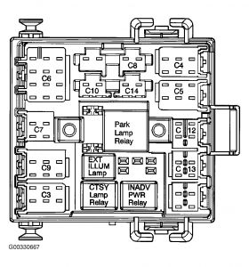

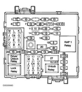

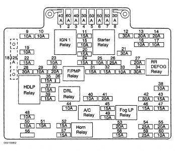

BMRFIXIT
  • 19,053 POSTS
Recheck all fuses using a test light
check the bulb
any thing else isn't working
if all checked OK need the help of a scanner to test the relays , BCM module and wiring
https://www.2carpros.com/forum/automotive_pictures/99387_chey_1.jpg
https://www.2carpros.com/forum/automotive_pictures/99387_chey1_1.jpg
https://www.2carpros.com/forum/automotive_pictures/99387_chey11_1.jpg
-1
Monday, September 14th, 2020 AT 11:31 AM (Merged)
