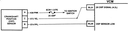

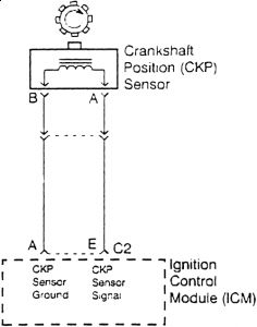

My chevy s10 truck was running lastnight just fine now this morning I go to start it and it wont fire up. I just put a new starter, fuel pump, and battery in

Check the crankshaft position sensor.
this is one of the most important signal.
the ECM fuse 20A
https://www.2carpros.com/forum/automotive_pictures/46384_fuse_1.jpg
Disconnect the CKP sensor harness. Connect an LED test light between battery ground and CKP harness terminal A .
With the ignition ON and the engine off, verify that the test light illuminates.
If not as specified, repair or replace the fuse and/or wiring.
Carefully connect the test light between CKP harness terminal A and B . Verify that the test light illuminates.
Next, connect a AC volt meter to the jumper wire corresponding to CKP terminal C and battery ground.
Crank the engine and verify that the AC voltage signal is at least 10.0 volts.
If not as specified the CKP sensor may be faulty.
https://www.2carpros.com/forum/automotive_pictures/46384_ignition_module_1.jpg
Suposely, the cables from and to the starter and battery are very good.
remove spark plug and check if they are wet.
