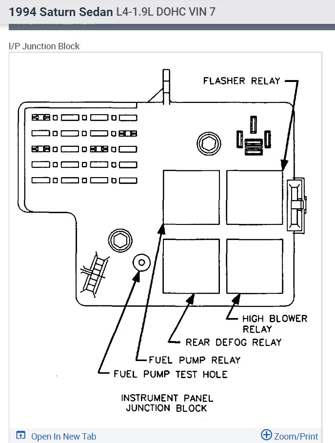

I have a 1994 Saturn Sl2 with 242,465 miles it has the twin cam engine.(looks and runs great) I bought a 12 volt compressor to air tires,also has a emergency light with flasher. The lighter doesn't work and when I plug in compressor it doesn't work. I was thinking it may be the fuse. When I bought the car it did'nt have an owners manual. There are fuses on the passengers side that are numbered.Need to know which fuse is for lighter.

The lighter fuse is the LOCKS fuse 20 amp int ehf sue panel inside the car. This guide can help you test it for power and I have included the fuse location in the images below.
Check out the images (below). Let us know how it goes

[quote:695809f9b8="CHEVYII"]the fue panel should have a diagram to tell you which one is for the lighter , if you plug in the compressor anfter replacing the fuse and it blows the socket may be bad , but go for the f
use first and let us know what happens[/quote:695809f9b8]
1.airbag 12.fpump
2.turn 13.dim
3.ign3 4.hvac 14.drl
5.ign1 15.park
6.wiper 16.priest
7.cruise 17.sun
8,9&11.spares 18.body
10.radio 19.chime 20.locks

i found its #13 but it also works the locks and a lot of other items but check it anyway

ok check the locks fuse, no radio at all , it was taken out ??
Feb 21, 2007 at 12:55 PM
MIKEMARTIN
That was it good job and thank you.Mike :D
