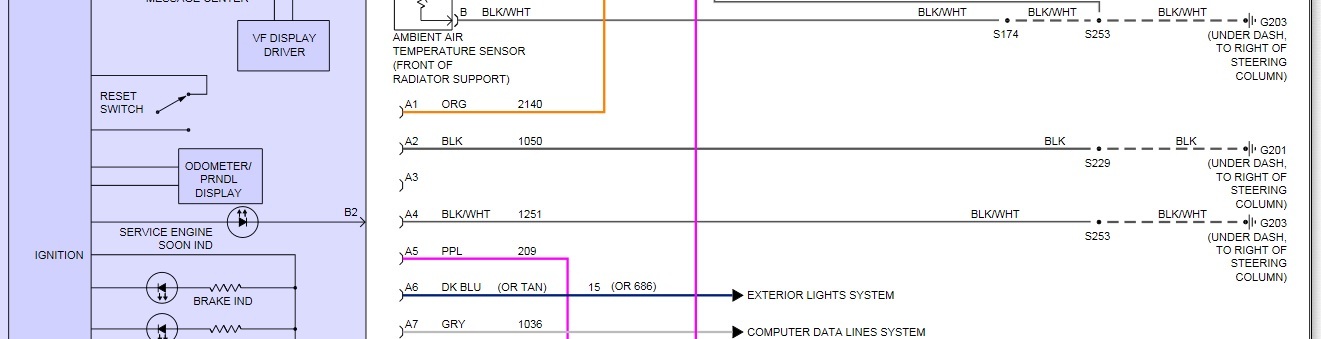

LAWYN
  • 6 POSTS
I was told that I might have a ground fault in clstr/BCM/DLC circuit. How can I check this to find out? Where is the ground for this circuit located?
+1
Monday, May 6th, 2019 AT 6:29 PM (Merged)

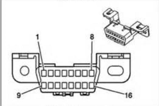

JDL
  • 16,098 POSTS
The ground for the instrument cluster is A4 in the diagram. Take connector loose from instrument cluster, use a test lite connected to battery voltage, touch the A4 terminal on the wiring harness connector, if the lite comes on, the ground is good.
At your datalink connector, where you plug in a scanner or code reader, pin 16 is hot all the time. Check for voltage. Pin 4 and 5 are grounds, check those also.
JDL
  • 16,098 POSTS
This is your data link connector.
