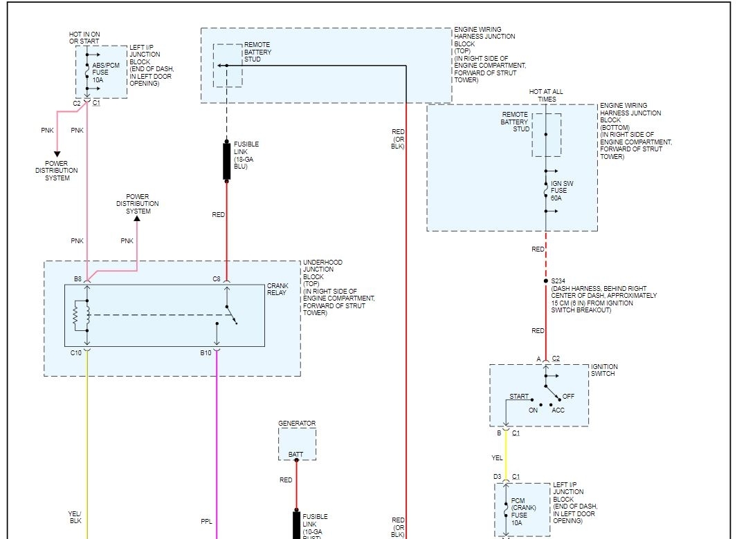

Where is the starter relay located?
Sunday, December 20th, 2009 AT 1:46 PM
33 Replies
JDL
  • 16,098 POSTS

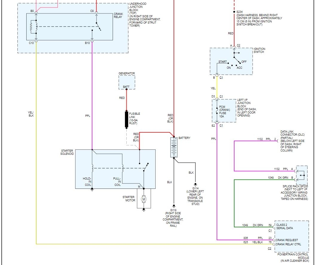

Welcome to the forum, my info says the crank relay is located under hood junction box (top). There is also, a pcm/crank fuse, left instrument panel junction block, use a test light on that fuse circuit, goes hot with key in start position. That voltage is crank request to the pcm, then the pcm should ground the coil side of crank relay.
See the guide below, it will help
Wiring diagrams for your starting circuit are attached below

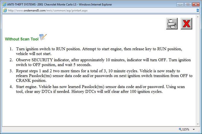

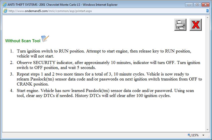

You can try the 30 minute relearn procedure. When you try to start, leave the key on, watch the security lite, see if it goes off after about 10 minutes, if it does, turn key off for 5 seconds. Repeat the procedure twice more for a total of thirty minutes. If it is going to work, if should work on next key cycle.
You need to check for applicable codes. To check codes, yourself, at the least, you need an obd2 code reader.
