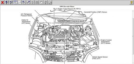

I have problem with this metro what happen is that
the car wont start ans is because the injector don spray the fuel,I know that the crank sensor should send grount to injector Ichange the crank sensor but still the same if I left the car with the battery disconected for many hours the fuel injector spray one o two tiimes will you please hellp with that issue

Also test the camshaft sensor if both okay -check the computer injector ground drivers

OK TWO MORE QUESTIONS.
Were is the cam sensor location?
what is injector ground drivers?
thank you and GBY
Jul 24, 2010 at 12:07 PM
  • 75,992 POSTS
The camshaft sensor is located On cylinder head, near ignition coil No. 2. The injector ground drivers are built into the computer
