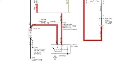

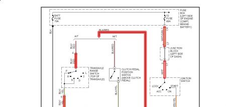

replaced starter and still same problem justs clikcks put new starter in it clicked three times then turned over and started shut it off tried again same problem just clicks
Feb 7, 2010 at 6:02 AM
  • 75,992 POSTS
Double check battery connections also at the starter side-if okay test the transaxle range switch and ignition switch
