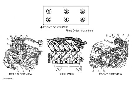

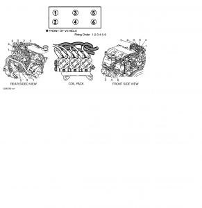

Electrical problem
1999 Chevy Malibu 6 cyl Automatic
I am trying to replace the spark plugs and wires in my car and i think i switched the wires. Can you please tell me how to get the wires in the right position because I do not have an owner's manual. Thank you in advance.

https://images.2carpros.com/forum/automotive_pictures/99387_malibu_2.jpg

https://images.2carpros.com/forum/automotive_pictures/99387_malibu_3.jpg

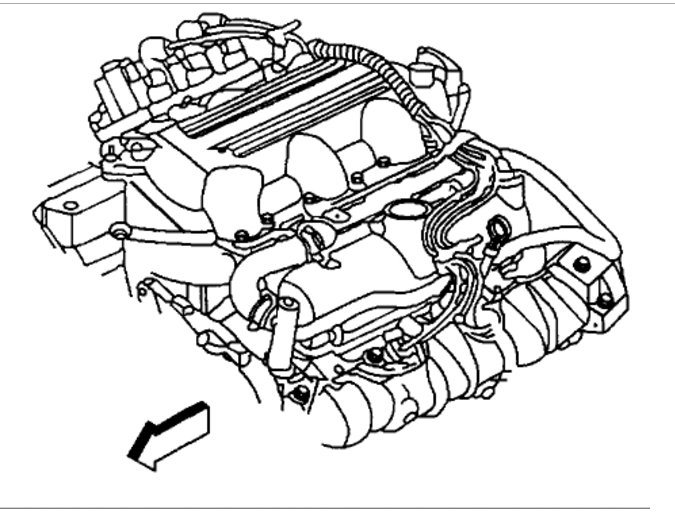

I need to change the spark plugs in my 3.1L malibu, but can not figure out how to access the plugs next to the firewall. Should I remove the coil pack to better access? Thank you for your help.
Jun 8, 2020 at 6:46 AM (Merged)
DALEJRFAN820002000
[quote:58320dfbbd="rogbulkley7"]Electrical problem
1999 Chevy Malibu 6 cyl Front Wheel Drive Automatic 103000 miles
I need to change the spark plugs in my 3.1L malibu, but can not figure out how to access the plugs next to the firewall. Should I remove the coil pack to better access? Thank you for your help.[/quote:58320dfbbd]
Yes you will have to take of the coil pack. I just got doing a head job on a 99 malibu and it was fun.
