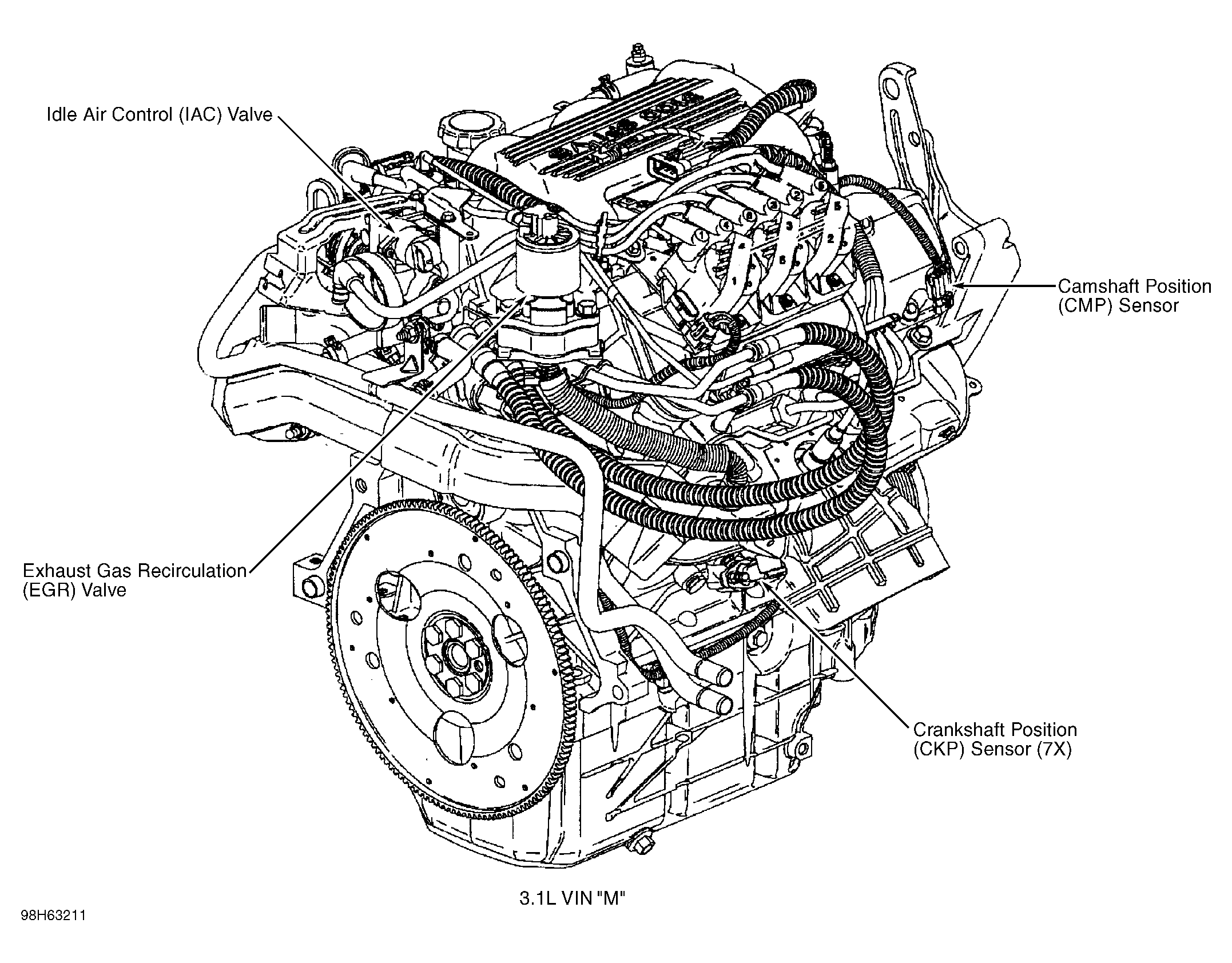

TAWNYS
my 2000 chevy malibu will have rpm at 2 or 3 in park. And while driving it will be at 3rpm without ever touching the gas. It is the craziest thing..... I can go all the way to work without ever touching the gas petal. What wrong? I've had the fuel system cleaned out new spark plugs and spark plug wires. I still have the same problem.
Jan 23, 2019 at 7:08 PM (Merged)
DOCFIXIT
  • 18,828 POSTS
Suspect faulty IAC see diagram

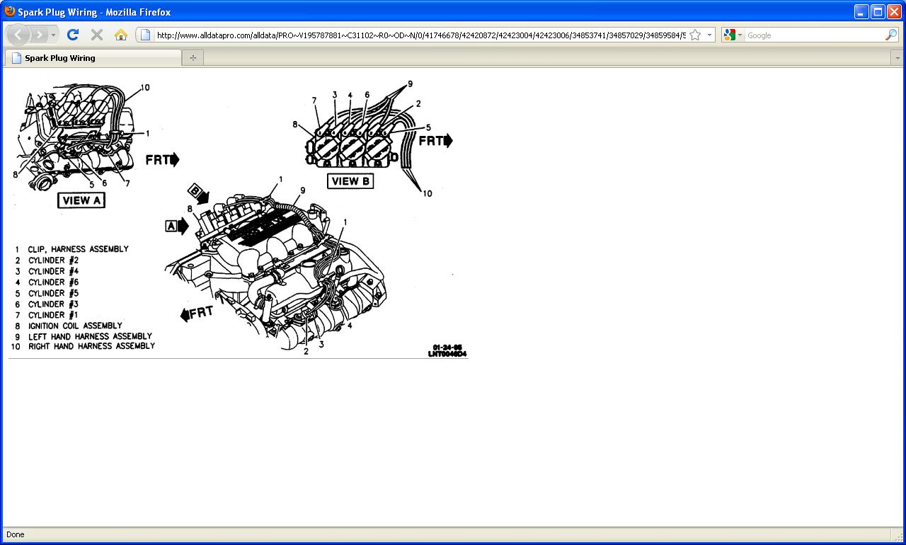

CHUCK1990
where are the spark plugs located on a 1997 chevy malibu
HMAC300
  • 48,601 POSTS
there are 3 in each head. the first three i'm sure you can see at the end of the plug wires. the other three are similarly placed and can be reached with a fle head rachet and plug socket. sometimes the top dogleg mounts haveto be taken off and the car put in neutral and the engie rocked forward to remove the plugs. Make sure to do this on a cool engine as you can strip the head removing them and put anti-seize on the new plug threads for ease of removal next time.
SATURNTECH9
  • 30,869 POSTS
There right below the valve cover's i posted a diagram follow the spark plug wire's from the coil's to the spark plug's.

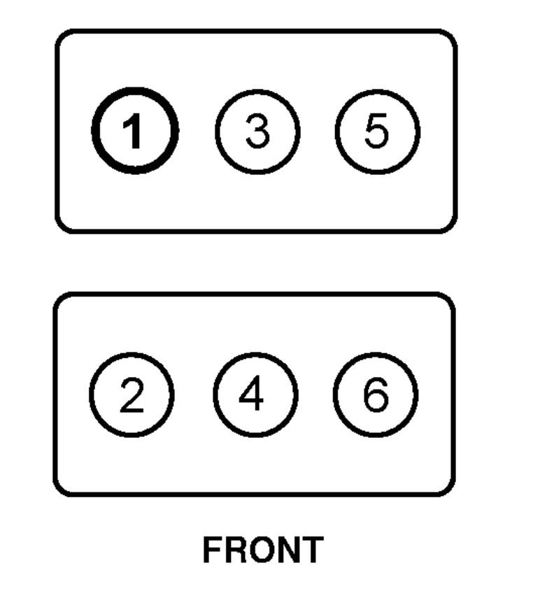

RAY CHITWOOD

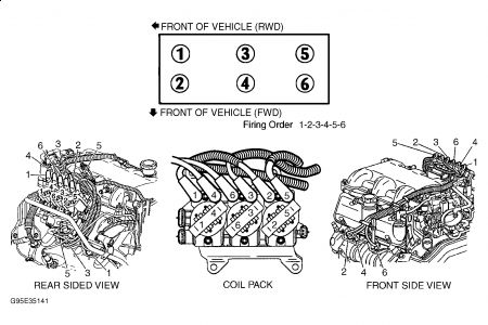

My check engine light is on and I need to know where spark plug # 2 is
BLUELIGHTNIN6
  • 16,542 POSTS
Firing Order .................... 1-2-3-4-5-6
Here is the cylinder numbers for the 3.1L
See attachment below
