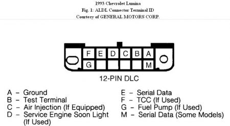

KHLOW2008
  • 41,812 POSTS
Hi dalty, Thank you for the donation. If the catalytic converter is clogged, it would not glow red hot. It would glow red hot when excessive fuel is getting to it, such as a bad or misfiring cylinder. Was anything done prior to it occurring? Some trouble codes do not cause the CEL to show and here are the procedures for retrieving trouble codes. Let me know if any found. RETRIEVING CODES (NON-SCAN) NOTE: Inserting jumper wire into test and ground terminals of ALDL connector with engine running will cause fuel injected vehicles to enter field service mode. Flashes of SERVICE ENGINE SOON light will not indicate codes if this is done. 1.Turn ignition on. DO NOT start engine. SERVICE ENGINE SOON light should glow. Locate Assembly Line Data Link (ALDL) connector attached to control module wiring harness. Insert jumper wire from terminal "B" (diagnostic test terminal) to terminal "A" (ground) of ALDL connector. See Fig. 1 .
https://images.2carpros.com/forum/automotive_pictures/192750_ALDL93LuminaFig01_1.jpg
2.SERVICE ENGINE SOON light should begin to flash codes. Each code will be repeated 3 times. If codes are not flashed or SERVICE ENGINE SOON light does not glow, perform DIAGNOSTIC CIRCUIT CHECK. To exit diagnostic mode, turn ignition off and remove jumper wire from ALDL connector. NOTE: Inserting jumper wire into test and ground terminals of ALDL connector with engine running will cause fuel injected vehicles to enter field service mode. Flashes of SERVICE ENGINE SOON light will not indicate codes if this is done. See FIELD SERVICE MODE CHECK in BASIC TESTING article in this section.

its not glowing red. and it dont show any codes. hasnt. i bought it from a individul that didnt have the time for it.

yeah. have had the computer ran on it. not showing any codes. you didnt even answer my MAIN question
