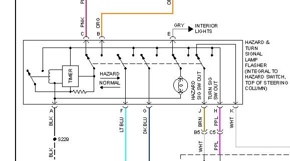

Okay so all of a sudden my 2000 Chevy Impala's blinkers stopped working. All of them. The light for the blinkers doesn't even come on in the dash display and there is no light coming from any of the 4 blinkers. I just replaced the relay for the blinkers which did not solve the issue. I checked the fuse and I was getting a reading so I assume it's not blown. It started where the right blinker stopped working and we replaced the bulb. A week later none of them work. I don't understand why they all of a sudden just decided to stop working. Please help me I can't get to work or use my car!
Tuesday, August 20th, 2019 AT 7:43 PM (Merged)
HMAC300
  • 48,601 POSTS
Try your hazard flashers to see if they work, i'm sending a pic of where the lflasher is as it's part of the hazard switch. Check the ground and see if t/s switch is getting and sending power. You can always use hand signals to drive the car. Although if t/s switch is bad your brake light s may not work either.

The blinkers quit working, after I hit the emergency lights the blinkers start working. That works most of the times but rarely the emergency lights do not work either.

My turn signals stop working but if I set the hazards then turn them off the turn signal start to work

My turn signals work for approximately the first 5-10 minutes of driving, then as the car heats up, the turn signals no longer work, unless I move the steering wheel just right to either the left or the right. What are your thoughts?
DOCFIXIT
  • 18,828 POSTS
Would have to say something with the turn signal switch. Possible worn contact issue or loose mounting bolts.
  • 109,936 POSTS
Have they checked the multi-function switch on the steering comumn as well as wiring in the steering column?
