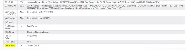

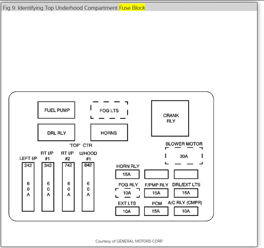

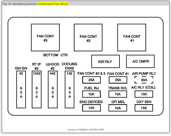

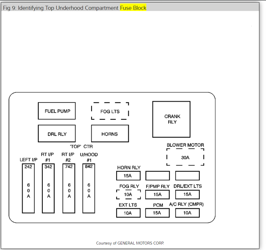

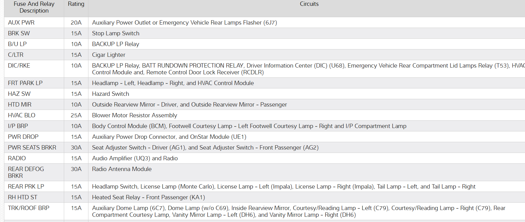

here is some info,found a bulletin for this problem.Due to the common architecture Body Control Module (BCM) utilizing several fuses for power, and the labeling of the fuses, it is possible to overlook some fuses in the Under hood Bussed Electrical Center (UBEC) when diagnosing a concern with the turn signals, trunk actuator, courtesy lamps, or Brake Transmission Shift Interlock (BTSI).
If the fuse in the UBEC labeled RT T/SIG is open it will cause the right rear turn signal, the trunk actuator, and the BTSI to be inoperative.
Note: The right front turn signal will still function.
If the fuse in the UBEC labeled INT LIGHTS is open it will cause the right front turn signal to be inoperative.
Note: The right rear turn signal will still function and the courtesy lamps will still function.
If the fuse in the UBEC labeled INT LTS/PNL DIM is open the courtesy lamps will be inoperative.
Note: The instrument panel cluster backlighting will still function. why don't you take it to the dealer to get fixed?it's under factory warrenty.hope this helps.

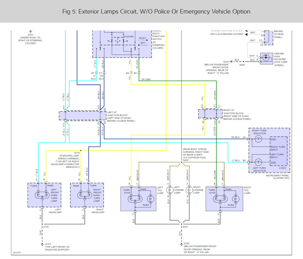

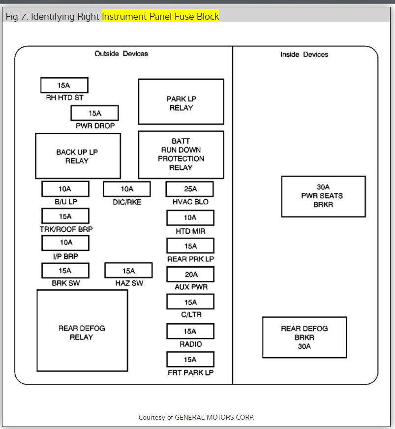

JOHNNYT73
  • 924 POSTS

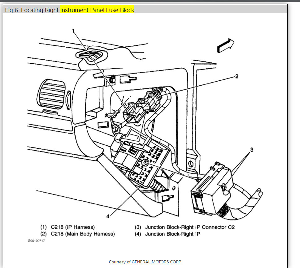

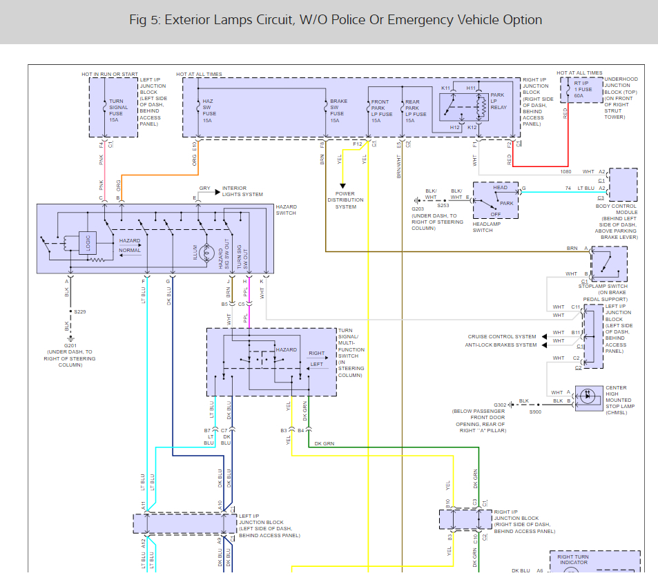

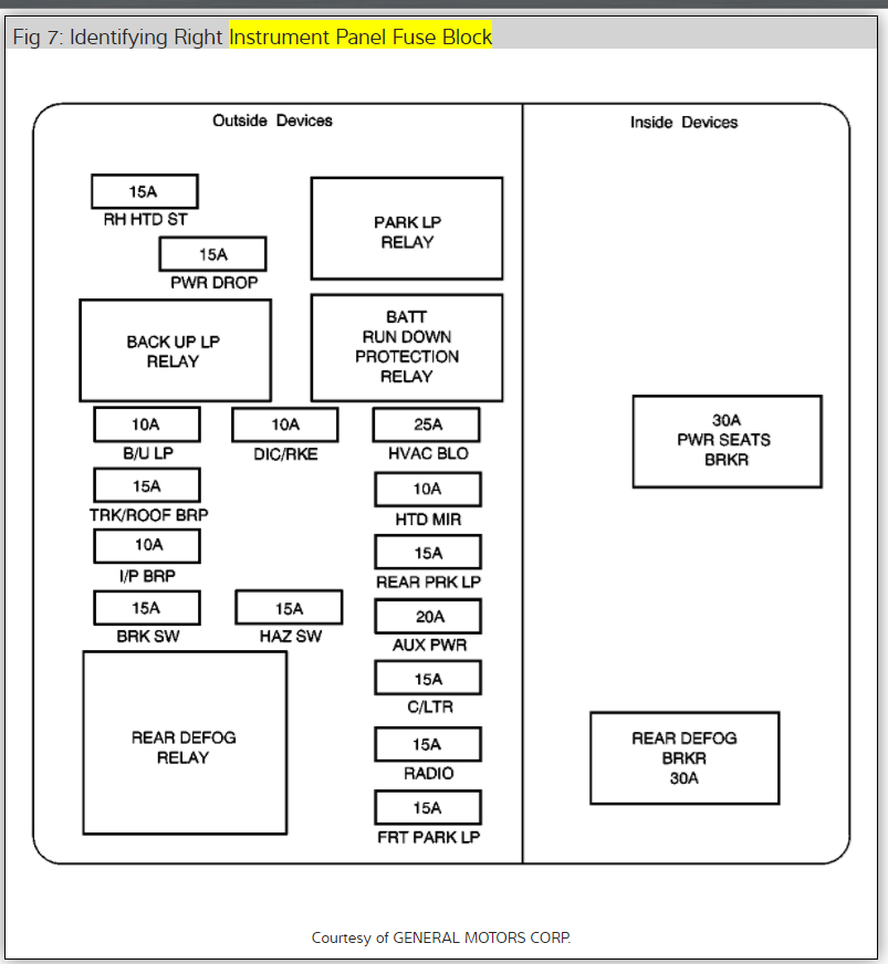

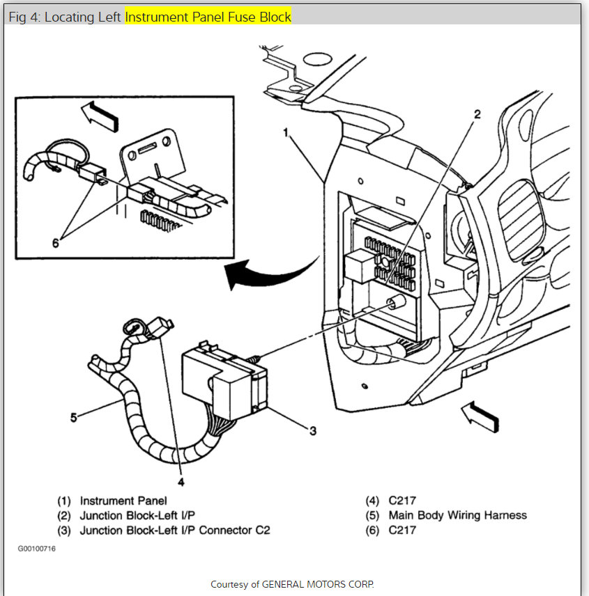

okay, try pressing your hazard switch on and off again a bunch of times to see if they start working. If they do then great but it may only be temporary. We are loosing power somewhere and that is a tail light relay you need to check. It sounds like the hazard switch could have gone out sometime people spill coffee.
Here are two guides to help you see how to find the problem.
and
Here are the wiring diagrams and relay locations (below) see where you are losing power.
Cheers
Aug 20, 2019 at 12:42 PM (Merged)
CHELSEY ADAMSON
  • 0 POST
I followed these guides and found out it was the hazard switch one I replaced it everything started working again. Thanks for you help, this site is great.

RFOSTER127
All Bulbs- OK, All Fuses- OK, Hazards- OK, Left turn signal- OK, Right turn signal- rear flashing fast, front not flashing. No green arrow on insturment panel for right signal. Replaced Hazard Switch 3 times with same result. Right front bulb will flash on Hazard only, not on right turn.
Aug 20, 2019 at 12:43 PM (Merged)

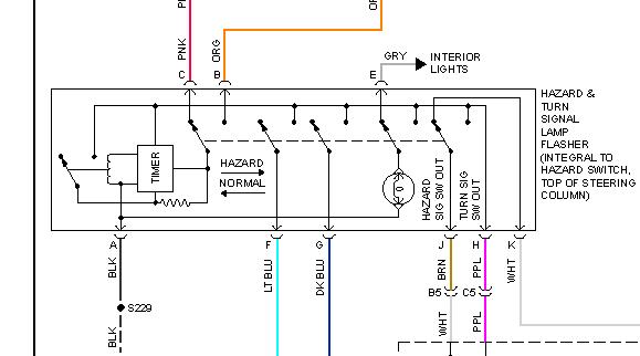

DOCFIXIT
  • 18,828 POSTS
From what I see on wiring the multi function turn switch must have a high resistence on right side ie. burnt contact. High resistence will cause flasher to flash fast and no power to I/P will not light indicater.

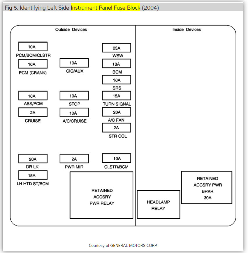

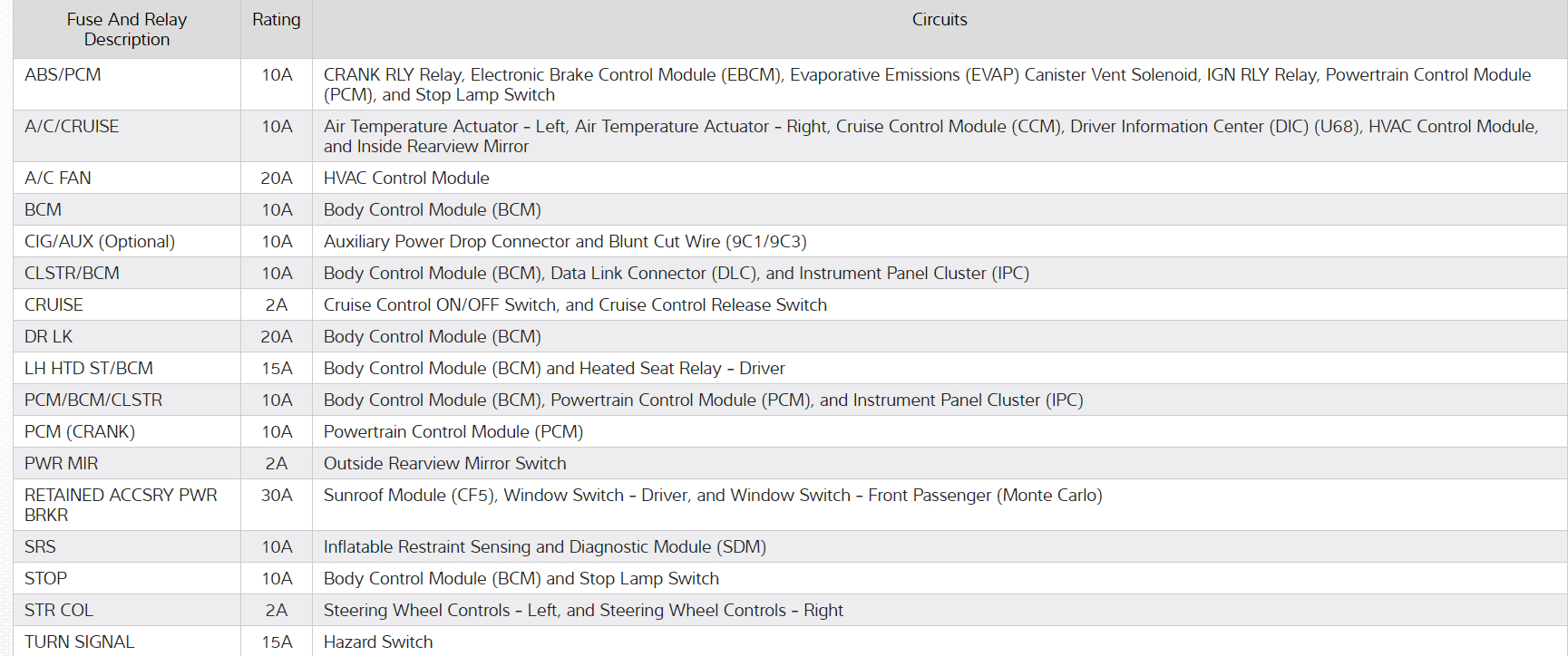

2001 Chevy Impala mileage: 84,000. My dash lights, speedometer and turn signal are not working. I have checked the car manual and cannot find a cause. The fuse box on the side panel says that it controls other lights but all those work, except for the three above. Any suggestions? Appreciate your help.
2CP-ARCHIVES
  • 4,540 POSTS
Check for 12-volts that feeds the fuse panel, especially the connectors that are energized by the ignition switch.

  • 48,601 POSTS
try your hazard flashers to see if they work, i'm sending a pic of where the lflasher is as it's part of the hazard switch. check the ground and see if t/s switch is getting and sending power. you can always use hand signals to drive the car. Although if t/s switch is bad your brake light s may not work either.

CURT22
Electrical problem
2000 Chevy Impala 6 cyl Two Wheel Drive Automatic 109.00 miles
My turn signals stop working but if i set the hazards then turn them off the turn signal start to work
