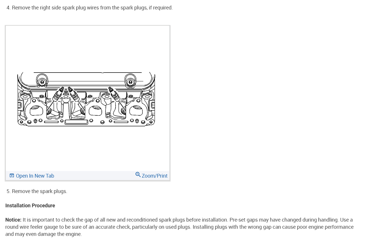

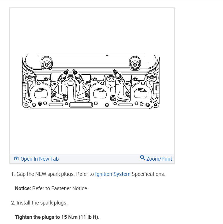

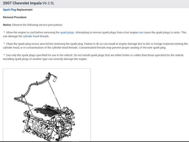

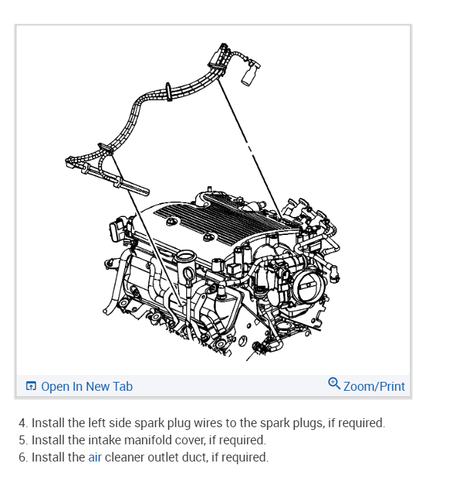

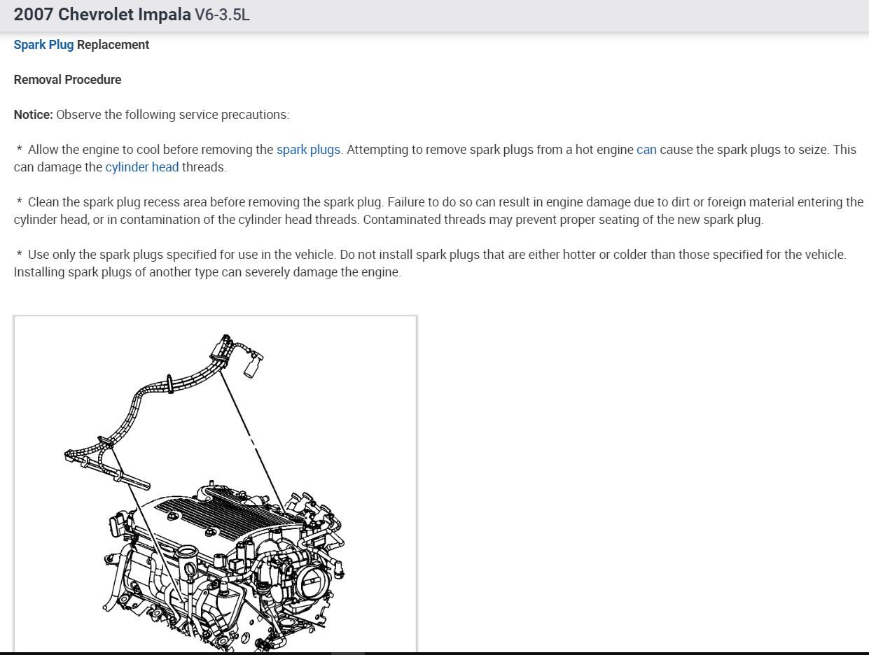

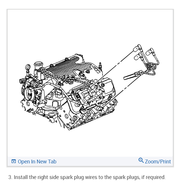

How often should I change my spark plugs? And is it o.k. to use performance spark plugs? I need to change the spark plugs?
Mar 25, 2010 at 4:18 PM
RHALL77
  • 3,361 POSTS
your plugs in that car should be good for 60,000 miles. as for performance plugs, i would suggest using what the factory calls for. Here is a guide to help walk you through the job with diagrams below to show you how on your car.
https://www.2carpros.com/articles/how-to-change-spark-plugs
1.02 mm (0.040 in) gap
Spark Plug Type .................... GM P/N 12591131 (AC Delco #41-100)

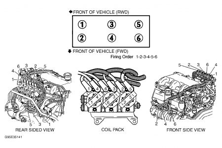

DAVE H
  • 13,384 POSTS

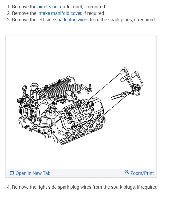

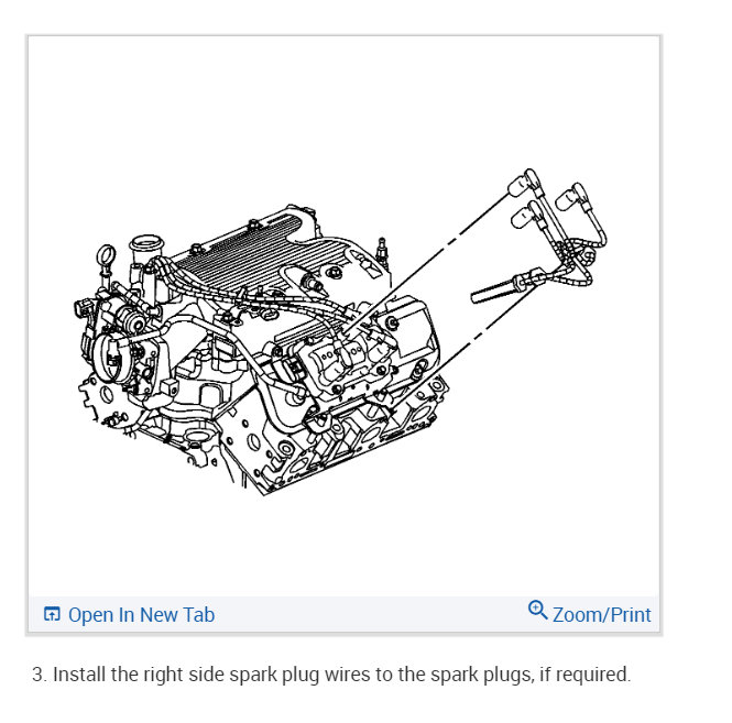

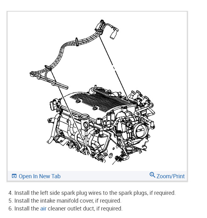

the plugs are at positions 5,3,1 and 2,4,6 at the bottom of each side picture, pull number 1 wire off the top of the number 1 plug using a spark plug socket, unscrew plug from head .. screw new plug back in hole ... taking real care not to cross thread .. re-clip wire back onto plug .. repeat this for every plug .. do not mix up wires .. or your firing order will be wrong ..

Remove the plug wires from the plugs, then remove the spark plugs from the engine with a 5/8 inch spark plug socket. (engine needs to be cold) If installing the spark plugs to an existing cylinder head tighten the spark plugs to 15N·m (11 lb ft). Notice: Be sure plug threads smoothly into cylinder head and is fully seated. Use a thread chaser if necessary to clean threads in cylinder head. Cross-threading or failing to fully seat spark plug can cause overheating of plug, exhaust blow-by, or thread damage. Follow the recommended torque specifications carefully. Over or under-tightening can also cause severe damage to engine or spark plug
https://images.2carpros.com/forum/automotive_pictures/102900_spark_1.jpg
Note: Use only AC Delco spark plugs. Do NOT use Bosch plugs!
