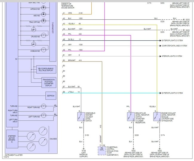

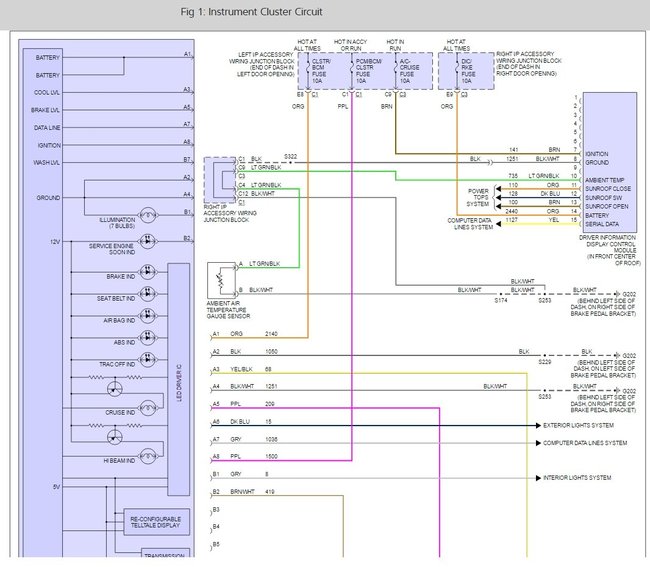

Hey DAVID,
Sorry for the slow response over the holidays, it looks like it could be a fuse or the battery shut down relay,
Here is a guide to help you fix the problem and a few wiring diagrams:
Please run some tests and get back to us so we can continue helping you.
Best, Ken

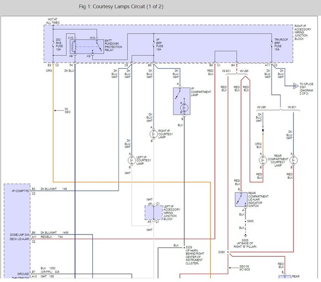

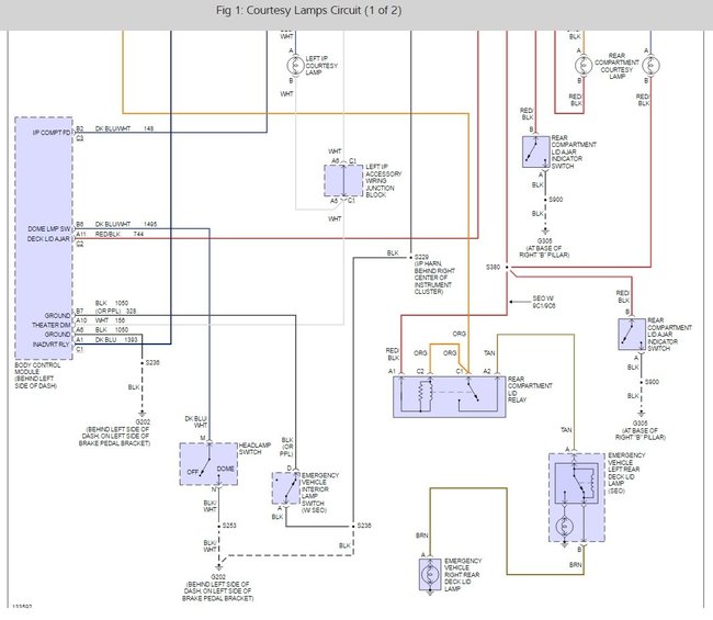

As of December 24th, my parking lights, electric seats, dashboard lights, and FOBs haven't worked. I've checked (metered 4 continuity) all fuses, on passenger side panel & under the hood. No luck! I went thru a big icy puddle xmas eve and the problem occured right around then? Any suggestions?
Friday, August 23rd, 2019 AT 4:23 PM (Merged)
  • 75,992 POSTS
Check and test the park lamp relay in right I/P junction block and also the body control module behind left side of dash.
