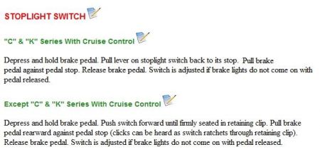

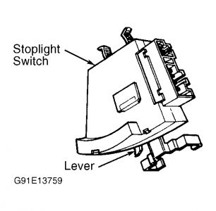

Bought a new brake switch for the truck, yet can't seem to get the adjust correct, if the brake lights are suppose to be ON it's OFF or if OFF then it's ON. Is it the adjustment process I'm doing that is incorrect, connections, or a defective brake switch?
