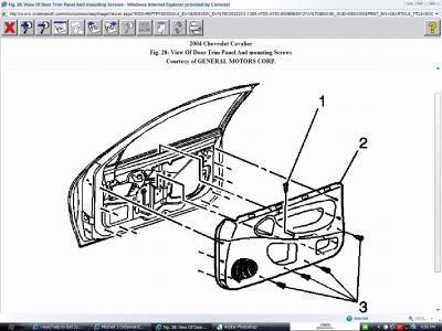

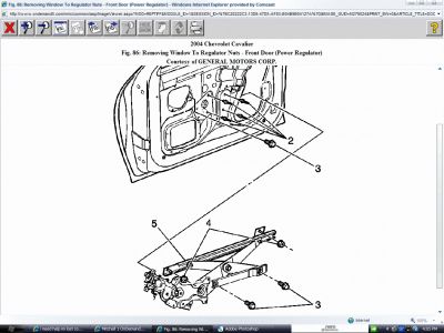

2004 chevy cavalier 62,213 miles 4 cylender....i need help to know exactly what to do to remove my motor for my power window. pictures would be very helpful if you have them for my model of car...thank you so much i look forward to your reply?

The first thing is remove the door trim panel, for this you need a tool to "pop" the plastic clips out after you have removed the screws, or you will break plastic anchor points inside the panel, after the panel is off, there are three screws and 2 rivets, roll the window 3/4 down position, remove the water barrier, or plastic sheet,remove the 4 nuts that hold the glass to the regulator, then push the glass all the way up and tape it there, use duct tape and just tape straight up the glass and over the top and down onto the glass on the other side. unplug the connector, remove the screws and rivets! To put new rivets in you need a two hand riveter!
