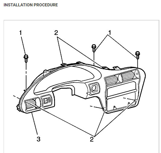

Temp gauge goes from cool all the way over past the red mark - even when engine is cold. Does not run hot, no odors, etc.
Apr 24, 2008 at 12:04 PM
DANNY L
  • 5,648 POSTS
Hello, I'm Danny.

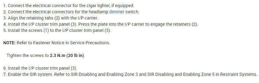

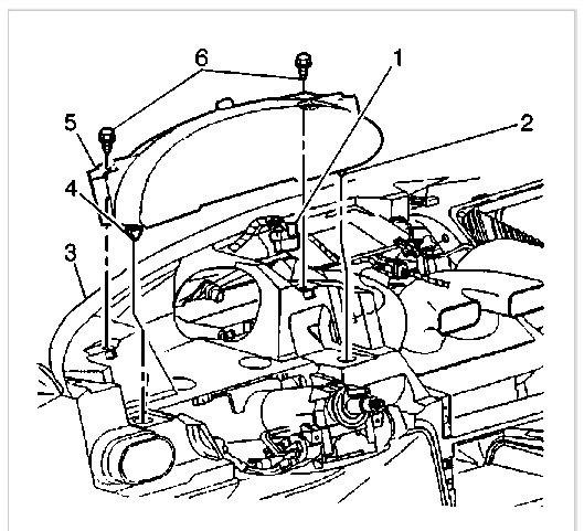

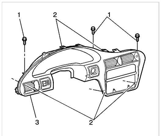

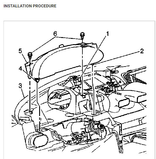

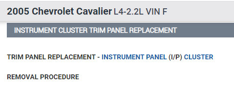

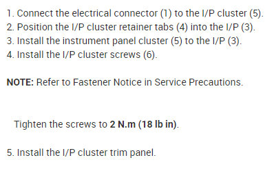

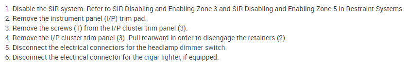

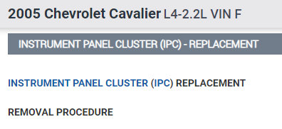

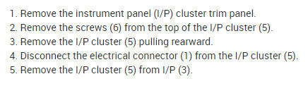

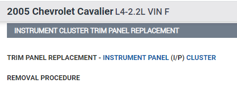

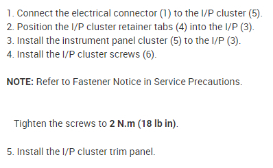

It sounds like the printed circuit board or the engine temperature the stepper motor in the cluster may be faulty in the cluster to be causing an abnormal reading since the car is otherwise running normally. I've attached picture steps below on how to remove and replace the trim to gain access to the cluster as well as remove and replace the cluster itself on your car. Some places like speedometer repair shops can fix instrument clusters. Hope this helps and thanks for using 2CarPros.

The fact that the gauge works but not correctly and you have already replaced the sensor it only leaves the gauge which is a common problem. I would replace the cluster with a used unit to see what happens.
Jul 8, 2021 at 10:23 AM (Merged)
TJSK8BOARDZ
  • 12 POSTS
Yes good call, I changed out the cluster now everything works great! Costs me $120.00 thanks I Iove this site.
