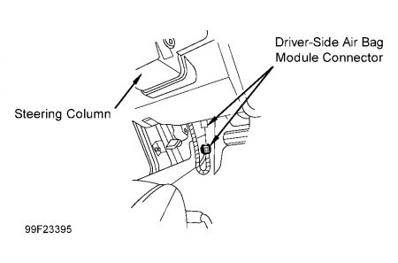

DOCFIXIT
  • 18,828 POSTS
Disable air bag will need to remove steering wheel need a puller. Also if tilt steering will need another tool. May need to loosen column mount bolts to gain room to pull wires out of column.
Apr 25, 2020 at 10:06 AM (Merged)
HOMER5
To disable airbags do I just pull the fuse and disconnect the battery and wait 10 minutes?
DOCFIXIT
  • 18,828 POSTS
Remove trim panel from under colum see diagram dis conect Yellow wire at connector this will dis able bag.

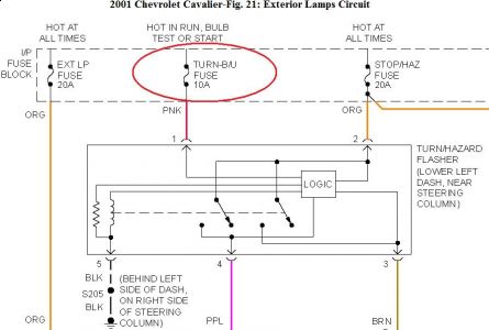

BUDDY KNAPP
my blinkers are not working , and my hazzards are.
i can hear the relay clicking but still no blinkers
Jun 8, 2020 at 10:59 AM (Merged)
ZACKMAN
  • 4,202 POSTS
Did you check this fuse?
https://images.2carpros.com/forum/automotive_pictures/55316_01cavalierturn_1.jpg

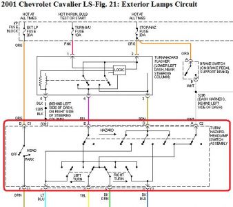

ZACKMAN
  • 4,202 POSTS
If both fuses are good, consider replacing the flasher unit. If that does not solve the issue, the problem may lie within your multi-function switch.
https://images.2carpros.com/forum/automotive_pictures/55316_01cavalierturn_2.jpg
