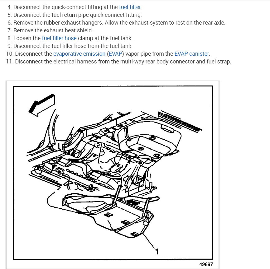

I am having trouble with my car starting. It will turn over but not start. We have to replaced the fuel pump and the Relay.
Wednesday, June 24th, 2009 AT 12:08 PM
2 Replies
RACEFAN966
  • 5,029 POSTS

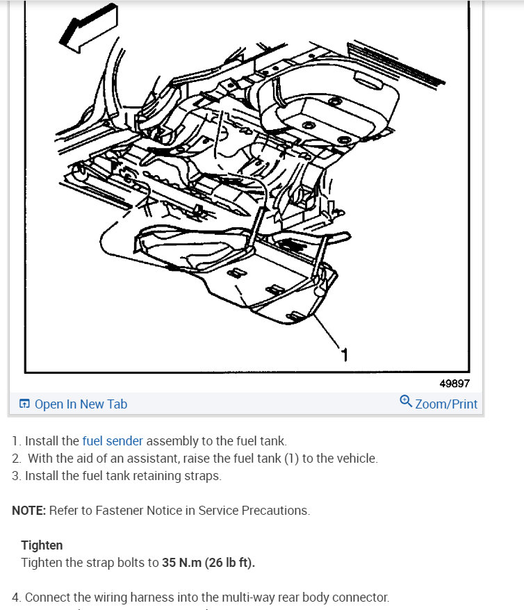

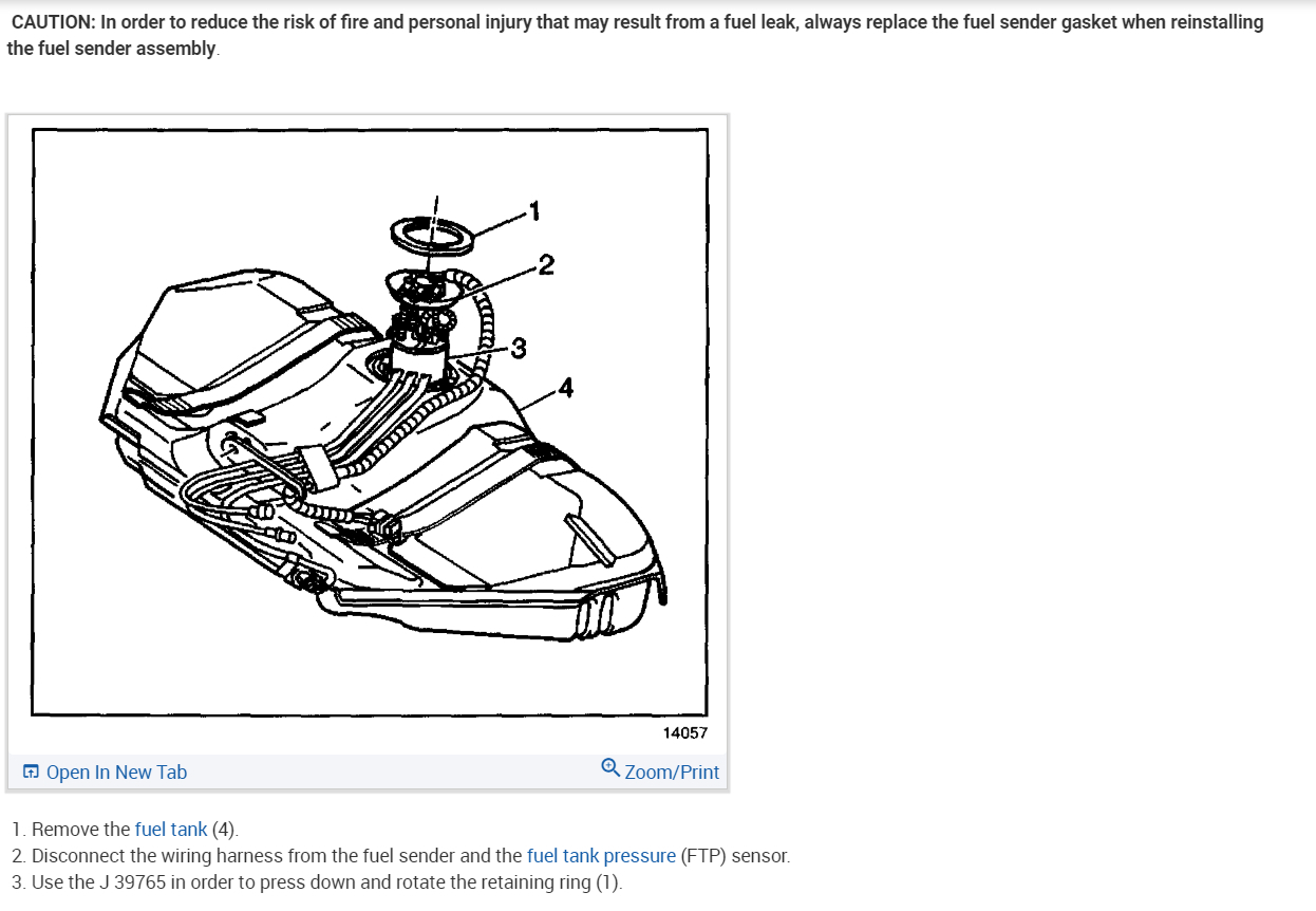

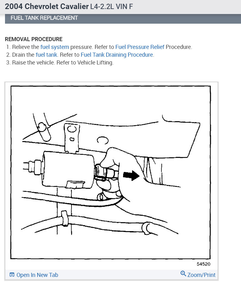

I would first check the fuel pump injection fuse. It is in the fuse box inside the car and is a 15 amp fuse. If that's okay the fuel pump replacement instructions are below in a guide to show you step by step with diagrams below to show you how on your car.
https://www.2carpros.com/articles/how-to-replace-an-electric-fuel-pump
Wednesday, May 12th, 2021 AT 2:03 PM
CARRIEMILLSAP
My grandpa checked everything that you told us to do on the last reply and it got power to all the wires. But the car is still not working. What next
