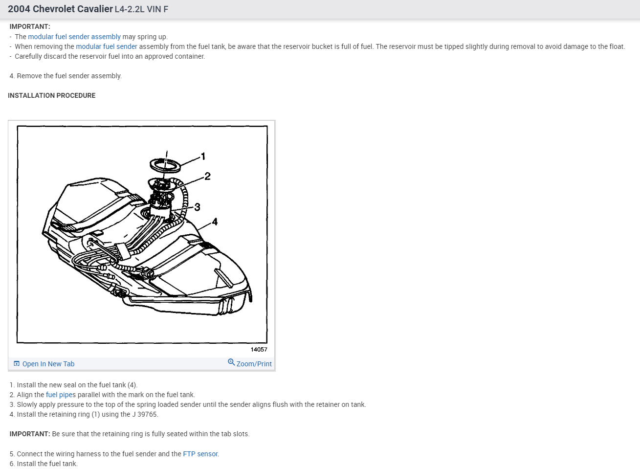

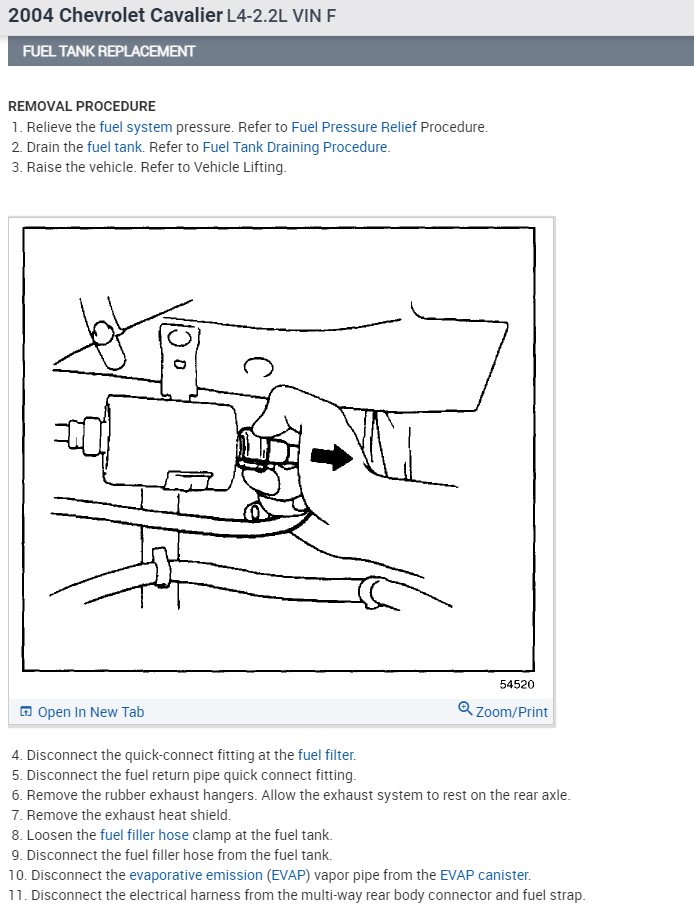

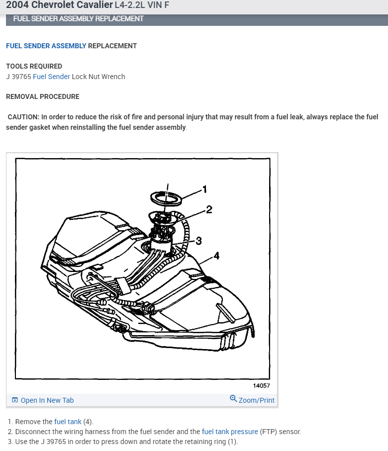

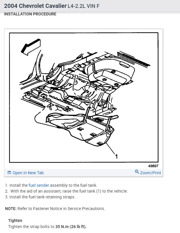

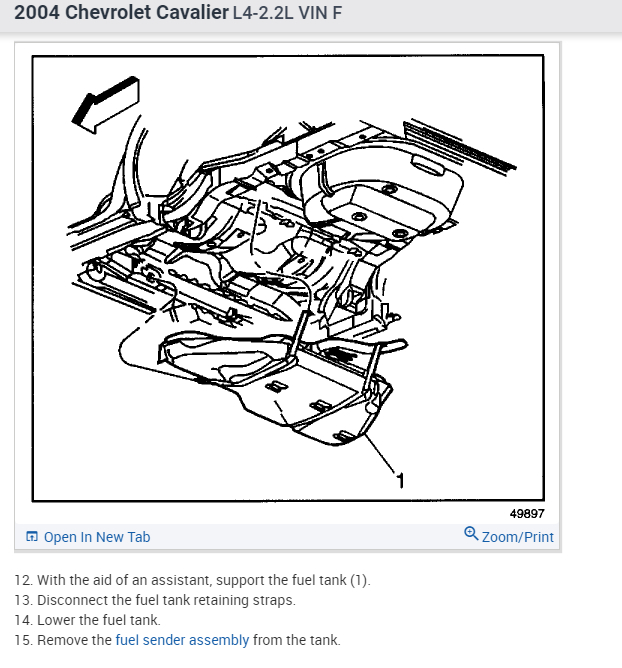

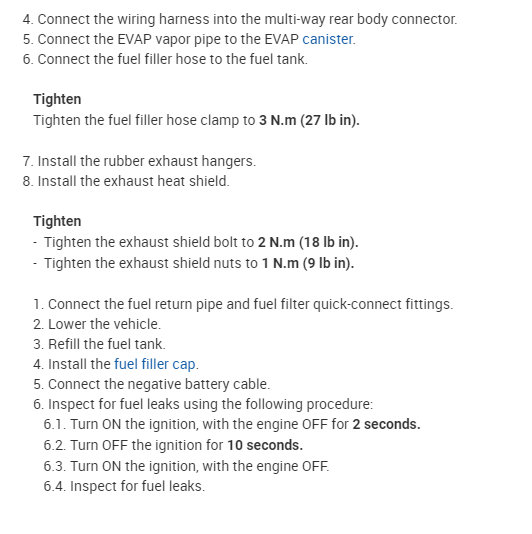

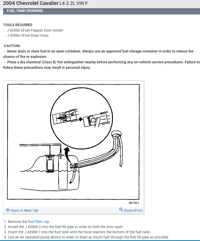

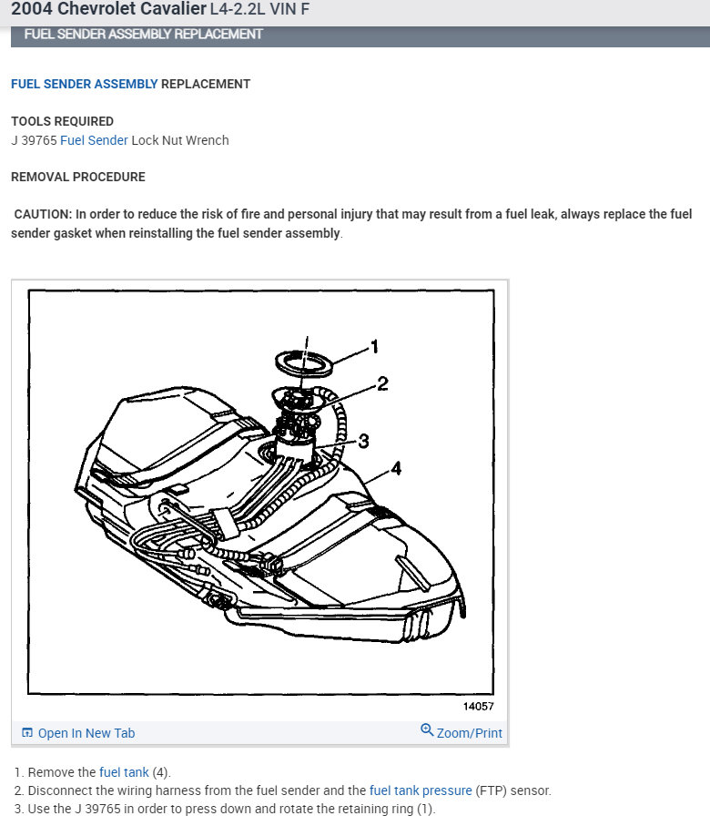

instructions on how to remove the fuel pump?
Oct 15, 2009 at 5:37 AM
SQM
  • 6,383 POSTS
In order to replace the fuel pump, first the fuel tank must be removed from the vehicle.
It is a good idea to drain the fuel tank before removal.
Here is a helpful guide:
https://www.2carpros.com/articles/how-to-replace-an-electric-fuel-pump
