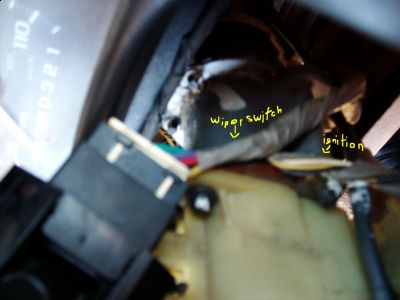

Okay, i just checked the the wires coming from the wiper switch wire harness to the ignition and there is no brown wire it is one yellow,one black and one off white. I tested these three wires just now and none of them show any signs of power. i figure that yellow is power, white is common, and black is ground. the thing that gets me is that it plugs into the ignition but the car starts and runs unless power only flows through the ignition wires when you start it up and stops when the car starts?

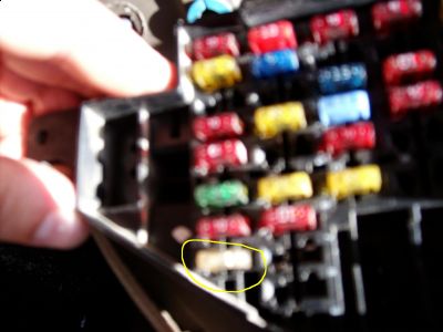

do you have any way of taking a picture of your fuse box and sending it to me?
Jul 1, 2009 at 11:18 PM
GREENCHEVYMALIBU
  • 230 POSTS
yes i can get a picture tomorrow. Let me take a stab at it again. you want me to just test jump the fuses? take the fuse out of the radio and take a wire with a twenty five amp fuse and jump it to the wiper fuse?
Jul 2, 2009 at 12:31 AM
BUDDYCRAIGG
  • 2,262 POSTS
we are not understanding each other.
please take a picture of the fuse box
Jul 2, 2009 at 12:37 AM
GREENCHEVYMALIBU
  • 230 POSTS

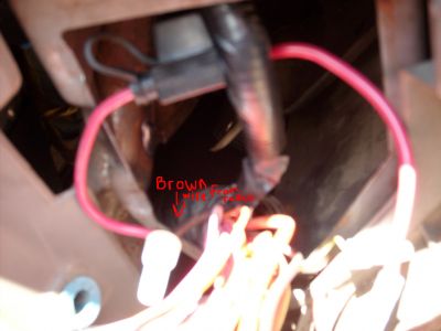

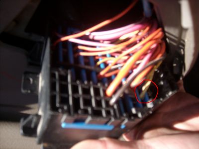

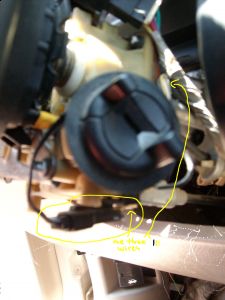

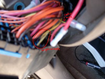

https://images.2carpros.com/forum/automotive_pictures/376352_brown_wire_radio_2.jpg
https://images.2carpros.com/forum/automotive_pictures/376352_radio_wiper_1.jpg
https://images.2carpros.com/forum/automotive_pictures/376352_the_three_wires_2.jpg
https://images.2carpros.com/forum/automotive_pictures/376352_two_yellow_1.jpg
https://images.2carpros.com/forum/automotive_pictures/376352_wiper_fuse_1.jpg
https://images.2carpros.com/forum/automotive_pictures/376352_wiper_switch_and_ignition_1.jpg
Jul 2, 2009 at 2:13 PM
BUDDYCRAIGG
  • 2,262 POSTS
is that add on fuse for your radio?
. . . . but back to your problem. I was going to draw lines and fuses and stuff on the picture of your fuse box, but I see that you have really good access to the back of the fuse box. Use one of those add on fuses to go from the brown wire to the yellow wiper wires. And all should be right with the world.
Jul 2, 2009 at 2:37 PM
GREENCHEVYMALIBU
  • 230 POSTS
so just get another add a fuse and add it to where i spliced brown and connect the other side to the yellow wires and put in a twenty five amp fuse. I will do that tomorrow and tell you the results thanks for the help.

GREENCHEVYMALIBU
  • 230 POSTS

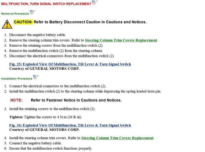

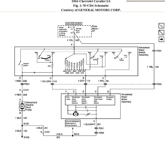

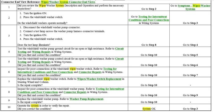

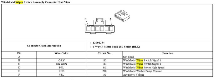

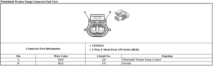

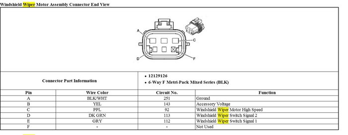

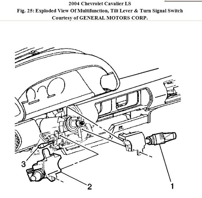

DRCRANKNWRENCH
  • 3,380 POSTS
There are a few possibilities for failure;
The wiper motor is bad.
The wiper switch has failed.
To replace the wiper motor is not to bad. it all depends on the windshield cowl and how hard it is to remove and replace.
First, test the wiper motor. I am giving you all the schematics, connector Identification and diagrams you will need to do this.
Use the wiring schematic and connector identification to find the positive twelve volts and ground terminals on the wiper motor. Hook up some test leads from your battery and see if wiper motor works.
Also, follow symptom diagnostic sheet to make sure everything else is okay so you can rule out the motor and go on to replacing the switch.
Let me know if you need any more help with this.
