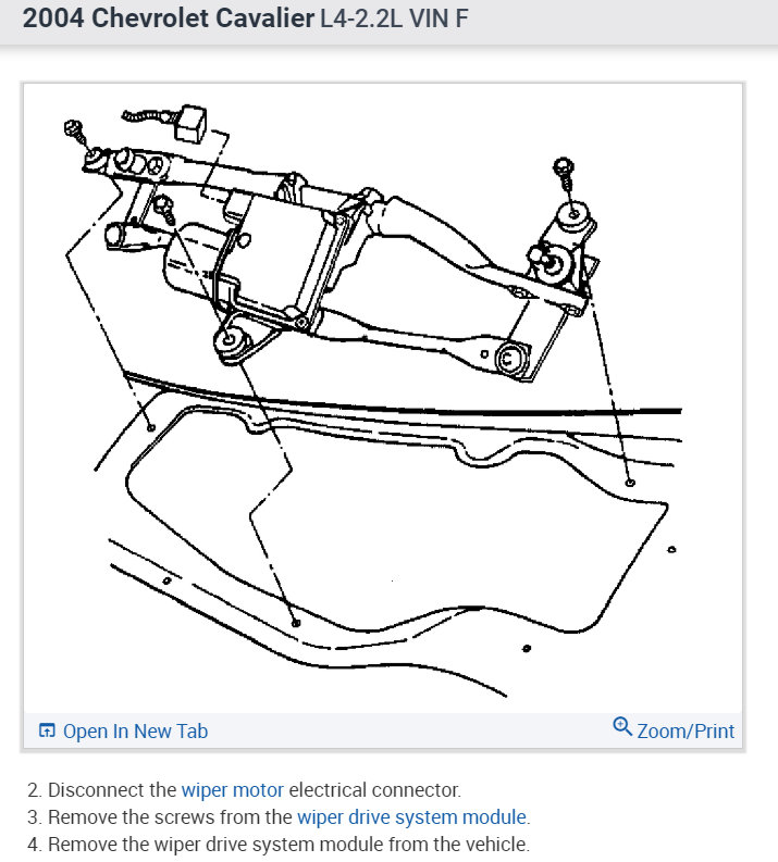

Remove protective cap on base of wiper arm and see if the nut that holds it to wiper trans is loose. If so tighten nut, if the nut is tight the control rod that works the drivers side came off here is a diagrams so you can see what I am talking about. Check out the diagrams (Below). Please let us know what you find. We are interested to see what it is.

The above person has a legitimate answer, but his answer is no where near what the root of my problem was. The problem I came across was not the nut but is the actual bushing which snaps onto the ball joint on the wiper motor arm. The arm is held in place by some cheaply made plastic. I have a 1985 VW and the wipers still work (go figure), the overall design of the wiper system is pretty bad by Chevrolet standards. It is simply bad engineering on that specific part.

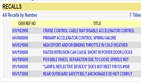

By the way, it looks like you may have some recalls on your vehicle. The dealer may fix these for free. Please contact the dealer service department, give them the VIN number of your car and have them check on these to see if they apply to you.
https://www.2carpros.com/forum/automotive_pictures/248015_Recalls_16.jpg
