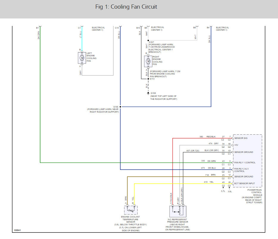

radiator fan stopped working what should i do?
Oct 25, 2008 at 2:08 PM
TEAG
  • 158 POSTS
First of all. Check to make sure the fan motor is good. To do this you need to disconnect the fan and run jumper wires to the battery. If the fan works when you hook it up to the battery, the fan motor is good and you need to check and replace the fan switch relay. Here is a guide to help you with the cooling fan wiring diagrams below to show you how the system works and fuse with relay locations.

Cooling fans not working. I replaced the (3) relays 1 month ago and the fans worked. Driven less than 200 miles. Very hot day yesterday 90 mile trip, again they are not working. I replaced the relays again and now they are NOT working. AC not used. Fans wont turn on! Car tested on computer last week and no codes came up for cooling sys. Could this be a wiring issue? RM in heat!
Sep 5, 2019 at 4:25 PM (Merged)
  • 75,992 POSTS
Power the cooling fan from the battery if i comes on-check and test the coolant temperature sensor/switch if okay-could be a wiring problem or the computer controlled of the fan relays circuit

Oh yes, I replaced the cooling sensor 1st(underneath water pump). Where does the fan relay wires ( from fusebox) hook to the ECU?
  • 75,992 POSTS

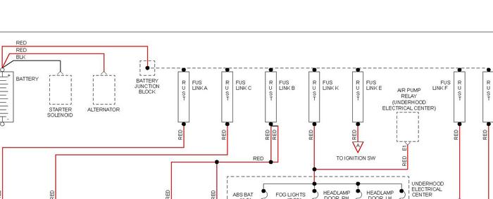

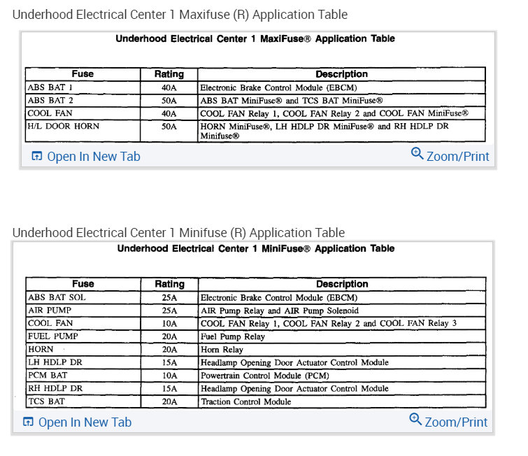

Check and test fusible link C this is the one that powers the fan relays
REGEN MOORE
  • 8 POSTS

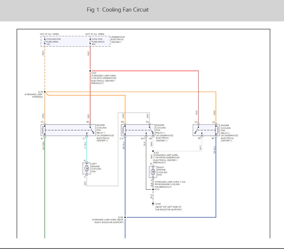

Do you havde a diagram/ Schematic? I am so grateful.
  • 75,992 POSTS
I don't have the diagram I've checked it -not available
REGEN MOORE
  • 8 POSTS
where do I test this? Location? Link C?

  • 75,992 POSTS
Check at the battery junction block

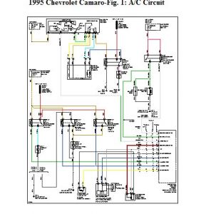

There is no air blowing through the ac vents when I turn on the ac. The switches work because I can hear the compressor turn on, but the fans not? On the relays there's coolant fan #1,2,3 and air pump, which one is it? Also where do I check the fuse for it? Where's the fan located? Thanks!
Sep 5, 2019 at 4:26 PM (Merged)

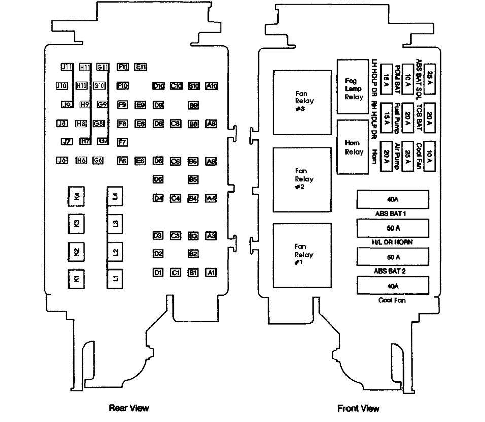

HMAC300
  • 48,601 POSTS
i'm sending a diagram that shows where the stuff is that you want. you will be able to copy it and blow it up for easier viewing. Your relay for the blower is under the dash on the left tunnel. also check your grounds under the kick panel as well as your resistor as that may be bad as well. the resistor should be on the heater box as well as the blower motor. but check the blower motor for getting ower if it is it's a bad ground or the motor isn't any good.
https://images.2carpros.com/forum/automotive_pictures/406719_blower_relay_1.jpg

4THGENZ28
  • 10 POSTS
The signal between the temp. sensor and the PCM are not triggering the relays, apparently.
If you have A/C, turn it on and see if you have low speed fan operation with the engine running....CAUTION: Be careful about not tangling with the serpentine belt, while you are feeling for the air in front of the alternator's location.
This is a good time to have the diagnostics performed rather than guess and pay for parts that, when replaced, don't solve the problem. Check continuity between the coolant temp. sensor connector and the PCM Harness connector with a Volt-Ohm Meter (VOM) set to 20k ohms and the PCM fuse removed from the fuse block in the engine compartment. Also check the PCM's ground wire usually attached to the ignition coil bracket mounting stud. (Your Z28 may be different.)
DO NOT energize the ignition circuit or any PCM-related sensors, at any time while testing for continuity of the PCM circuitry or PCM wiring harness connections!!! Permanant and VERY EXSPENSIVE damages may result.
If you DO have a faulty PCM; chances are, it is going tho be a $1.50 voltage feedback resister, the ONE that receives the signal from the coolant temp. sensor, and sends that signal (with a revised value) on to the PCM logic circuit FOR INTERPRETATION, that probably needs to be replaced by a electronics tech and you'll get your PCM back for about $130 because they don't have an exchange program, and you get to park your car for the 2 or 3 weeks it takes for turn-around...
Better hope that isn't your problem! :(

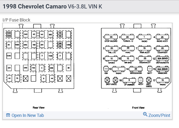

check your fuses and make sure they are not blown
Sep 5, 2019 at 4:27 PM (Merged)
SAMARKY2
  • 6 POSTS
I checked the fuses and none were blown.
