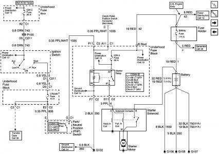

i have 99 chevy S-10 blazer 4wd, 4.3L v-6 auto matic tran, 114,000miles, My blazer wasn't starting i pulled the old starter and had it check and it was bad, got a new one and replace, and this was won't start the blazer, took that starter back and got a brand new start not reman, and now the blazer still won't start. i have checked all connection the the starter and battery, would you have any ideas or know what steps to try and troublrshoot this problem

check crank fuse,ignition 40amp fuse,and starter relay.
https://images.2carpros.com/forum/automotive_pictures/102900_starting_1.jpg
