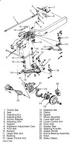

what size wrenches , sockets do i need to change hub assy on my blazer ?? thanks dan
May 14, 2021 at 12:12 PM (Merged)
MERLIN2021
  • CAR REPAIR CONTRIBUTOR
  • 17,250 POSTS
If I remember right the axle nut is 30mm and the three bolts that hold it on are 15mm here's how: Page 1 of 1 WHEEL HUB & BEARINGS Removal 1.Raise and support vehicle. Unload tension on torsion bar. See TORSION BAR. Remove wheel and tire assembly. Apply brake pedal. Remove axle shaft nut and washer. Remove rotor. See Fig. 1. Using brass drift and hammer, disengage axle shaft from wheel hub and bearing. NOTE: Darkened areas on bearing assembly are caused by heat treatment process and do not indicate a need for replacement. 2.Remove wheel speed sensor. Remove wheel hub and bearing from steering knuckle. Remove splash shield and bearing seal. Installation 1.To install NEW wheel hub stud, lubricate hub bore and install stud. Place 4 washers onto stud and install stud nut with flat side to washers. Tighten stud nut to draw stud into hub bore. Remove nut and washers. Install hub and bearing assembly onto axle shaft. 2.To complete installation, reverse removal procedure. Tighten bolts and nuts to specification. See TORQUE SPECIFICATIONS . Depress brake pedal several times to extend caliper piston after installation. 6/9/2009
https://images.2carpros.com/forum/automotive_pictures/62217_blaza_2.jpg
https://images.2carpros.com/forum/automotive_pictures/62217_blaz_1.jpg
LINKONCOLT
  • 14 POSTS
it is 35 mm or 1 3/8

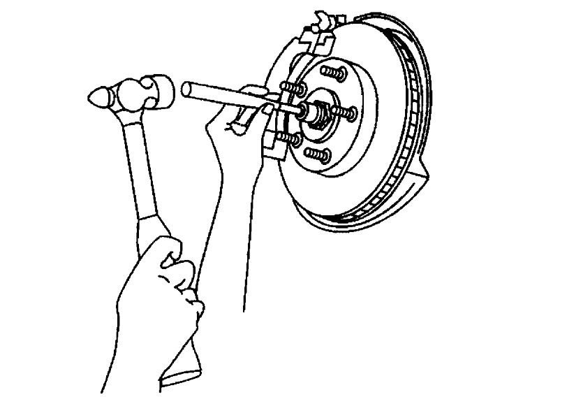

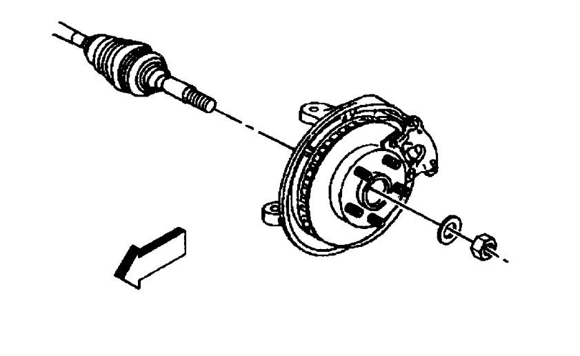

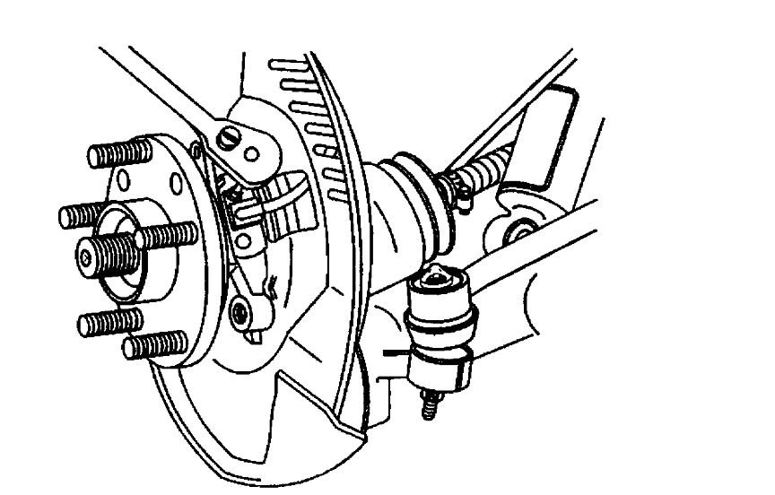

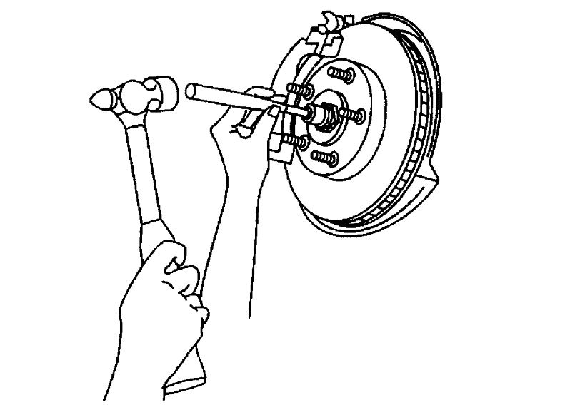

Removal Procedure
1. Raise and support the vehicle with safety stands. Refer to Vehicle Lifting.
2. Unload the torsion bar. Refer to Torsion Bar and Support Assembly Replacement
3. Remove the tire and the wheel. Refer to Tire and Wheel Removal and Installation in Wheels, Tires and Alignment.
4. Apply the brake pedal.
5. Remove the drive axle nut.
6. Remove the drive axle washer.
7. Remove the rotor. Refer to Brake Rotor Replacement - Front in Brakes and Traction Control.
8. Disengage the halfshaft from the wheel hub and bearing assembly. Place a brass drift against the outer end of the halfshaft in order to protect the halfshaft threads. Sharply strike the brass drift with a hammer. Do not attempt to remove the halfshaft from the hub and bearing assembly at this time.
9. Remove the wheel speed sensor mounting bolt from the wheel hub and bearing assembly.
10. Remove the wheel speed sensor from the wheel hub and bearing assembly.
11. Remove the wheel hub and bearing assembly to the steering knuckle mounting bolts.
Important: Lay the wheel hub and bearing assembly on the hub bolts on the outboard side. This prevents damage or contamination to the bearing seal.

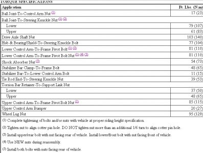

I am also including the remove and replace procedures. If you don't have a torque wrench maybe borrow your son's for the reassembly. The right torque is important. Good luck! Let us know how it turns out!

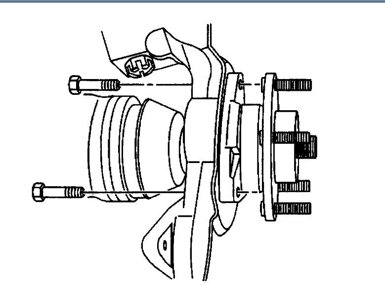

This is the install:
Installation Procedure
1. Install the wheel hub and bearing seal to the wheel hub and bearing assembly.
2. Install the splash shield to the steering knuckle. Align the shield to the steering knuckle.
3. Install the wheel hub and bearing assembly to the steering knuckle. Align the threaded holes.
4. Install the wheel hub and bearing assembly to the steering knuckle mounting bolts.
^ Tighten the wheel hub and bearing assembly to the steering knuckle mounting bolts to 105 Nm (77 ft. lbs.).
5. Install the wheel speed sensor to the wheel hub and bearing assembly.
6. Install the wheel speed sensor to the wheel hub and bearing assembly mounting bolt.
^ Tighten the wheel speed sensor to the wheel hub and bearing assembly mounting bolt to 18 Nm (13 ft. lbs.).
7. Install the rotor. Refer to Brake Rotor Replacement - Front in Brakes and Traction Control.
8. Apply the brake pedal.
9. Install the drive axle washer.
10. Install the drive axle nut.
^ Tighten the drive axle nut to 140 Nm (103 ft. lbs.).
11. Install the tire and the wheel. Refer to Tire and Wheel Removal and Installation in Wheels, Tires and Alignment.
12. Load the torsion bar. Refer to Torsion Bar and Support Assembly Replacement
13. Lower the vehicle.
