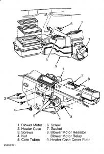

BLUELIGHTNIN6
  • 16,542 POSTS

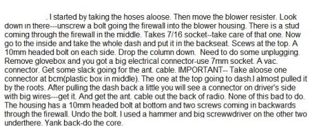

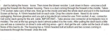

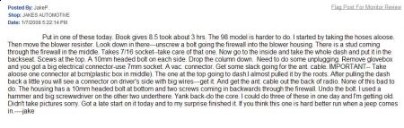

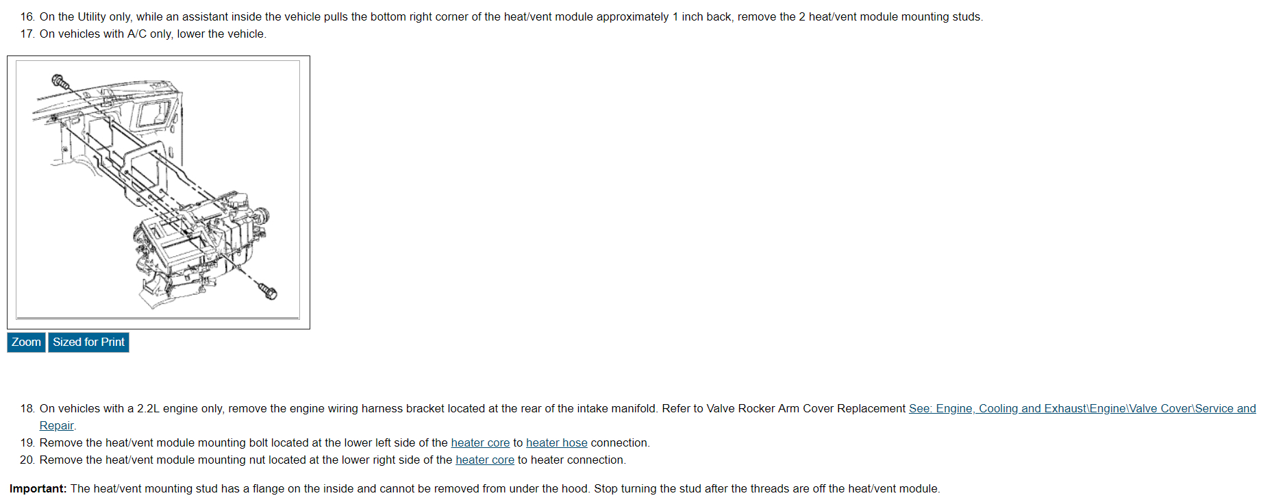

Here's a tip to give your repair person.
" I started by taking the hoses aloose. Then move the blower resister. Look down in there---unscrew a bolt going the firewall into the blower housing. There is a stud coming through the firewall in the middle. Takes 7/16 socket--take care of that one. Now go to the inside and take the whole dash and put it in the backseat. Scews at the top. A 10mm headed bolt on each side. Drop the column down. Need to do some unplugging. Remove glovebox and you got a big electrical connector-use 7mm socket. A vac. Connector. Get some slack going for the ant. Cable. IMPORTANT-- Take aloose one connector at bcm(plastic box in middle). The one at the top going to dash.I almost pulled it by the roots. After pulling the dash back a little you will see a connector on driver's side with big wires---get it. And get the ant. Cable out the back of radio. None of this bad to do. The housing has a 10mm headed bolt at bottom and two screws coming in backwards through the firewall. Undo the bolt. I used a hammer and big screwwdriver on the other two underthere. Yank back-do the core"
See if that helps them out.

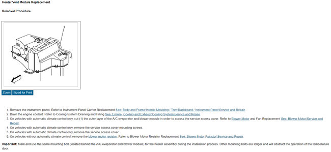

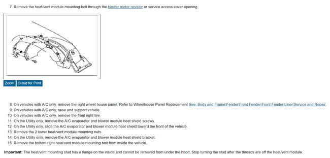

BLUELIGHTNIN6
  • 16,542 POSTS

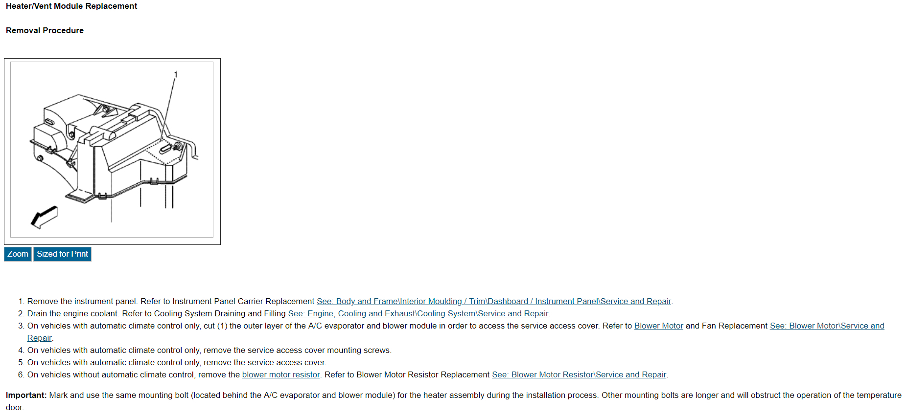

Heres the best way to describe how to replace heater core in a 2000 blazer..

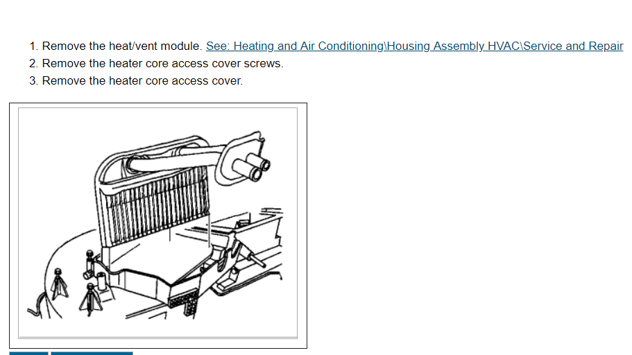

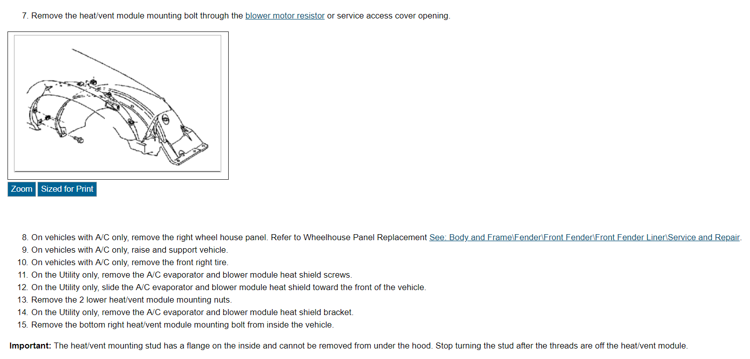

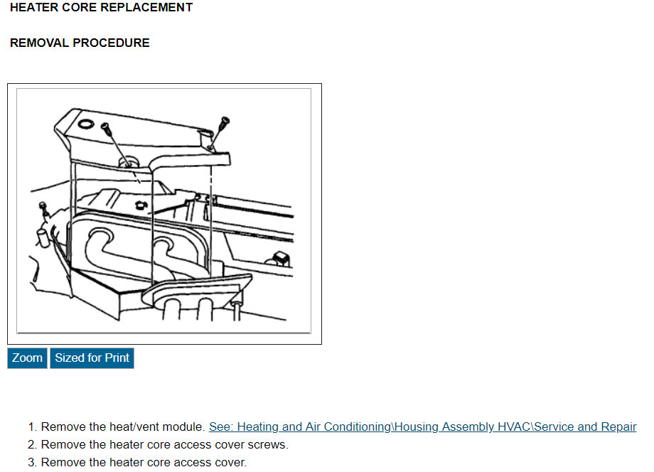

BLUELIGHTNIN6
  • 16,542 POSTS
https://www.2carpros.com/forum/automotive_pictures/261618_Noname_1999.jpg

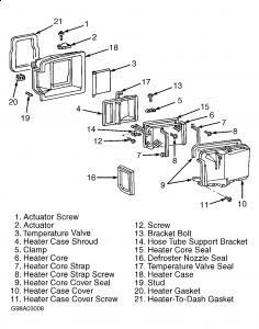

DRCRANKNWRENCH
  • 3,380 POSTS

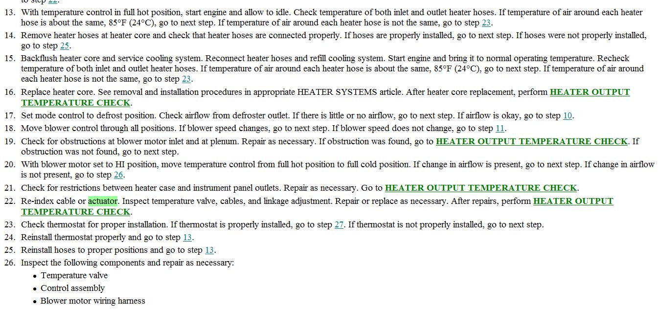

There is a heater actuator that lets either coolant in the core and/or opens the vent door for the heat. You will find controlling vacuum pots, cables and actuators on the heater box under the center of the dash. I am attaching instructions for low heat output. When it says heat output test that just menas is it putting out hot air.
