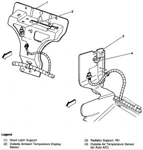

On the right side (passenger) of the radiator support there is the outside ambient temp sensor. You need to look for two wires DK Green with a white stripe and a black wire. Now with you meter simply unplug it and ohm the sensor. Now get back to me with the ohms and the air temp at the time you check it ok. We will go from there.
Thursday, July 16th, 2020 AT 10:07 AM (Merged)
MICKER11
  • 8 POSTS
I located a small black box looking item mounted to the bottom of the radiator support 2 wires to it I assume that I found the right part. Has a yellow and black wire running to it (maybe the wire is faded?) The reading to it is 998 with the ohm meter set at 2000 ohm setting. The outside temp is 80 degrees thanks
RACEFAN966
  • 5,029 POSTS
Ok if that was the ambient temp sensor then it way out of spec. Now I have included a pic of where it is and what it should look like just to be sure.
Location
https://www.2carpros.com/forum/automotive_pictures/249564_Outside_Temp_Sensors_2.jpg
Sensor
https://www.2carpros.com/forum/automotive_pictures/249564_276571_1.jpg
MICKER11
  • 8 POSTS
Thanks for the pic I had tested the wrong part. The sensor gave no reading on the 200 or 2k settings. On the 20k setting it gave a reading of 7.36 at 90 degrees im sure I tested the right part this time (green and black wire running to it) thanks
RACEFAN966
  • 5,029 POSTS
Ok at that temp it should read about 3900 ohms so it looks like that sensor is no good. When you tested it you just unplugged it and ohmed the sensor not the wire harness? If that is correct then it is bad. These are available at you local parts stores so there is no need to go to the dealer unless there price is better. Let me know how it goes.
