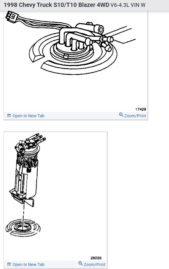

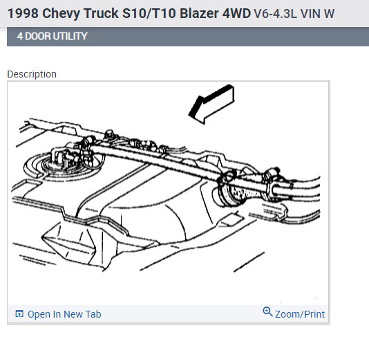

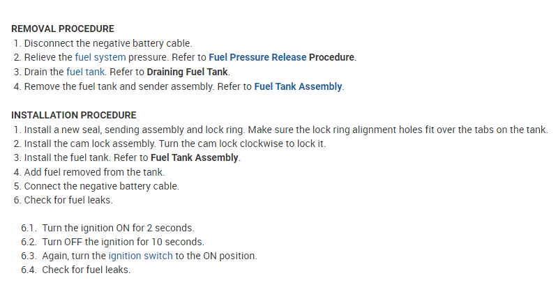

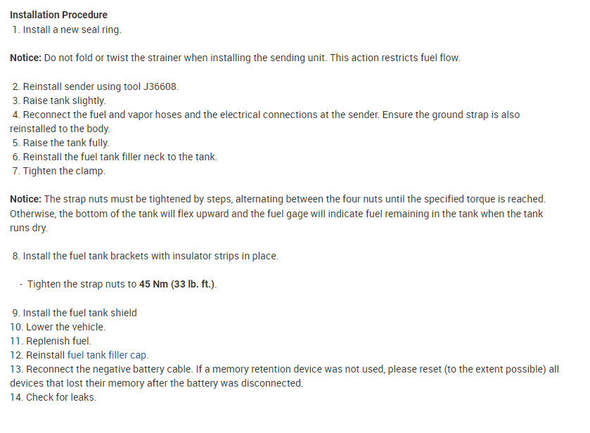

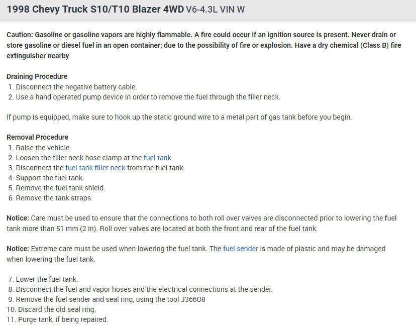

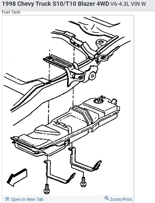

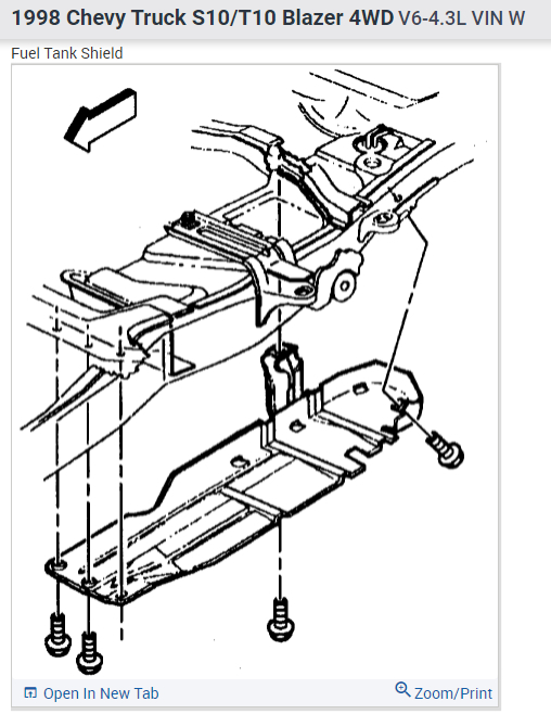

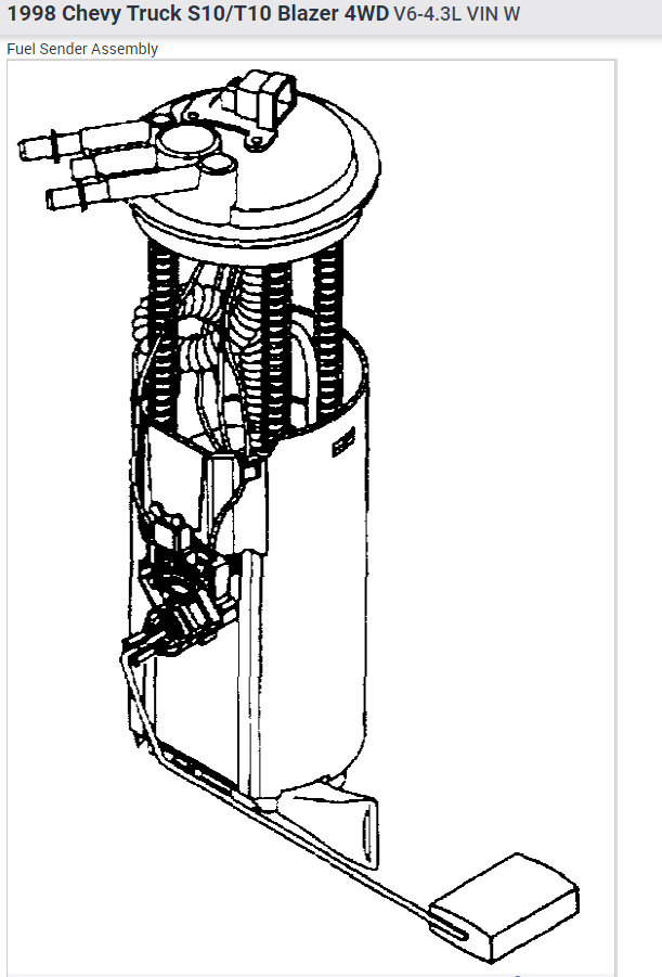

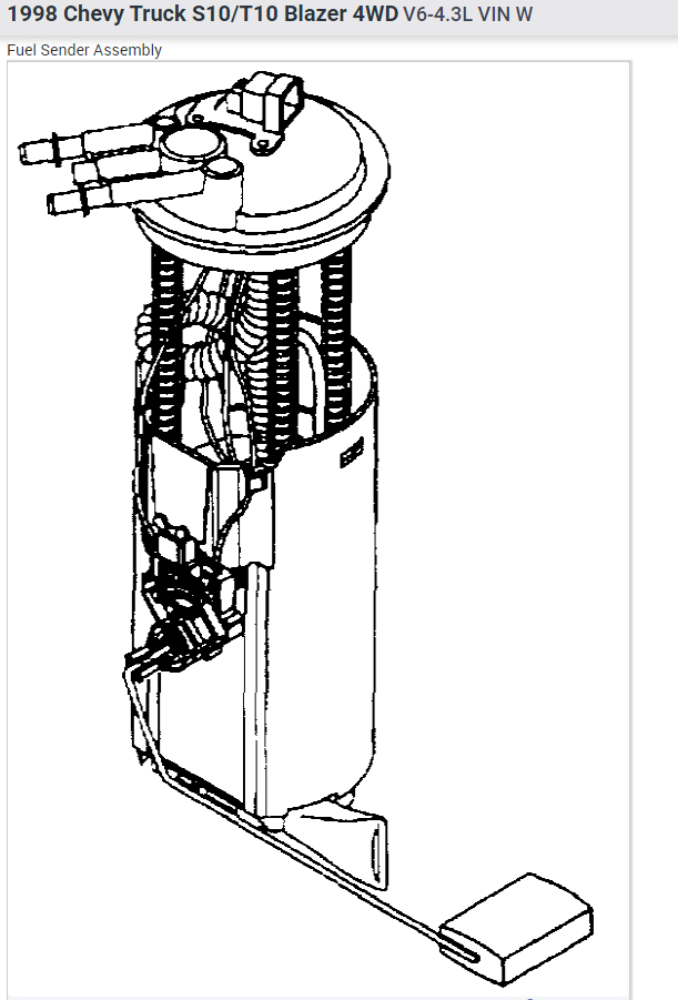

In order to replace the fuel pump, the fuel tank needs to be removed, as the pump is located inside the tank.
Here is a helpful guide:
https://www.2carpros.com/articles/how-to-replace-an-electric-fuel-pump
Those fuel pumps can cost between $80.00 to $140.00 depending on the brand.
As for the installation it will vary as each shop has different labor rates.
It is always a good idea to call a few shops to choose the best option.
I have attached diagrams for the fuel pump replacement procedure below for your reference.

How do I change the fuel pump and drop the gas tank on my Chevy Blazer?
Monday, October 28th, 2024 AT 5:55 PM (Merged)
  • 109,755 POSTS
Make sue the fuel tank is as close to empty as you can get it. Disconnect the battery, remove the mounting straps from the tank and the tank will drop down and out. I would suggest using a floor jack to lower the tank. It could be heavy. The fuel pump is on the top with one large retaining clip holding it in. Remove the clip and the pump comes out.
If you have other questions, let me know.
