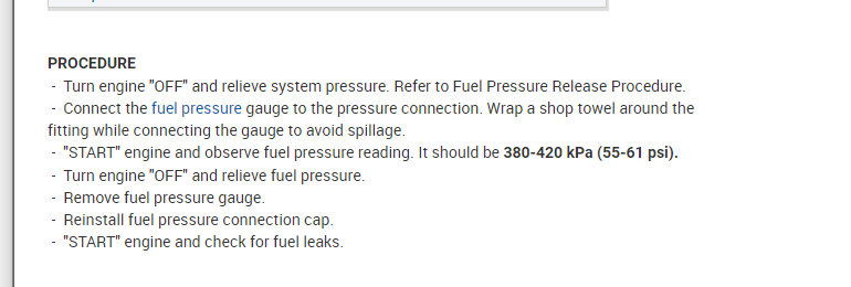

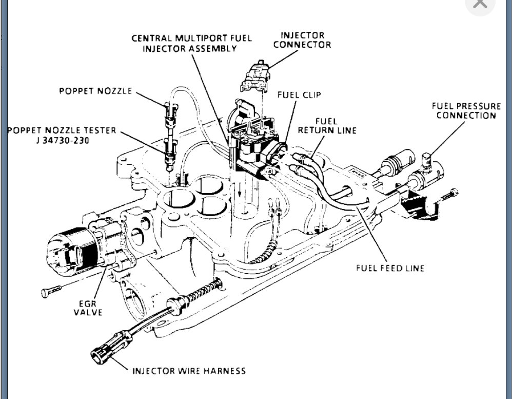

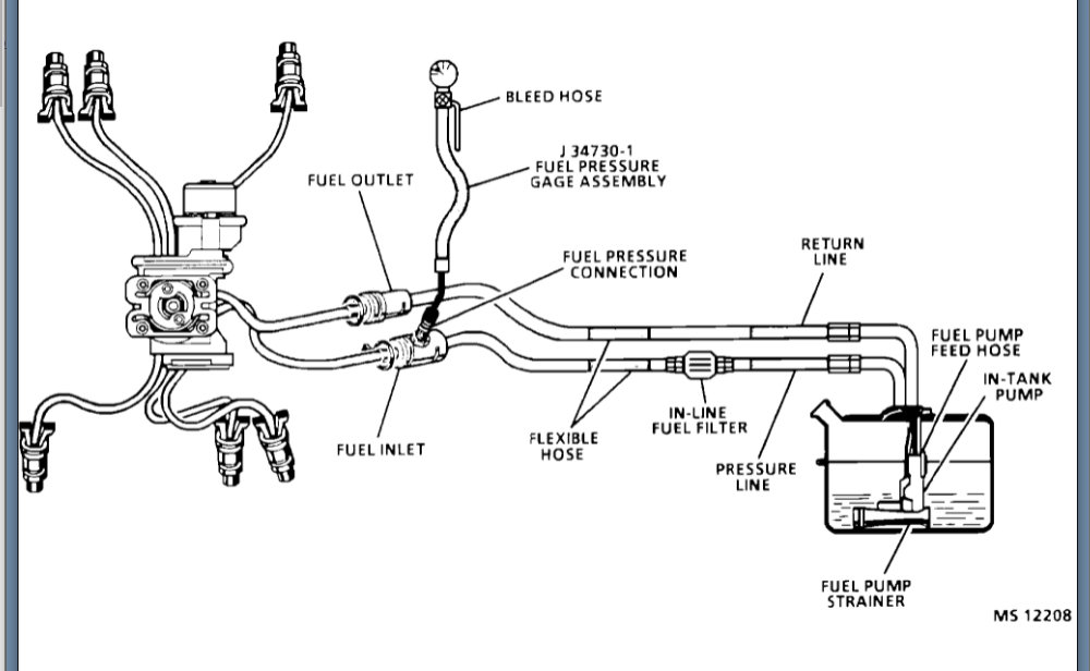

When you checked the pressure, what was it? The only reason I ask is the pressure needs to be around 60 PSI which is much higher then most cars of this age.
If you are relieving the pressure and it starts then the only thing I can think is you may be getting some sort of vapor lock when the system is hot. This could be due to the return line being plugged so we need to start with the pressure when this is not starting.
If it is starting normally then it will not show any issues.
Below you will see the info from the system and how to check the pressure and spec on proper pressure.
Please let us know what you find with this and we can go from there. Thanks
