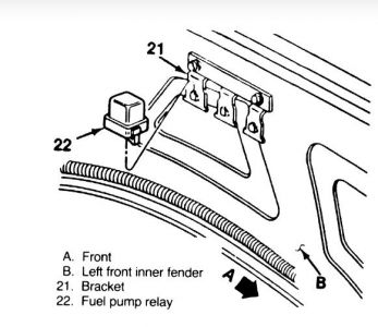

1993 Chevy Blazer 6 cyl 180000 miles
The fuel pump continues to stay on when the switch is turned off which is causing the battery to drain. What should I check and/or change?

It sounds like your fuel pump relay is bad. Here is how to change it. The fuel pump relay is normally found on a relay bracket which is mounted to the left front fender in the engine compartment. Positioning within the bracket will vary according to model and application. Check for loose electrical connections; no other service is possible, except replacement.
REMOVAL & INSTALLATION
See Figure 1
1.Disconnect the negative battery cable.
2.Disengage the relay/electrical connector assembly from the bracket.
3.Pull the fuel pump relay from the electrical connector.
https://www.2carpros.com/forum/automotive_pictures/307763_Noname_22.jpg
Fig. Fig. 1: Common fuel pump relay mounting
To install:
4.Install the fuel pump relay to the electrical connector.
5.Engage the relay/electrical connector assembly to the bracket.
6.Connect the negative battery cable.
