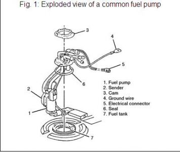

How do I remove the fuel pump from the gas tank. I have the tank dropped already but dont know to remove it from the tank.

Number 3 is a locking ring. I use a brass drift and a hammer to tap the locking ring counter-clockwise.
