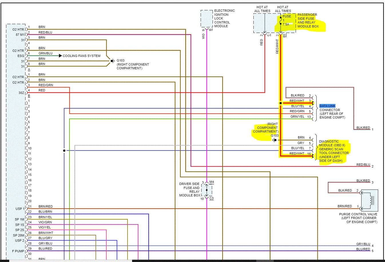

I bought the car listed above used. I do not know if check engine light will come on or not when starting. I only read in the manual that it does light up abs, esl, seat belt, srp but does it include Check Engine? Somehow it is affecting transmission of the car it is connected to transmission the RPM through CANBUS?

The vehicle does have a CEL. It should turn on when the key is first turned to the run position. Have you checked for diagnostic trouble codes? Is there power to pin 16 at the data link connector under the dash?
Let me know. Also, confirm there is power to fuse 1 in the fuse panel under the dash and the fuse is good. Additionally, confirm there is continuity to ground via pin 4 at the connector.
Let me know what you find.
See pic below.

sorry I forgot to mention the error code p0700- transmission control system request, it disappeared when I restarted the car. fuse 1 has power and pin 16. thanks for the electrical diagram it helped a lot. The negative terminal of the battery has to be removed before installing the busted bulb from the dashboard, the car is not in limp mode anymore, thank you very much.
