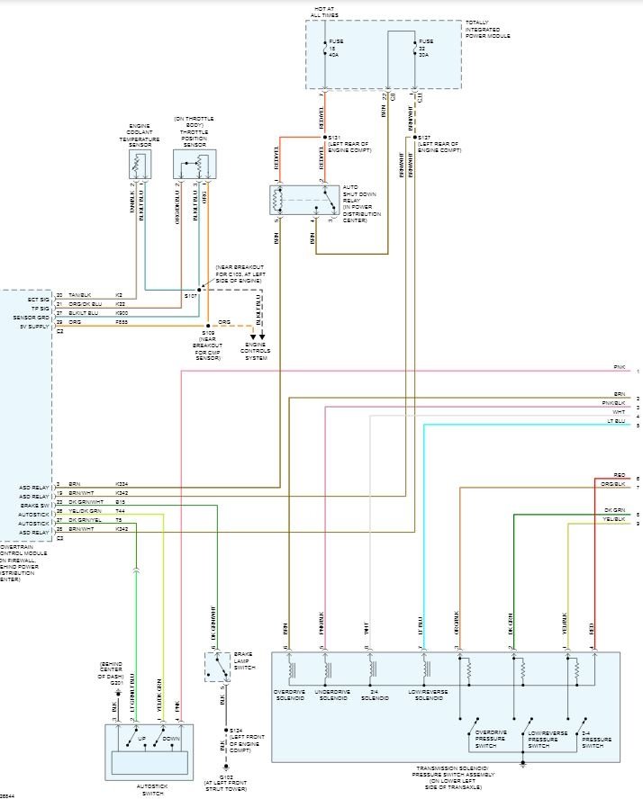

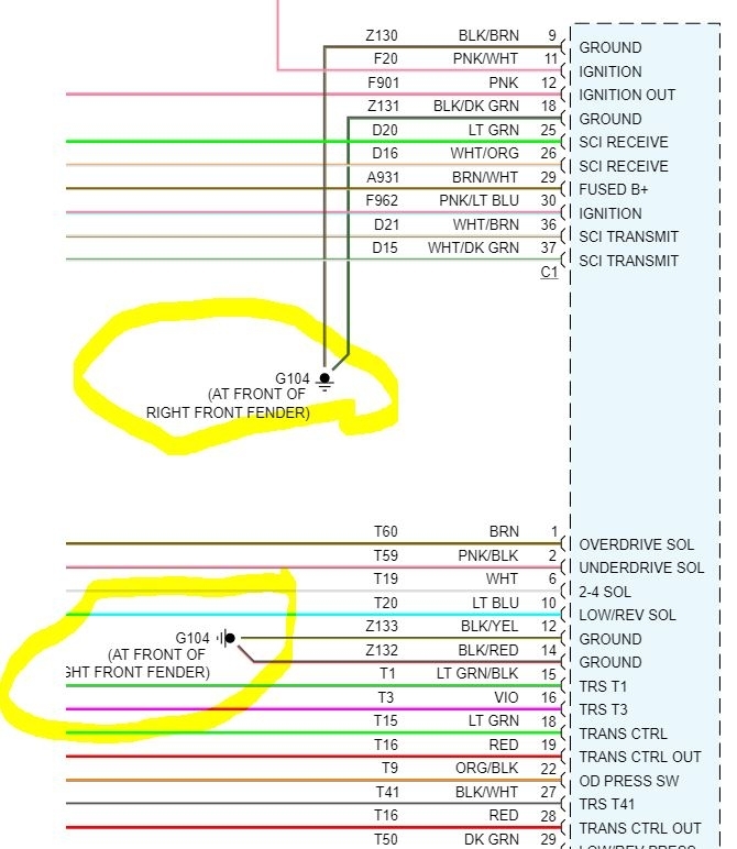

From the description you really need a dealer level scan tool to watch the various sensor signals on the transmission. The P0882 showed low power to the transmission control unit, which could be a wiring short, but it could also be a failed PCM. The P1603 and U0101 are codes relating to the transmission controller not being able to communicate with the PCM or internal faults of the PCM. So that also points to it either having no power or internal failure. The P0736 would make sense in that the transmission section of the PCM controls all of the shifting and gear changes using the pressure in the transmission. If it has a power issue or internal failure it would set codes like that. As to needing a dealer, not true, you just need a better shop that can actually do diagnostic work.
The other item is the leak into the connector, those can cause all kinds of issues because it will short wires that should never connect and send bad info or voltages into the PCM and cause it to fail.
I would check the powers and grounds for the PCM as Chrysler has had a lot of issues with both of those and either can cause problems. As it starts and runs, I suspect it is more on the ground side, all four of the transmission related grounds go to the same point as shown in the third image, those multi wire connections like to fail.

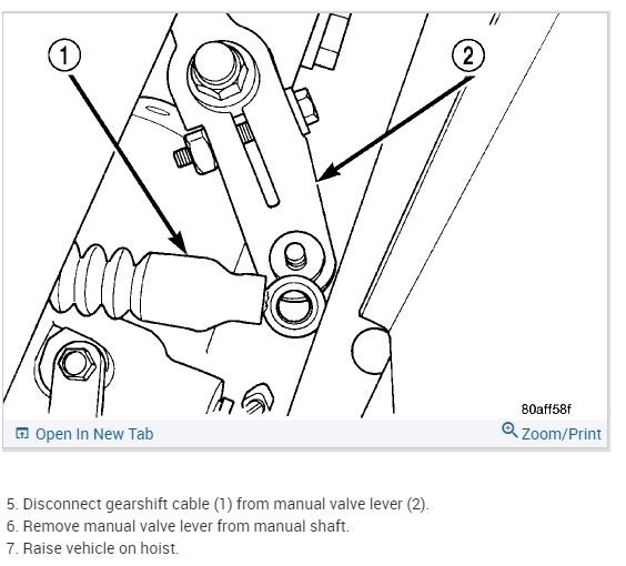

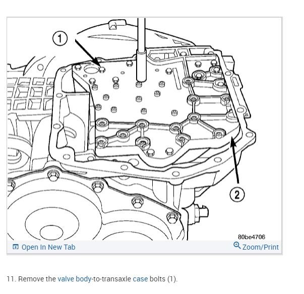

That description sounds like the solenoid isn't working, the kick in drive could be that it isn't engaging low gear and instead is starting out in second gear. With the old pack you had the error, but it worked in all gears, correct? If so, I would take a meter and test the solenoids for resistance, that can be done from the wiring connector. Take a meter set to resistance and connect one terminal to pin 4 on the transmission connector, then measure the resistance between it and pins 4,5,6 and 7 in turn. The readings at each one should be almost exactly the same. If that checks out, then it's likely that something got into the passage for reverse/low. If that is the case, then about the only way to get it out would be pulling the transmission pan and pulling the valve body apart to remove whatever is blocking the flow of fluid.

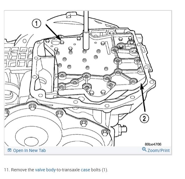

Removing it isn't really hard but it's messy.
First thing is to remove the battery and tray so you can get to the manual shift lever on the transmission. Make sure it is in low when you do that as it makes it easier.
Next you remove the pan and filter, next you remove the bolts that holt the valve body to the case. Now you need to grab the parking roller from the guide. Then remove the valve body. Tag the two accumulators that are in the case.
Before doing this though you need to be sure you have a scan tool available to do the relearn procedure. I might even try a relearn before you start pulling parts.

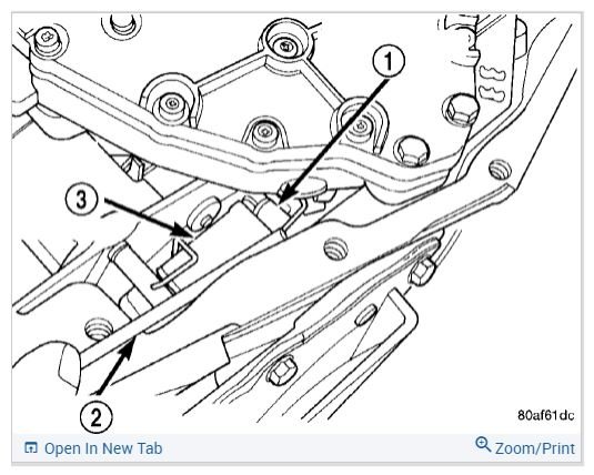

Can you expand on what you mean by grabbing the parking roller from the guide? I had a stripped bolt, but I finally made it this far. It is going to start pouring rain of course, working on my car is the Western rain dance, but I am so close. Thanks
Oct 23, 2021 at 8:19 AM
STEVE W.
  • 15,351 POSTS
There is a roller that sets at the end of the park lever inside the transmission, image attached. You need to remove it to get the lever out and not let it fall into the case and cause problems.

Well, I am glad I was messing with the right thing, but how do you get the roller off? Was out there on the wet ground for hours. The car won that battle. Thanks
Oct 23, 2021 at 2:55 PM
STEVE W.
  • 15,351 POSTS
Transmission should be in low to get it loose, but it doesn't hurt to move the linkage to get it to drop free. I would be sure to put a big sheet under the car if you are doing this with the transmission in the car as the removal of the valve body will drop the check balls free and they love to hide. I would also suggest getting the one-year subscription to Alldata DIY for that vehicle, it has the full-service info for this procedure as well as showing where each ball goes. Runs about $20.00 but only covers one vehicle, you can print or same images in higher resolution as well.

Hello Sir Steve, I have a question. So, When I took the cable off the manual lever and moved it to low, it was kind of a hard turn and skipped and clicked. I was under the car and had asked my husband to move it so I could better get to the rollers. When he did that, I could tell it moved a lot quicker and smoother. I wasn't sure how it was supposed to be but have since found out smooth and quick is the ticket. I am wondering if the problem could have caused it or if it caused the problem? Am I making sense, or have I finally lost it? lol What are your thoughts?
Oct 26, 2021 at 8:17 AM
STEVE W.
  • 15,351 POSTS
As long as the lever moves it will shift, but it's possible that whatever is causing the fluid issue is in the main control spool that the lever moves. I'm hoping that you pull the VB off and find a piece of gasket material in one of the check balls or sticking a piston open or closed. Then you can reverse the process and have a working vehicle again. Just don't be like this person...

Hello, I finally got it out! Then sat for hours trying to remove another seized screw. I woke up with a screwdriver in my hand. Anyway, should all the valves move freely? I guess I have to take them apart to clean them. I am trying to not get intimidated. I should be an expert in auto part photography by the time I am done.
Oct 28, 2021 at 7:36 AM
STEVE W.
  • 15,351 POSTS
Some will move free; others have springs and detent like spots where the fluid moves them. Hey, no sleeping on the job... LOL First thing will be to examine everything and look for crud that isn't supposed to be there, the fluid passages should be clear and only have clean fluid, it doesn't take much to bind up a shuttle valve or one of the spools. Take your time and if you hit a snag, take a break, or a shot. Transmissions use a bit of magic in the way they work. If you can clean out all the passages using a white rag to catch anything that might come out, if you clean it all and find nothing it's probably farther in or stuck in a passage.

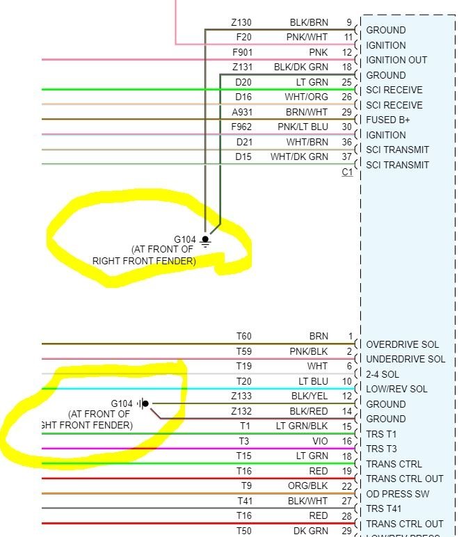

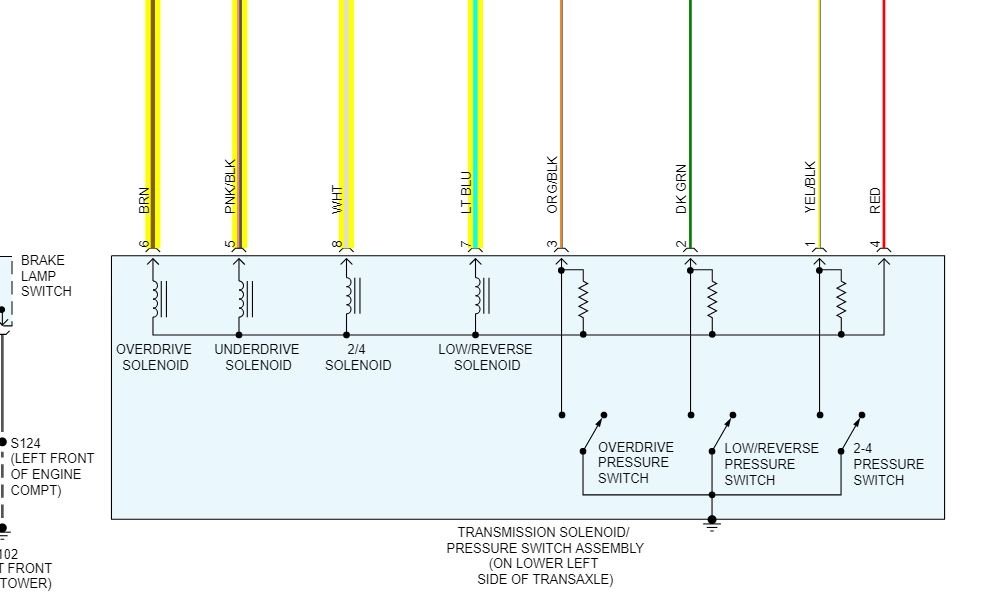

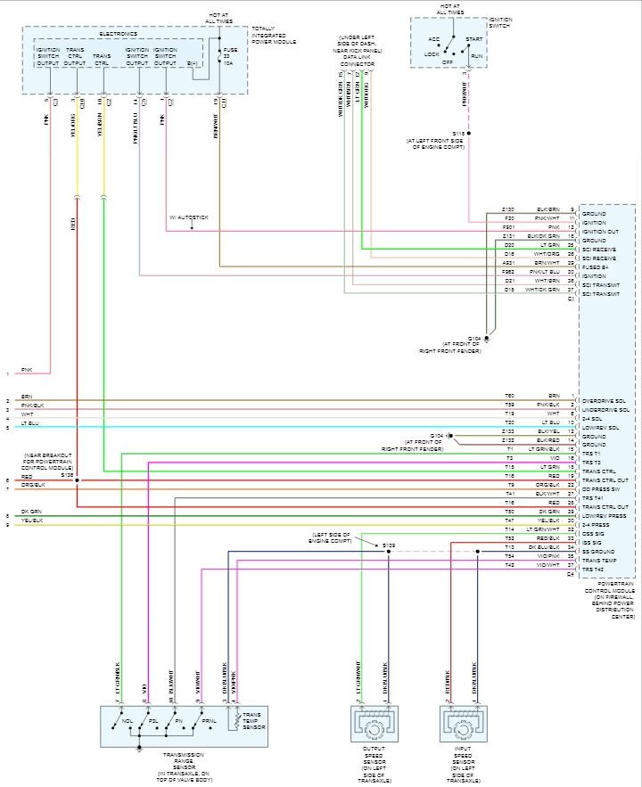

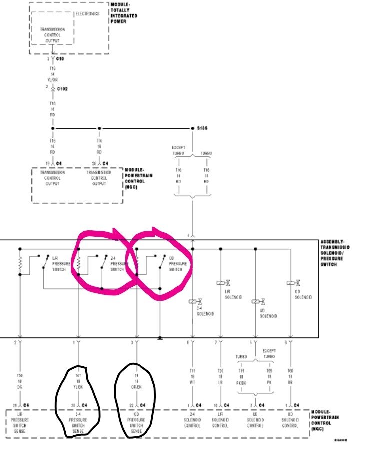

Well, those are all transmission codes. Basically, pressure in the transmission isn't correct and it's causing issues. Likely it is the reason for the stalling. I would start it and let it run a bit, then erase the codes and cycle through the gears again to see which ones come back.
The 846 (circuit B) and 871 (circuit A) are both pressure sensor circuit codes, the 732 is incorrect gear ratio, which basically means the PCM is seeing that the transmission is in a gear, but the output of the transmission isn't moving.
I doubt it's the new pack. It sounds more like something in the wiring, like corrosion or a pinched wire.
May 17, 2022 at 1:43 PM
DINA RODGERS
  • 30 POSTS
I have done your first suggestion, but one more time won't hurt. Might you have a direction as to what wires to start with? I checked many, many wires and connectors because of the p0882. Should I start there again? You know, I don't know that I can flush the fluid if the dang car isn't going into gear, can I? I haven't tried yet but removed the cooling line and got some fluid out and it doesn't look bad, I guess because half has already been changed. Just thought a flash would be good considering the work. Thanks for the quick get back.
May 17, 2022 at 3:58 PM
STEVE W.
  • 15,351 POSTS
If the engine runs, you get fluid flow as the pump is turning. To see if the issue is a faulty switch or two or if it's something internal you could use a meter to probe the switch outputs at the transmission connector. The switches should both be open with the engine running in park, as well as open when the engine is off with the key on. Ground one lead of the meter and probe the yellow with black and the orange with black wires on pins 1 and 3. With the key off you should read a resistance and not a direct to ground.
If you see a direct short, then there is a wiring problem or the switch you are testing is stuck closed.
Sorry to hear about the spouse. Sounds like he got hit like I did. Just paid off my bill last week, it was over 6 digits at the start.

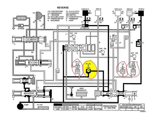

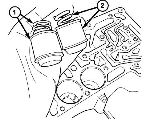

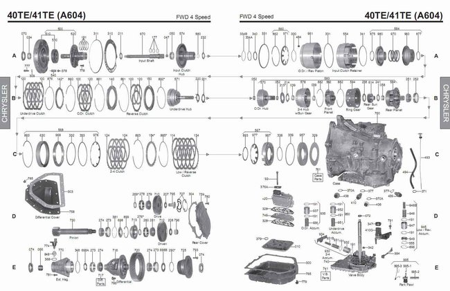

Good day to you sir, I hope all is well. So, today I did the flush. At first, the car did nothing when put in reverse, but the drive kicked in and actually moved but, when reverse started to kick but not kick in, it suddenly started stalling in drive. This was happening as I slowly added the fluid. Now that the fluid is at a good level the car does the die in drive thing. I am going to start testing wires, but I just wanted to ask if something like the od and ud accumulator springs could cause this kind of problem? When I dropped the VB the springs and accumulators went flying. No biggy except one has one spring and the other has two. I researched as best as I could and think I put them back where they belong. Also, the car is acting like it did after the solenoid pack and before the BV. Still, I am guessing those springs could get sprung and lose their function so I thought I would ask. As always, you rock!
May 18, 2022 at 11:31 AM
STEVE W.
  • 15,351 POSTS

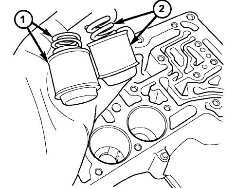

The springs in wrong could cause problems like you have, as the pressures could be wrong. There should be a parts breakdown showing the springs like the attached.
May 18, 2022 at 2:30 PM
DINA RODGERS
  • 30 POSTS
That is beautiful! And it is the first I have seen of it. Looking at this breakdown, I see the springs in question, but alas, one of mine has 2 springs, I believe it is the underdrive accum. Also, this is what was happening after the solenoid change but, before the valve body change. I deduced the spring w/small spring belongs to the underdrive by faint markings on the plate. I put it closest to the front of the car. I am sure it is possible that I could recreate the symptoms if I was mistaken. But that would not tell me how the first symptoms arrived. Oh, and generic code p0700 pending, and freezeframe shows P0736 though there might be more, but I am not sure when the codes will set especially since the car is back to not moving again. I will do my wires first thing tomorrow. I am trying not to overthink this. And while I know this, for now, is way beyond me, I figure I've little to lose because if I don't try the car will just sit in my driveway looking pretty until it doesn't anymore. Honestly, I dig the challenge but, certainly welcome and appreciate the help. And did I mention your patience?
May 18, 2022 at 6:14 PM
STEVE W.
  • 15,351 POSTS
The 2-4 accumulator has 2 springs as does the low reverse. The under and overdrives should have a single spring. However, the springs are also different strengths depending on location. These might help a bit.
https://at-manuals.com/wp-content/uploads/2016/manuals/A604_Rebuild_Procedures%20repair.pdf
https://at-manuals.com/wp-content/uploads/2016/manuals/A60440TE%20CAtalog.pdf
May 18, 2022 at 8:00 PM
DINA RODGERS
  • 30 POSTS
When I removed the valve body two pistons came tumbling out as well as two springs and one of those had a smaller spring inside it. I never touched the low/reverse accumulator because as you know, it isn't part of that removable valve body. I am so confused right now! I am thinking I need to go back in there and see what the heck is going on! Do you concur? There is a sticker on my transmission that says something like proudly remade in the USA. Do you think it is a rebuild and they messed it up and that is why the sticker doesn't say proudly remade correctly in the USA? Could a mistake like that cause all of these problems starting with the p0882? Or am I getting all worked up over nothing? Or (And let this be the right or!), might you have diagnosed my car without laying a hand or eye on it? I sure could use a reason to celebrate!
May 18, 2022 at 10:02 PM
